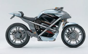

All the way back in 2007, Suzuki showed its Crosscage concept, which proposed hydrogen power. <i>Suzuki</i>
Suzuki has flirted with hydrogen fuel cells since 2007 when it showed the Crosscage concept bike. Around the same time, it tied in with British company Intelligent Energy, which developed the fuel-cell system used in all the prototypes that followed. Fuel cells promise the clean-running benefits of electric power but with the ability to rapidly refuel hydrogen tanks rather than needing to recharge batteries. However, earlier this year Suzuki became a member of the HySE collaboration—alongside Honda, Yamaha, and Kawasaki—to develop hydrogen-fueled combustion engines for small vehicles, including motorcycles. Specifically, Suzuki’s role in the organization is “Element study on functionality, performance, and reliability of hydrogen-powered engines.” That’s where the new Burgman prototype comes in.

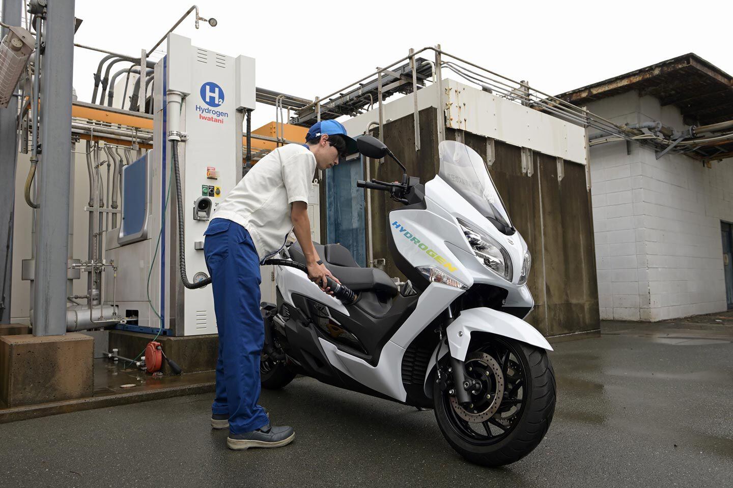

The argument for hydrogen is that it can be easily refilled unlike the wait time required to charge an EV.
The argument for hydrogen is that it can be easily refilled unlike the wait time required to charge an EV. (Suzuki/)

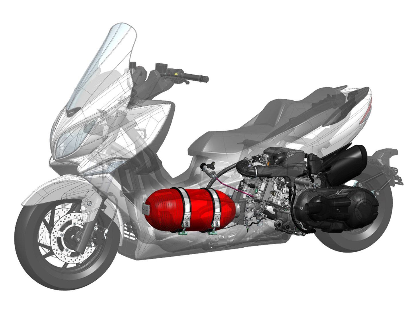

It’s built around a standard Burgman 400 scooter, although the engine needs some substantial modifications to run on hydrogen instead of gasoline. Details of those changes aren’t known now, but they’re likely to include direct fuel injection. The hydrogen itself is stored at 700 bar (around 10,000 psi) in a tank between the rider’s feet, fueled from a socket just below the right-hand side of the seat.
To make space for that tank, the swingarm and engine, which are a single unit, are moved backward by around 8 inches, giving the prototype its unusually long wheelbase. On the positive side, the bike doesn’t lose its underseat storage space, like the fuel-cell prototypes did.
