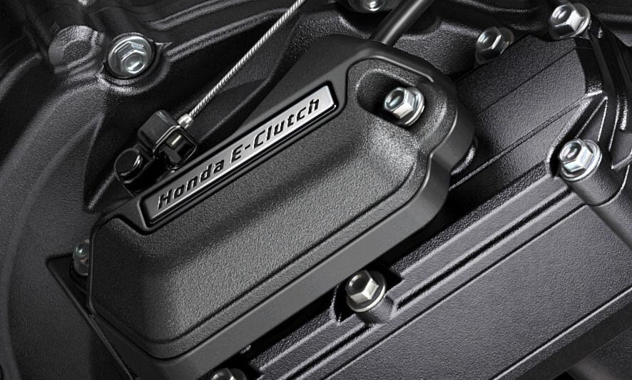

A close inspection of the photos and video released with the announcement reveals that the bike used for those pictures and footage is an updated CB650R. The casting shapes and bolt pattern around the clutch cover is a giveaway, and the standard frame of the current CB650R is also visible in some shots. Bar-mounted mirrors show it isn’t the CBR650R, but the same images also show new control pods on the bars and a full-color TFT dash that aren’t present on the current CB650R, confirming there are other updates coming as well as the E-Clutch.
The external view of the clutch cover with the E-Clutch mechanisms underneath.
The external view of the clutch cover with the E-Clutch mechanisms underneath. (Honda/)
However, the patents filed around the system reveal that it would be simple to fit the E-Clutch to any bike with a conventional cable or hydraulic clutch, all without any major changes apart from a new clutch cover to hold the E-Clutch system, plus an ECU to interface with the bike’s other electronics.

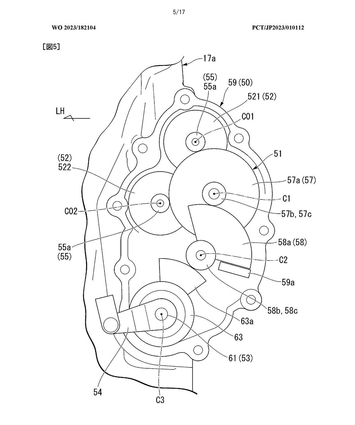

This illustration shows how the reduction and sector gears are laid out.
This illustration shows how the reduction and sector gears are laid out. (Honda/)
Mechanically, the E-Clutch uses two electric motors geared together onto a set of reduction gears, all mounted in a pod attached to the clutch cover. Two motors appear to be used instead of one simply to keep the unit slim, so it doesn’t protrude too far from the cover on the side of the engine. The reduction gears are connected to sector gears that, in turn, act on the same clutch release shaft that the conventional, bar-mounted clutch lever is connected to (by a cable, in the case of the CB650R). The final sector gear acts on the release shaft via a cam that allows the manual clutch lever on the bar to override the electronic system. So when the electronics are turned off, the clutch operates as a conventional unit.

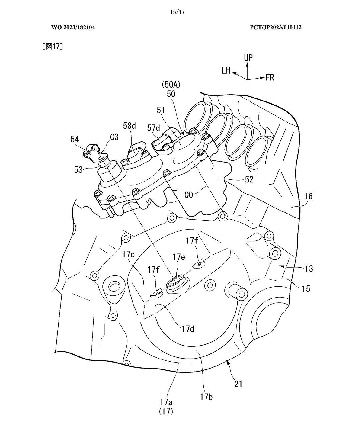

Here you can see how the unit bolts onto the clutch cover.
Here you can see how the unit bolts onto the clutch cover. (Honda/)

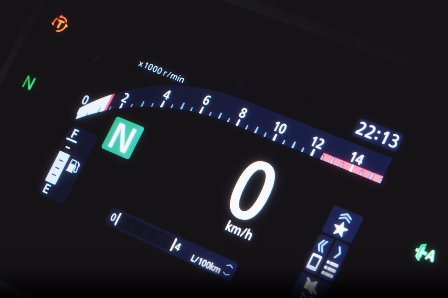

We believe that the symbol on the lower right shows that the E-Clutch is in its automated mode.
We believe that the symbol on the lower right shows that the E-Clutch is in its automated mode. (Honda/)
