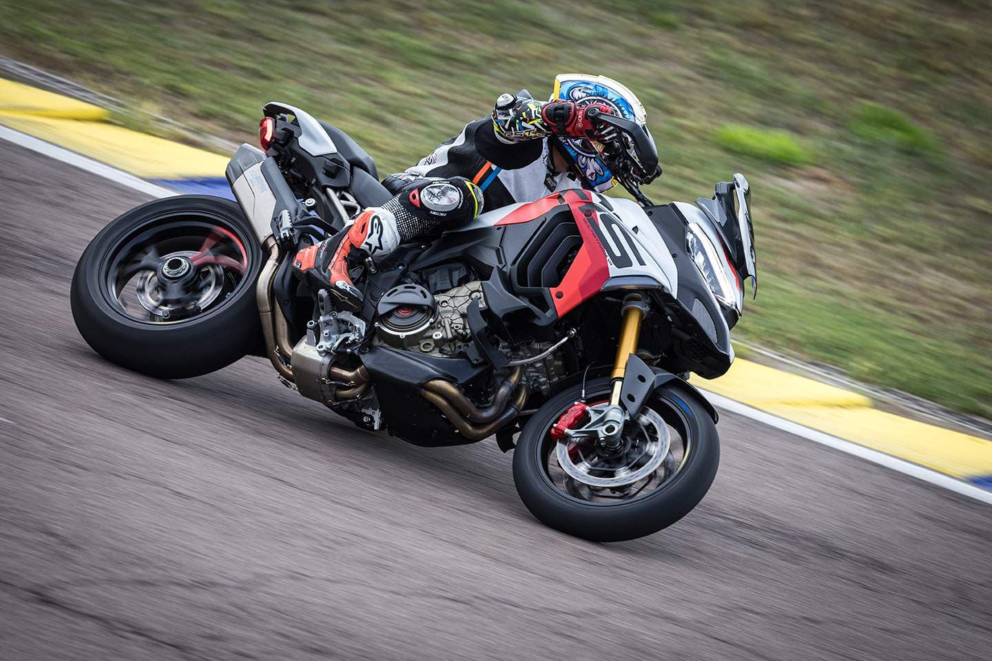

Our Multistrada V4 RS test unit was equipped with Pirelli slicks for a day at the track.
Our Multistrada V4 RS test unit was equipped with Pirelli slicks for a day at the track. (Ducati/)
Right now, forget the Multistrada as a machine to waft you and your partner across swaths of the country without fuss or drama, because this Multistrada is essentially a Panigale V4 S superbike on stilts. A long-range troublemaker looking to rip it up on track and road alike. Fuss and drama are what it’s all about.

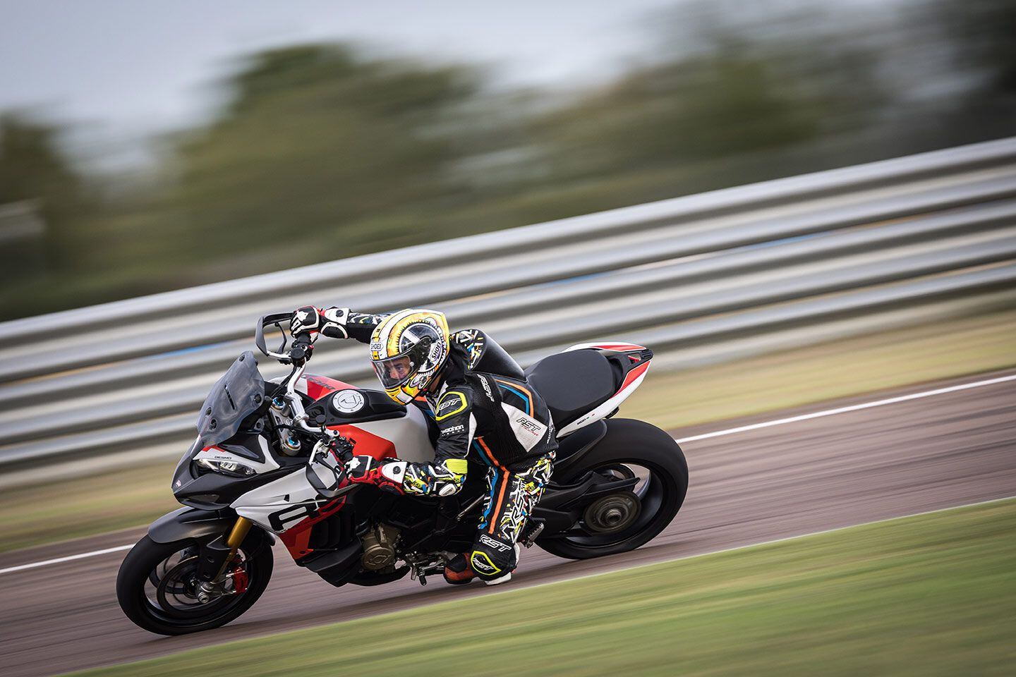

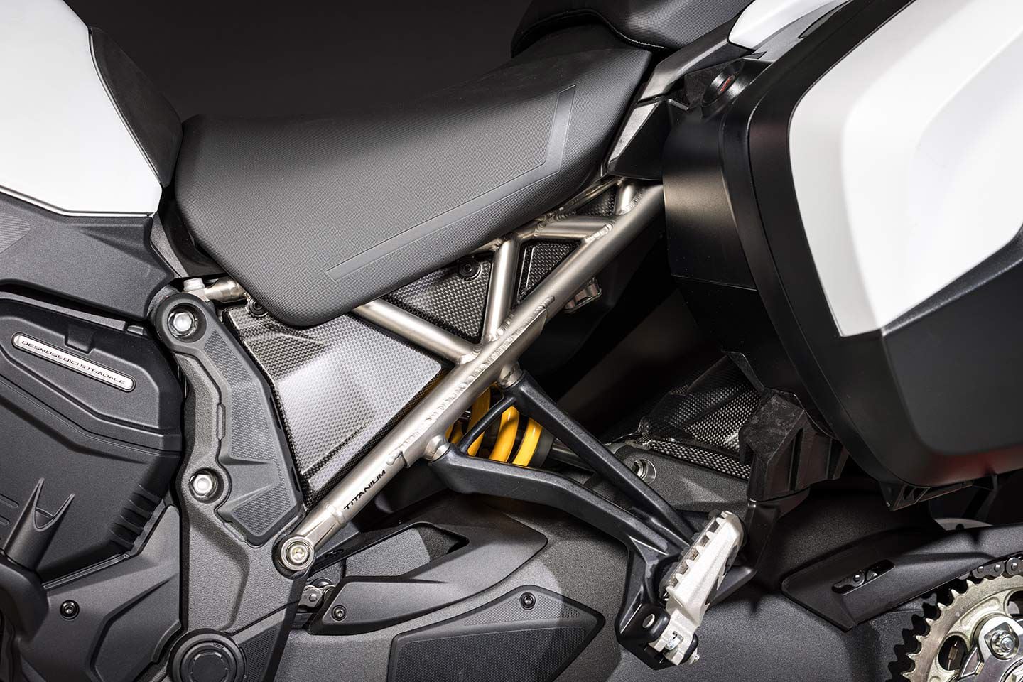

Bags can be attached to the Multi V4 RS’ titanium subframe.
Bags can be attached to the Multi V4 RS’ titanium subframe. (Ducati/)
The contradictions and oxymorons are compelling. “Trackday tourers” that do it all have been tried before. Priced close to $38K, which is $6,000 above the Pikes Peak ($31,595), and billed by Ducati as uncompromising and the most exciting Multistrada yet seen, the pressure is certainly on the RS to deliver in an array of riding environments.

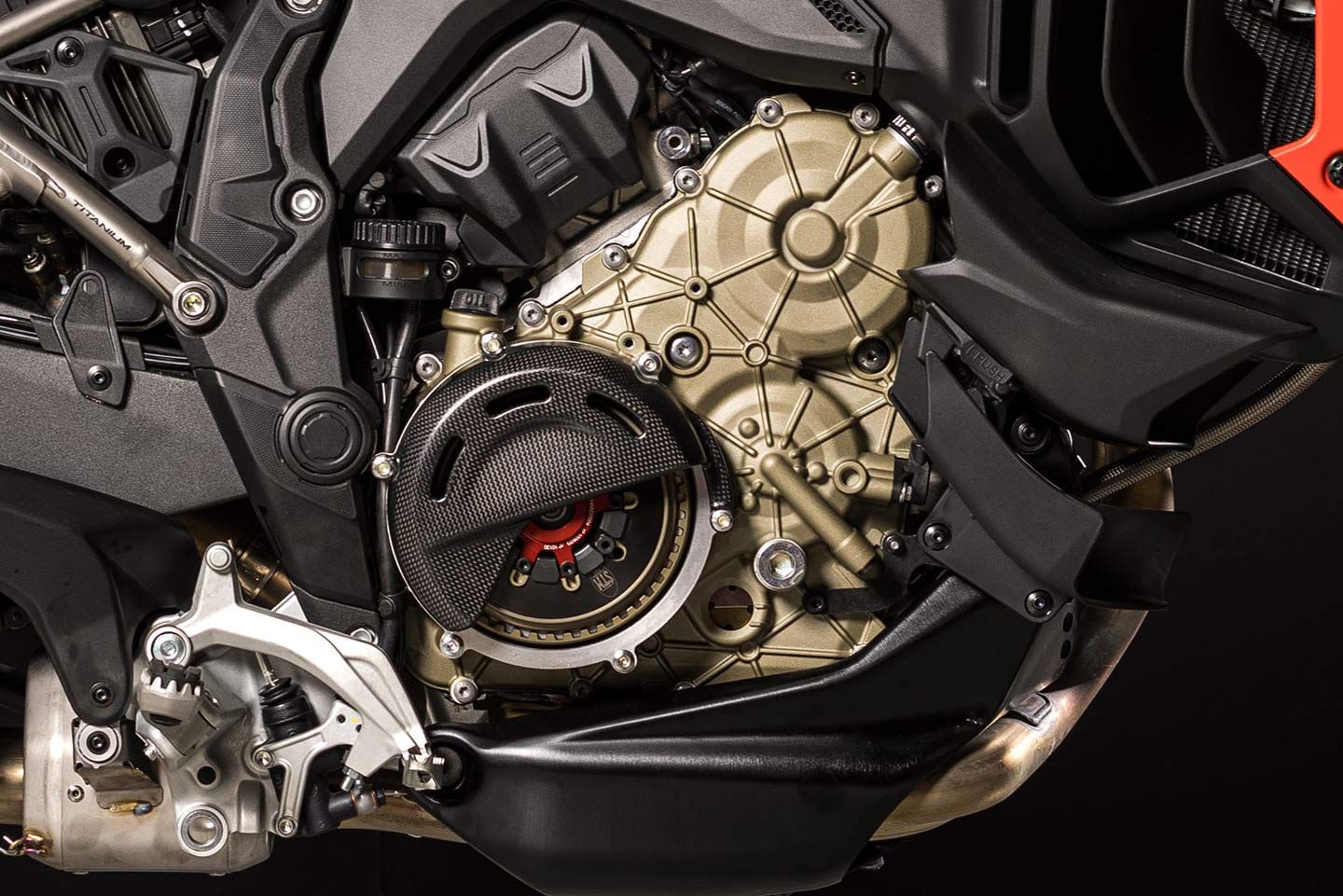

In a bike full of surprises, the move to a Panigale-derived Desmosedici Stradale V-4 is perhaps the biggest of them all. The non-desmo 1,158cc Granturismo engine it replaces makes 170 hp at 10,500 rpm and 92 lb.-ft. of torque at 8,750 rpm and is hardly a shrinking violet. It’s smooth at low rpm too, and features extra wide service intervals, including a 36,000-mile valve check, ideally suiting the Multistrada’s high-mileage adventure motorcycle profile.
A Desmosedici Stradale V-4 powers the Multistrada V4 RS, replacing the standard Granturismo.
A Desmosedici Stradale V-4 powers the Multistrada V4 RS, replacing the standard Granturismo. (Ducati/)
The angrier, heat-churning Stradale, meanwhile, retains Ducati’s signature desmo valve system and conventional service intervals. It revs higher to peak at 180 hp at 12,250 rpm (don’t forget that 192 hp with the full Akrapovič system) while peak torque is a claimed 87 lb.-ft. at 9,500 rpm, a chunk less than the Granturismo’s 92. On this tight and twisty racetrack, you instinctively rev it hard—the frictionless Stradale V-4 demands it—shifting from second gear to third and fourth, then fifth gear on the straight when the shift lights illuminate.
This is true racebike territory. The digital rev counter builds as the V-4 revs with liquid fury. There’s really no such thing as a slow Multistrada but when the V4 S is peaking at 10,00 rpm, the new RS is still revving toward maximum power at 12,250 rpm and will happily continue into 13,000 rpm.
On paper, torque is down compared to the “normal” Multi, but on track, and using just the upper 25 percent of the rev range, you don’t miss the comparative lack of grunt. Out of Modena’s final turn, with the anti-wheelie on a low setting, the front wheel hovers above the surface as the power kicks and shovels down the main straight.

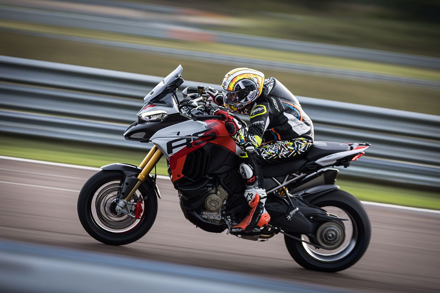

Another significant change from Multistrada convention is the introduction of a 17-inch front wheel to replace the 19-inch front on the standard Multi, the Pikes Peak being the other exception. These Marchesini rims are a sizable 6 pounds lighter, which quickens the steering and saves on unsprung weight and opens up the options for track-focused rubber. Pirelli Diablo Rosso IV Corsa are the OE fitment but our testbike wore Pirelli slicks.
Steering is quick and feedback is excellent with 17-inch wheels and revised chassis geometry on the Multistrada V4 RS.
Steering is quick and feedback is excellent with 17-inch wheels and revised chassis geometry on the Multistrada V4 RS. (Ducati/)
Ducati isn’t yet revealing the RS’ overall weight, but the introduction of that titanium subframe saves another 5.5 pounds. A lighter battery shaves off another 3.1 pounds, and with the optional race exhaust installed the estimated final figure could be close to 452 pounds, which would make the RS just 55 pounds heavier than the Streetfighter V4 S.
The premium Multistrada V4 S and new Grand Tour both use the familiar Skyhook Marzocchi semi-active suspension, whereas the new RS uses Öhlins Smart EC 2.0 units similar to the Panigale V4 S, Streetfighter V4 S, and Pikes Peak. Long-travel, semi-active suspension is ideal for long-distance performance, but less so for the racetrack and could be seen as a red flag to sporty riders but the feel and feedback from the Öhlins units are exquisite. The RS instilled so much confidence that soon the traction control was turned down to the minimum and the anti-wheelie was turned off altogether. You can feel the limit approaching as if riding a crisply set-up sportbike.

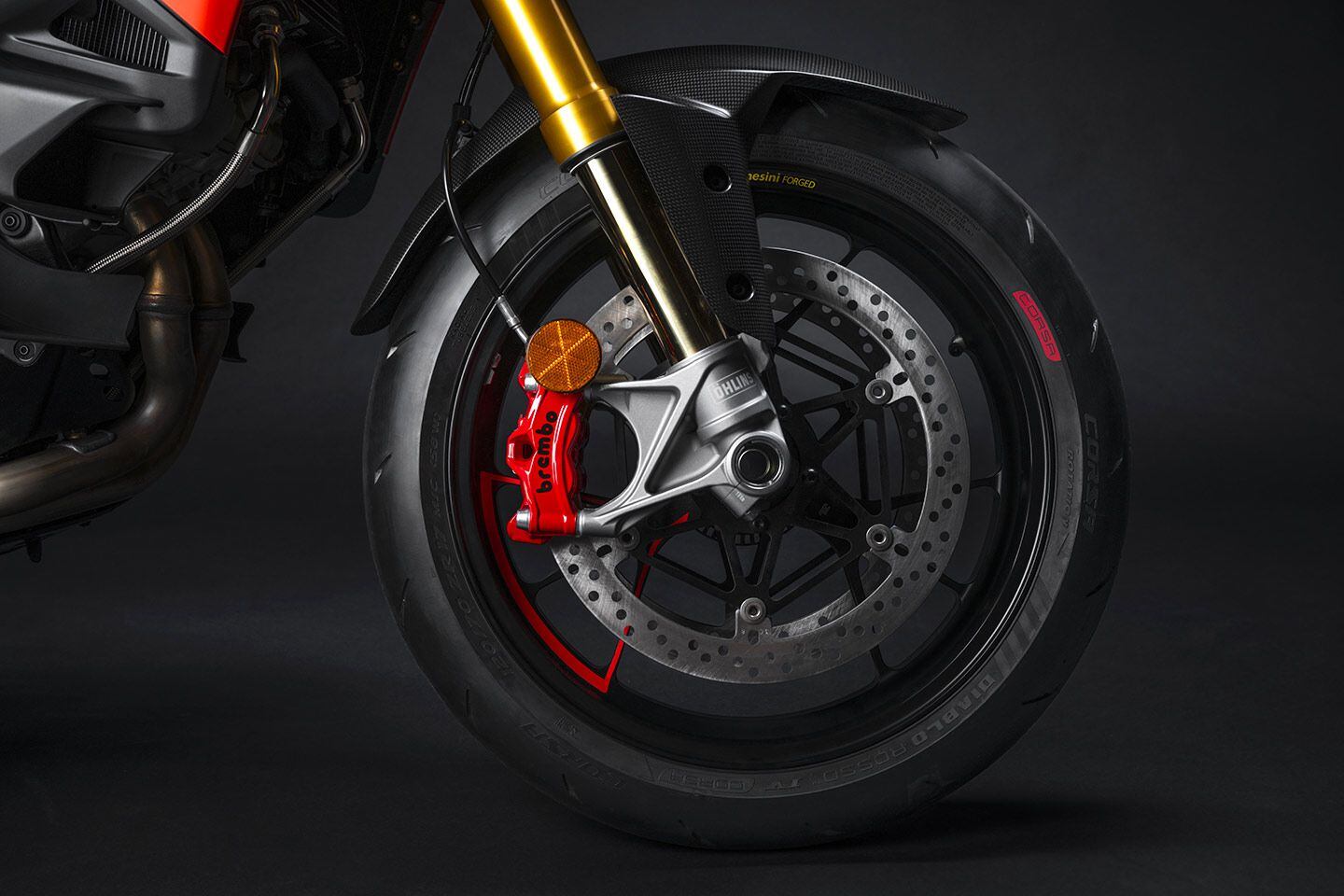

Braking is by Brembo: Stylema monoblock calipers and 330mm discs up front with a radial master cylinder and corning ABS. These race-spec stoppers are the same as you’d find on the Multistrada V4 S and Pikes Peak, but now they are stopping less weight. On the track, they are fade-free and faultless, and the high riding position and upright stance results in excellent stability. The cornering ABS is superb; even at a solid trackday pace, it’s not intrusive and can be relied upon.
Brembo Stylema calipers and 330mm discs are shared with the S and Pikes Peak Multis, and are more than capable for fade-free trackday shredding.
Brembo Stylema calipers and 330mm discs are shared with the S and Pikes Peak Multis, and are more than capable for fade-free trackday shredding. (Ducati/)
Ducati has added a more progressive rear brake lever—something it did on the Multistrada Rally—and changed the rear master cylinder to make it brake sharper and more usable. Because the RS runs a similar engine to the Panigale and Streetfighter, this allows the introduction of a three-stage Engine Brake Control, which allows you to control the amount of engine-braking from the V-4 and is a first for the Multistrada range.

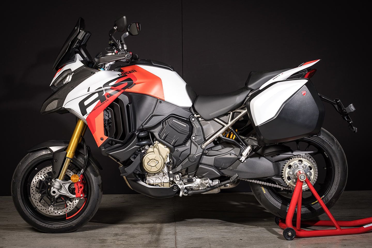

Slap some bags on the Multistrada V4 RS and hit the road for your favorite track.
Slap some bags on the Multistrada V4 RS and hit the road for your favorite track. (Ducati/)
Other touches worth noting are a new heat shield, closable air deflectors, and an air-cooled phone compartment, all of which were first seen on the Multi Rally.
Having sampled the RS on a race circuit we are eager to try it on the road to see if its distance work can match its mind-bending speed and incredible feel on track. A 180 hp, free-revving beast of a V-4 in a chassis that possesses many of the qualities of the excellent Streetfighter and Panigale, mixed with the all-round versatility of the Multistrada, makes for an intoxicating blend that ticks all boxes.
