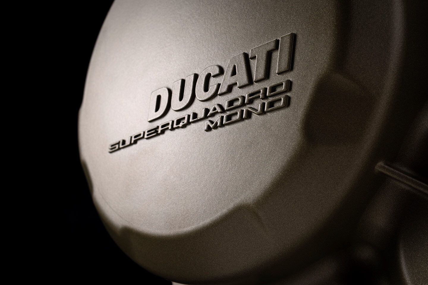

Side covers are magnesium.
Side covers are magnesium. (Ducati/)
