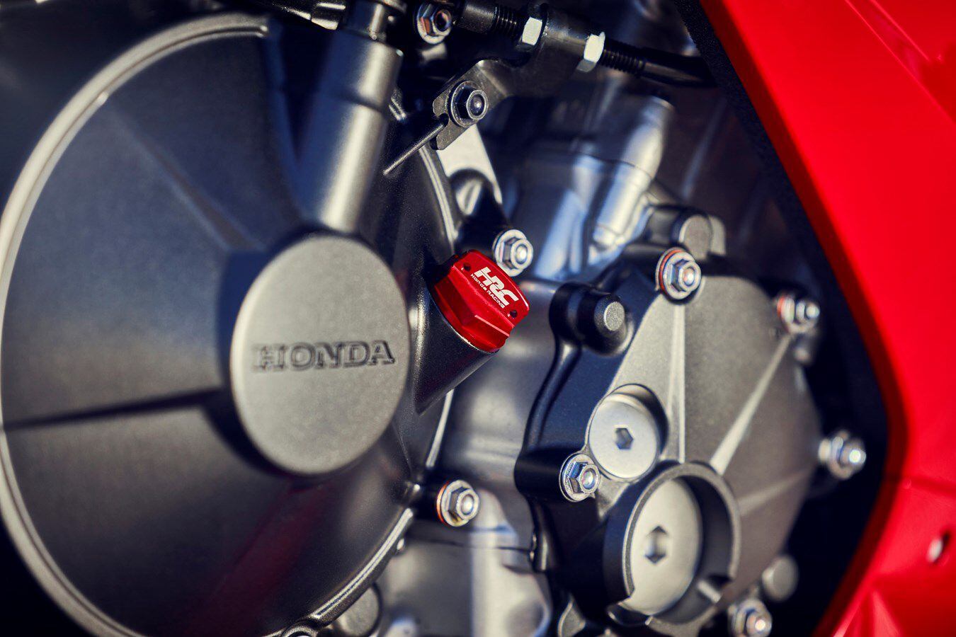

The engine, for instance, gets a new cylinder head with more compression, up from an already-high 13.4:1 to 13.6:1, as well as revised camshafts with different duration and lift, new valve springs, and revised ports. Deeper in the motor, the crankshaft pin and journal diameters are changed, saving a remarkable pound of inertial mass. The connecting rods are lighter too, and another 0.55 pound has been removed from the crankcases.
The SP’s engine gets a bunch of updates including a higher compression ratio, revised cams and valvetrain, updated crankshaft and rods.
The SP’s engine gets a bunch of updates including a higher compression ratio, revised cams and valvetrain, updated crankshaft and rods. (Honda/)
The intake system is completely new, with a twin-motor throttle-by-wire system that controls the cylinders in two pairs. Cylinders one and two are controlled by one throttle motor, cylinders three and four by the other, allowing their throttles to be opened and closed separately to give improved response and to add an extra layer of engine-braking control. The nine-level traction control system has also been tweaked for 2024.
In performance terms, the engine’s peak power remains at claimed 215 crankshaft horsepower, but it arrives slightly lower in the rev range at 14,000 rpm, while peak torque of 83.3 lb.-ft. comes at 12,000 rpm.

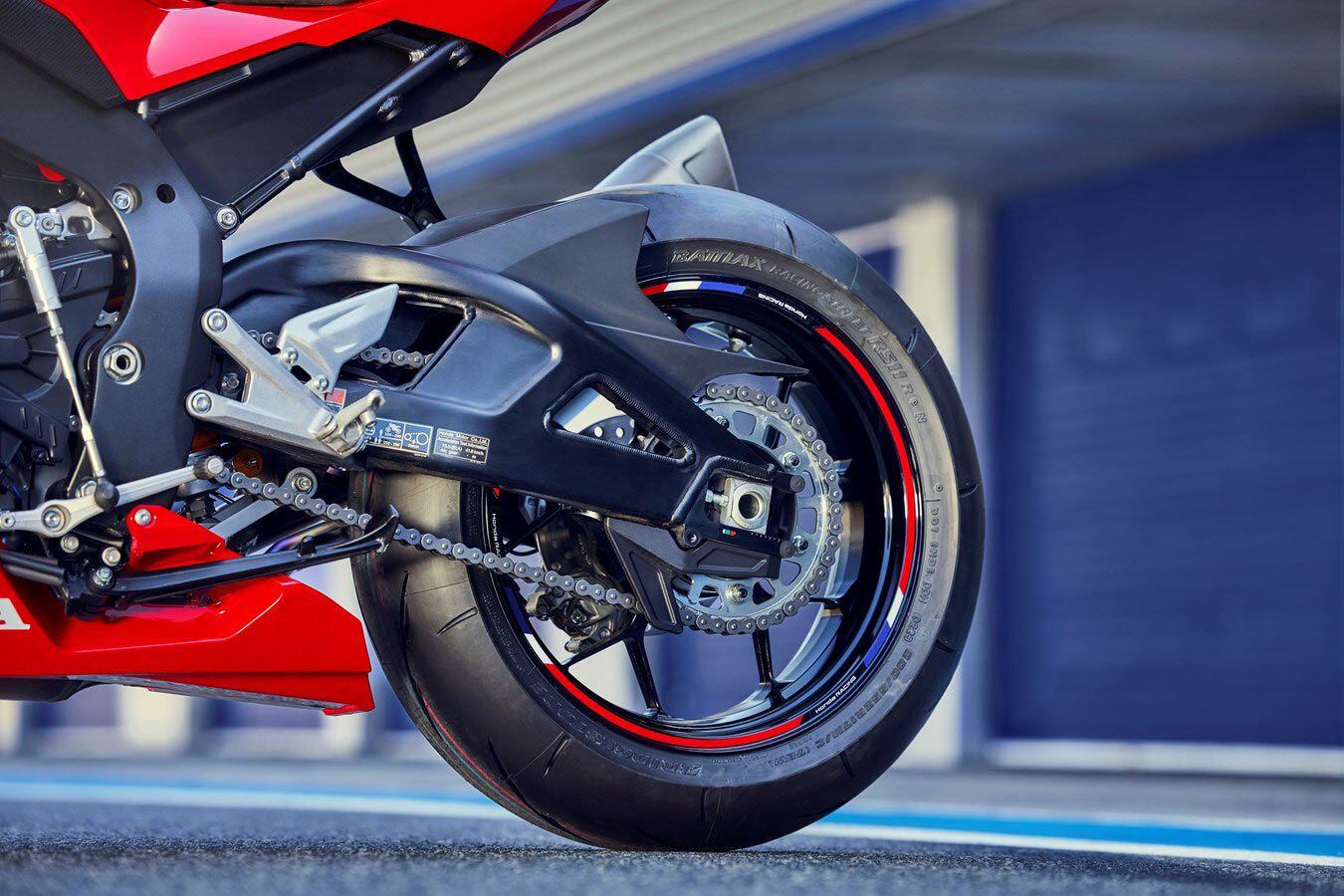

The frame might look the same as the current model, but its weight and rigidity are tweaked. There’s less internal ribbing and the thin-wall section of the frame has grown for 2024, cutting its weight by 2.1 pounds. The weight loss is secondary, though, to the increased lateral and torsional flexibility that the changes bring, intended to give a more supple feel. There are riding position changes too, with higher bars and lower pegs than before to give more space and control.

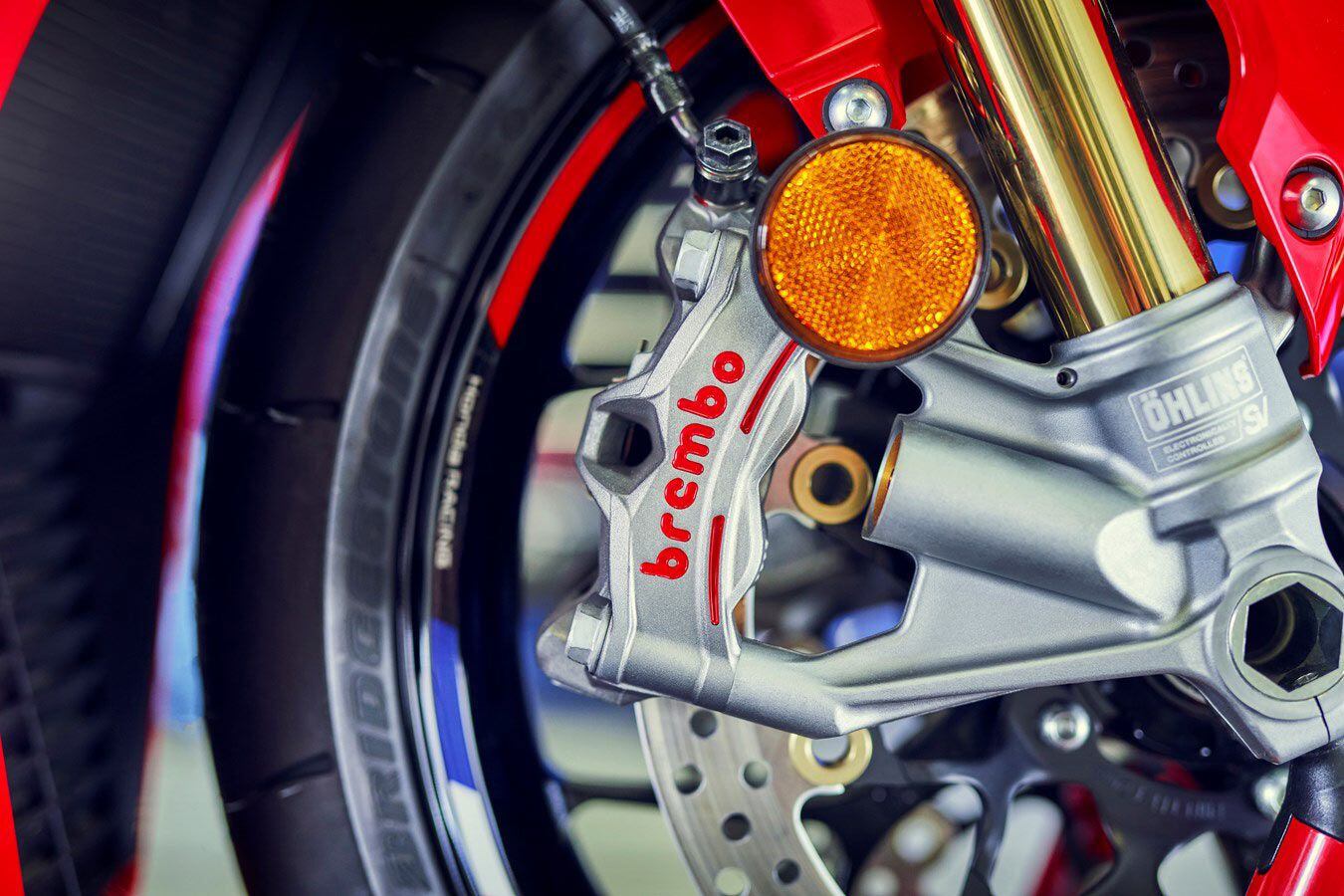

The 2024 SP gets the latest Brembo Stylema R calipers.
The 2024 SP gets the latest Brembo Stylema R calipers. (Honda/)

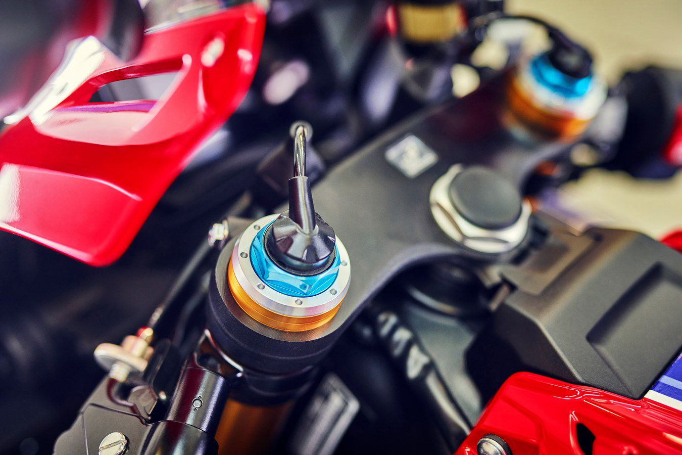

As in the past, the SP model has Öhlins electronic suspension, and for 2024 it’s upgraded to the third-generation S-EC3.0 on the 43mm Öhlins NPX fork and TTX 36 shock. The brakes are also improved, gaining the latest Brembo Stylema R calipers.
Third-gen Öhlins S-EC3.0 electronic suspension is used.
Third-gen Öhlins S-EC3.0 electronic suspension is used. (Honda/)

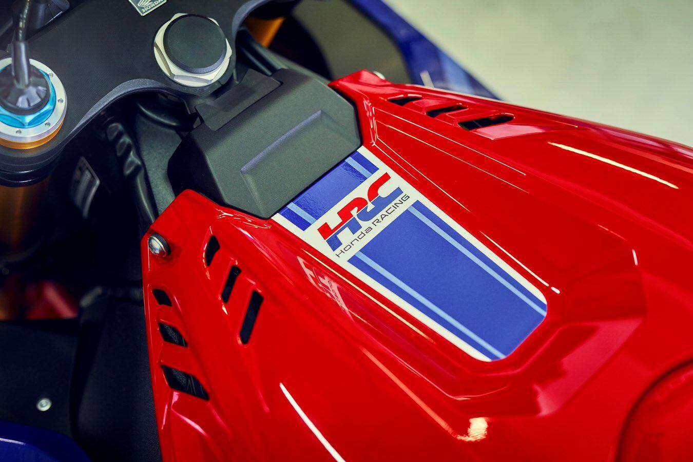

Although the winglets are the most visible change, there are other bodywork alterations as well. The fuel tank is bigger than before at 4.4 gallons, but it’s also reshaped to give more space when you’re tucked in and to improve knee grip on the sides.
The fuel tank has been altered to allow the rider to get tucked in more.
The fuel tank has been altered to allow the rider to get tucked in more. (Honda/)

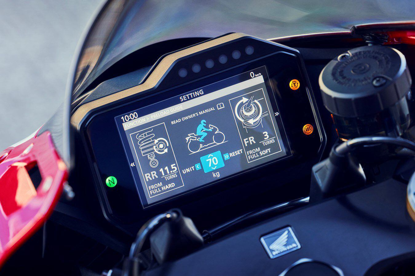

The 2024 CBR1000RR-R SP is available in a Carbon Edition in Europe with c-f bodywork shaving an additional 2.2 pounds off the bike’s weight. (Honda/)A closer look at the CBR’s TFT display.
A closer look at the CBR’s TFT display. (Honda/)The CBR gets an updated frame and chassis for 2024.

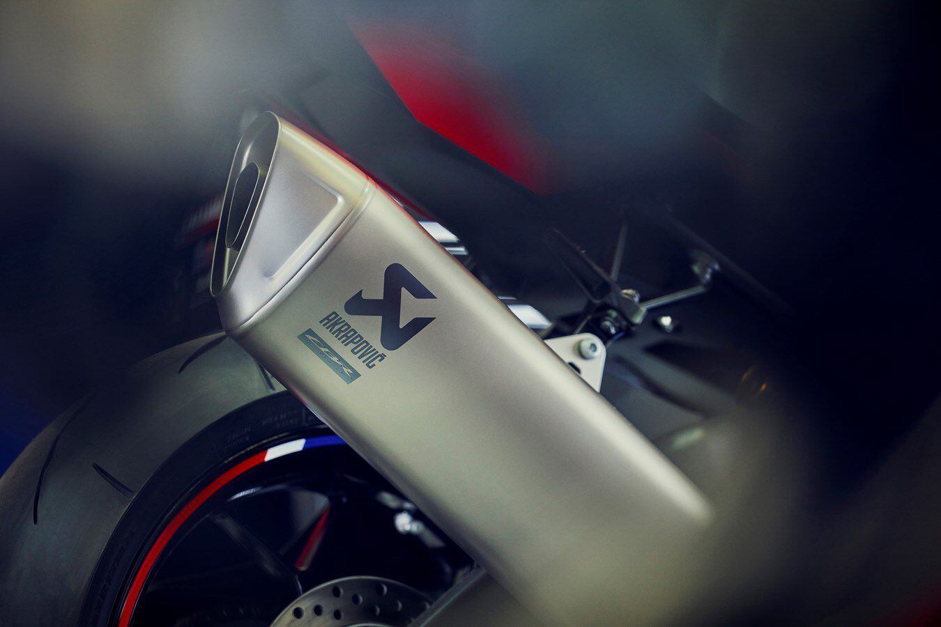

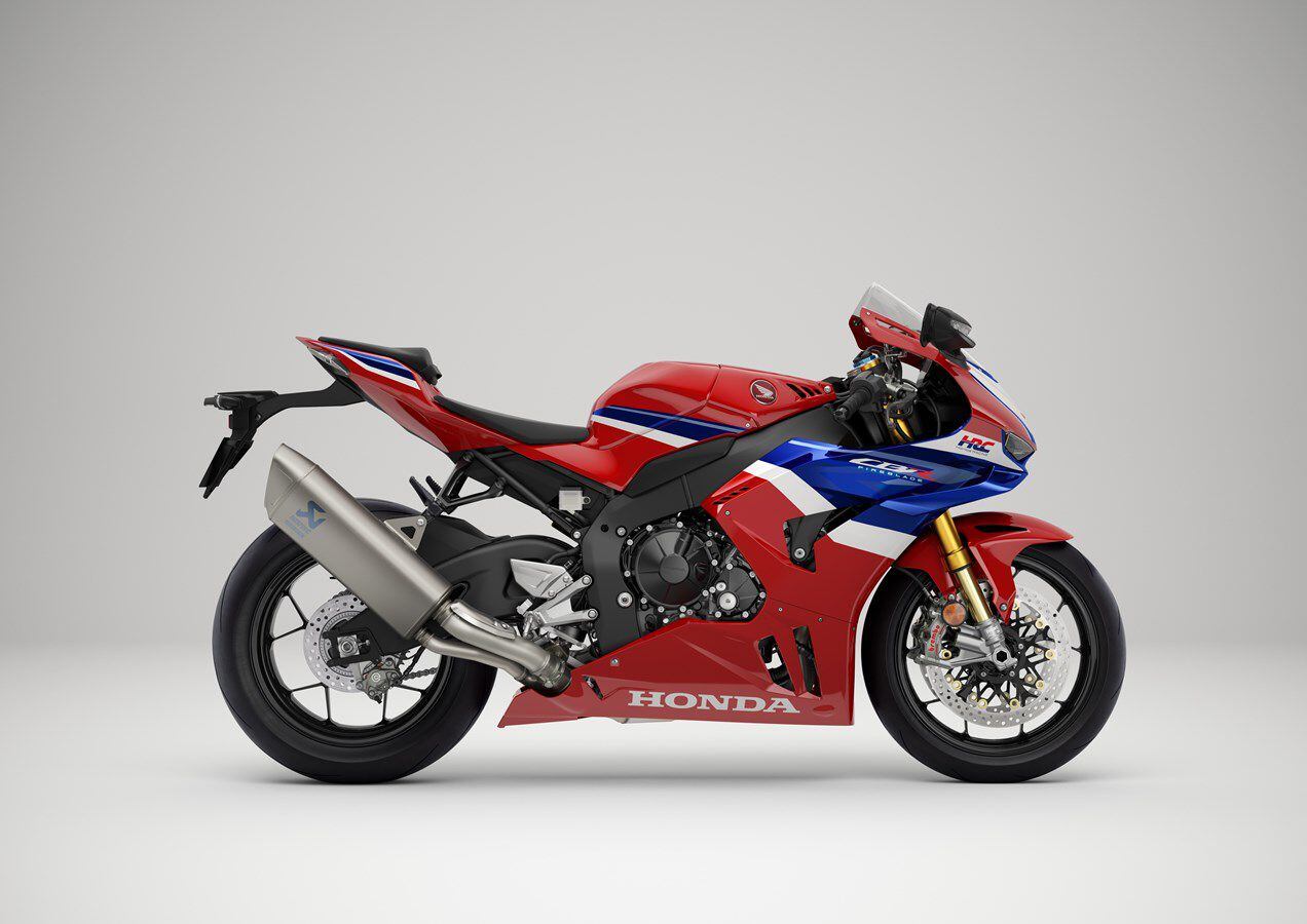

The CBR gets an updated frame and chassis for 2024. (Honda/)A closer look at the Akrapovič exhaust silencer.

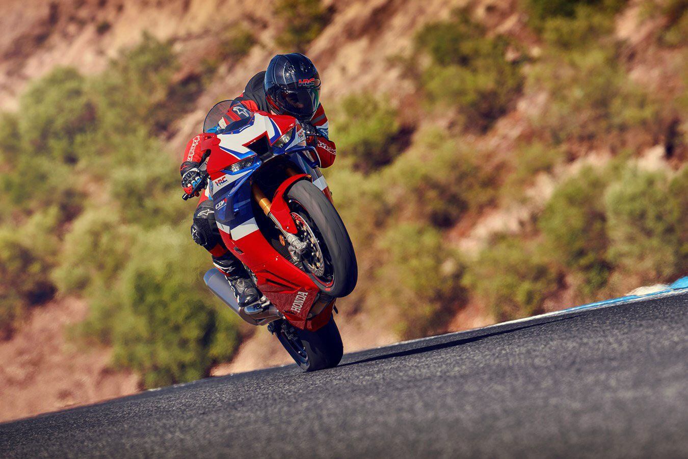

A closer look at the Akrapovič exhaust silencer. (Honda/)2024 Honda CBR1000RR-R SP wheelie action.
2024 Honda CBR1000RR-R SP wheelie action. (Honda/)
