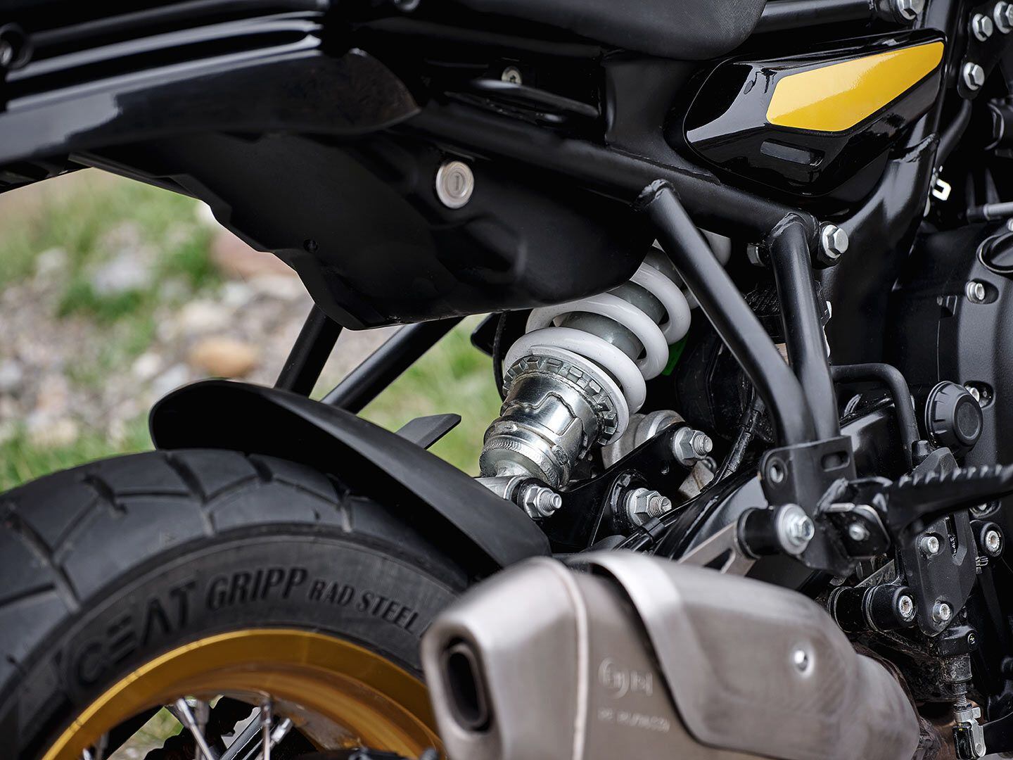

That engine hangs beneath a newly designed, steel twin-spar frame in place of the old bike’s half-duplex, split-cradle design, with much more modern suspension at either end. Up front, an upside-down 43mm Showa fork replaces the earlier bike’s skinny, 41mm right-way-up version, and at the back there’s a curved alloy swingarm that’s connected to a Showa monoshock via a rising-rate linkage. It’s a design that more than offsets the extra mass of the liquid-cooled engine and radiator, bringing the bike’s total curb weight down from 439 pounds to 432 pounds, including a 90 percent full tank of fuel. It’s a bigger fuel tank too, up from 4 gallons on the original Himalayan to 4.5 gallons on the 2024 model.
Showa suspension at each end offers 7.9 inches of travel with a 21-inch front wheel/tire combo and a 17-inch rear.
Showa suspension at each end offers 7.9 inches of travel with a 21-inch front wheel/tire combo and a 17-inch rear. (Royal Enfield/)
The suspension offers 7.9 inches of travel at each end, and the bike’s off-road ability is bolstered by wire-spoked wheels wearing 90/90-21 rubber at the front and a 140/80-17 at the rear (with tubeless versions an option). Even the brakes are substantially improved, with a single 320mm front disc and ByBre dual-piston caliper and single-pot rear stopper on a 270mm rotor, with switchable ABS.

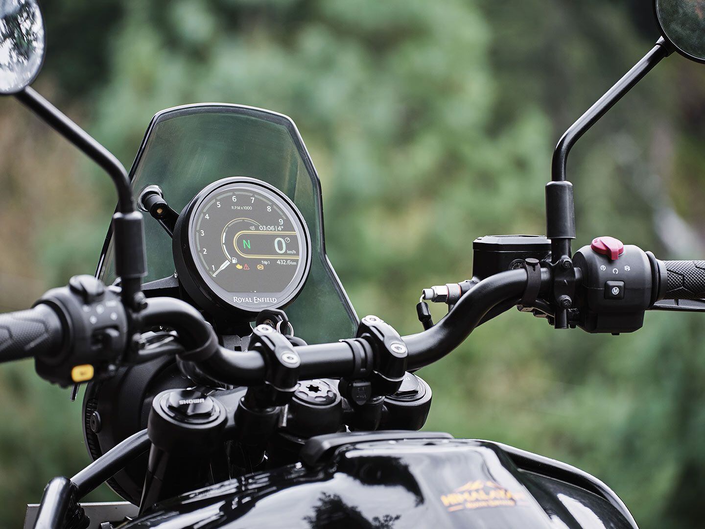

The Tripper TFT display is full color and offers smartphone connectivity, Google-powered navigation, and the interface for changing modes and settings.
The Tripper TFT display is full color and offers smartphone connectivity, Google-powered navigation, and the interface for changing modes and settings. (Royal Enfield/)
From the rider’s seat, the view ahead features a simple, circular display that’s really a full-color TFT that even incorporates phone connectivity and Google map-based navigation—more useful away from the beaten track than the turn-by-turn nav that’s more commonly found on smartphone-connected instruments. The modern tech continues with the LED headlight and joystick-controlled riding modes.

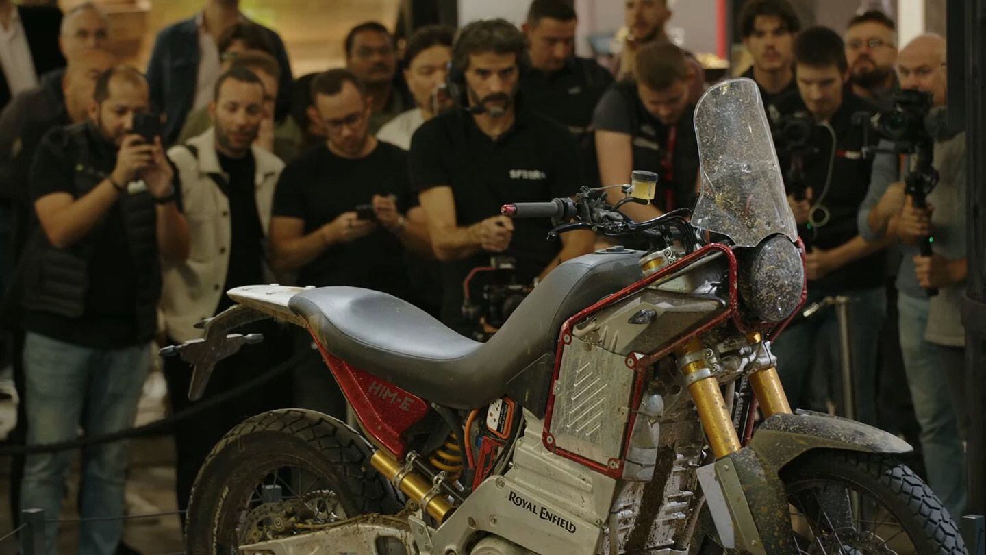

Royal Enfield also showed off its working prototype of its electric Himalayan at EICMA.
Royal Enfield also showed off its working prototype of its electric Himalayan at EICMA. (Royal Enfield/)
Royal Enfield also unveiled a prototype electric version of the Himalayan at EICMA in Milan, alongside the new production model. Although still a test bed rather than a production-intended model, it’s a running machine that’s already undergoing further development as Enfield eyes a battery-powered future.
