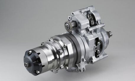

Honda’s hydrostatic drive automatic DN-01, during its 2009–2010 importation to the US, was touted as an ideal beginner’s bike because its continuously variable hydrostatic drive provided three “human-friendly” modes of basic twist-and-go riding. The modes were Drive, Sport, and Manual. “Drive” provided basic automatic functionality, “Sport” could on demand hold engine rpm constant at peak power to maximize acceleration, and “Manual” restored foot-shifting through a computer-simulated six speeds, causing engine note to rise and fall in traditional fashion.
Honda’s DN-01 used a continuously variable hydrostatic drive. <i>Honda</i>

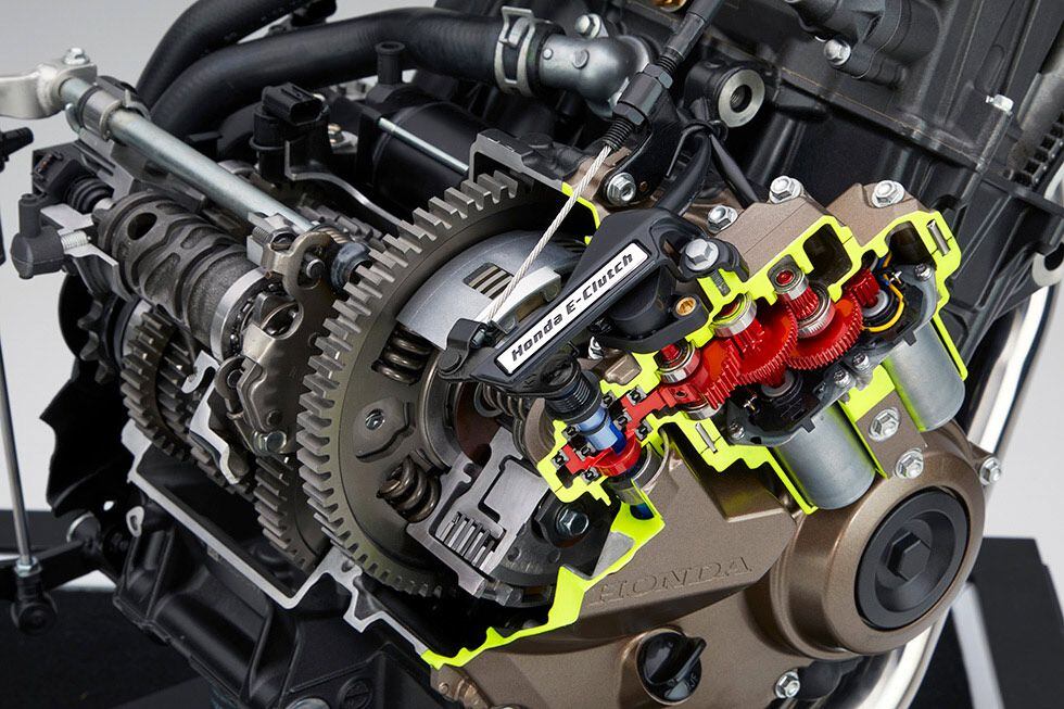

Honda’s latest effort in this direction is called “E-Clutch.” First of all, it is switchable: If the rider prefers to clutch and shift conventionally, E-Clutch can be switched off. But if E-Clutch is on, all the rider has to do is operate the shift lever and throttle, even when accelerating from rest or coming to a stop. This is accomplished by automating the operation of a conventional clutch. With the engine running, click the shift pedal into first. E-Clutch makes this possible by first disengaging the clutch, then engaging first gear. Turn the throttle and E-Clutch makes a smooth, no-stall engagement and away you go. Time for second gear? Click the lever to second and again, E-Clutch allows this by disengaging, shifting to second, and reengaging the clutch with all the skill of a seasoned rider. Same with downshifts.
Honda’s E-Clutch automates the operation of the clutch. The rider can change the function from automatic to manual with a press of a button.
Honda’s E-Clutch automates the operation of the clutch. The rider can change the function from automatic to manual with a press of a button. (Honda/)
This allows the rider to continue to control “the music”—the dynamic rise and fall in engine note as the rider shifts up and down through the gears, but without having to manage the clutch.

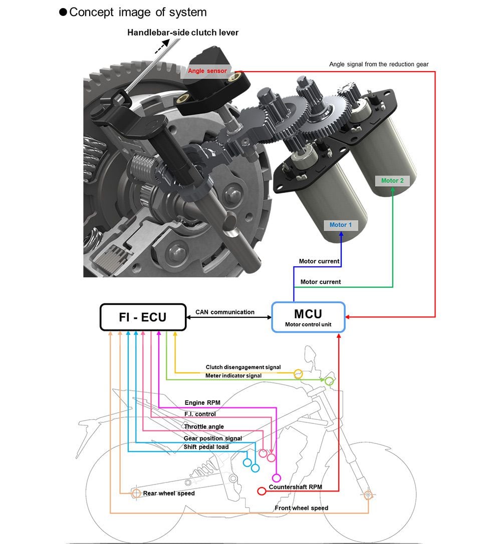

To quote from Honda’s European Media Newsroom, “The Honda E-Clutch manages clutch engagement and disengagement based on its reading of parameters including vehicle speed, throttle opening angle, engine rpm, pressure on the shift pedal, clutch motor reduction gear angle, engine countershaft speed, and gear position. The clutch is operated through an actuator unit with two motors situated inside the right-hand engine cover. As the clutch is engaged or disengaged, the engine’s ignition timing and fuel injection are also controlled, resulting in smooth, shock-free shifting in any situation.”
Using data from multiple parameters, Honda’s E-Clutch automatically manages the engagement and disengagement of a traditional wet, multiplate clutch.
Using data from multiple parameters, Honda’s E-Clutch automatically manages the engagement and disengagement of a traditional wet, multiplate clutch. (Honda/)
Aside from its computer logic and control software, E-Clutch consists of two small electric motors driving a gear train that rotates a sector gear controlling clutch engagement. Total weight is cited as 4 pounds, 6 ounces.
