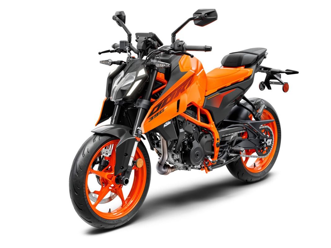

The 2024 KTM 390 Duke.
The 2024 KTM 390 Duke. (KTM/)

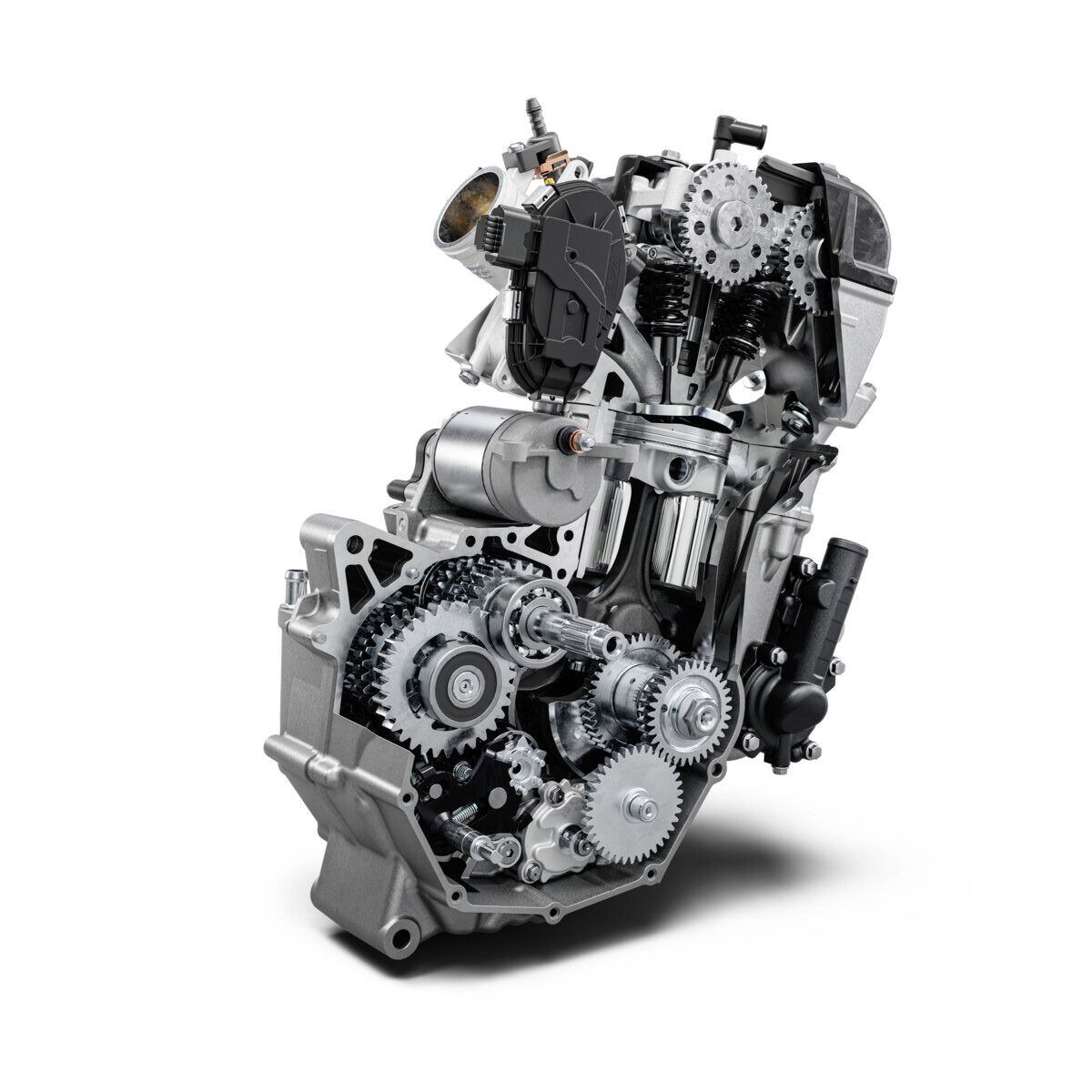

For 2024, KTM is pulling out all the stops with its single-cylinder Duke lineup, bringing what it calls the biggest change to the model range since the 390 Duke’s introduction. Accordingly, both the 390 Duke and 250 Duke receive new engines, debut new chassis concepts, and move the entry-level game forward with revamped styling and electronics.
KTM says the single-cylinder LC4c platform has been redesigned. Details are scant, but the Austrian company says that both engines have “newly optimized cylinder heads and gearboxes.” The Duke 390′s engine uses a longer 64mm stroke to bring displacement up to 399cc (up from 373cc). KTM claims it produces 44 hp and 28.8 lb.-ft. of torque. The 250 Duke’s LC4c moves from DOHC to SOHC, reducing the components count and improving the power-to-weight ratio. Both engines use PASC slipper clutches, ride-by-wire throttles, and can be spec’d with quickshifters.
The 2024 KTM 390 Duke’s LC4c single has an updated gearbox and top end.
The 2024 KTM 390 Duke’s LC4c single has an updated gearbox and top end. (KTM/)

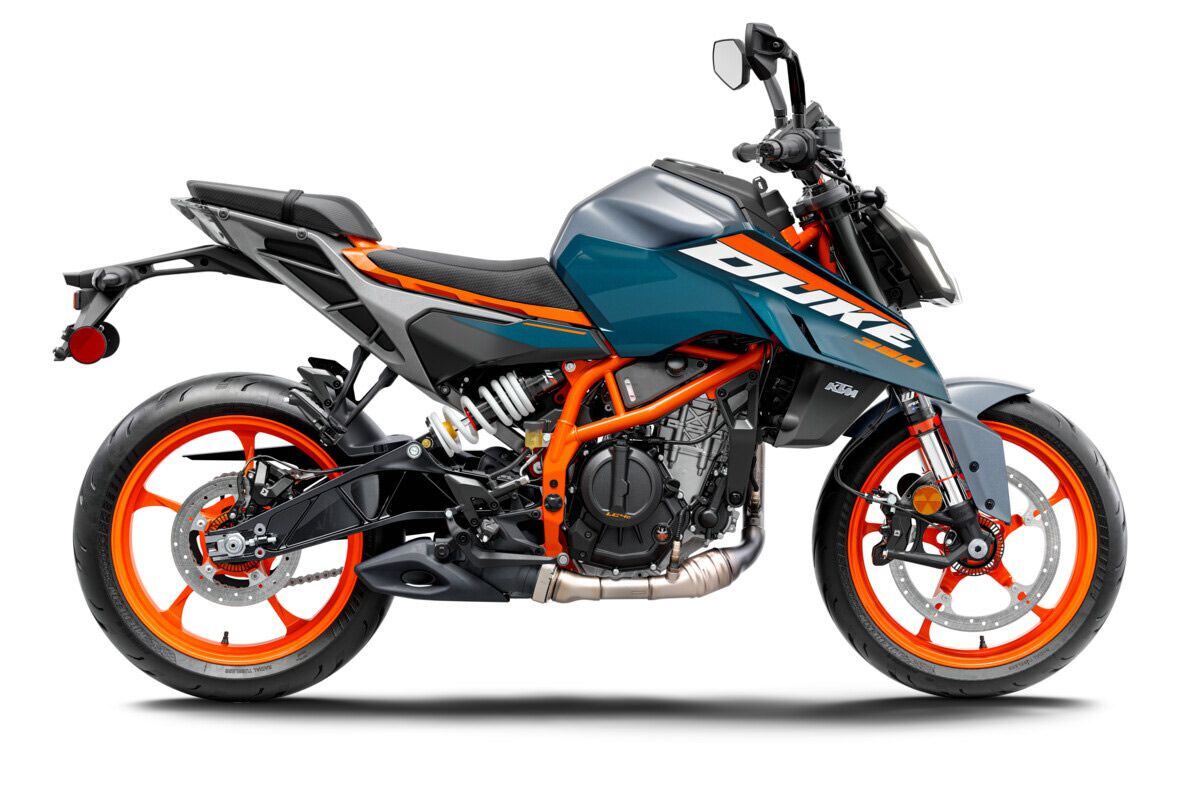

The 390 Duke is available in signature Electronic Orange and Atlantic Blue colors. Note the updated headlight’s sleek position lights.
The 390 Duke is available in signature Electronic Orange and Atlantic Blue colors. Note the updated headlight’s sleek position lights. (KTM/)

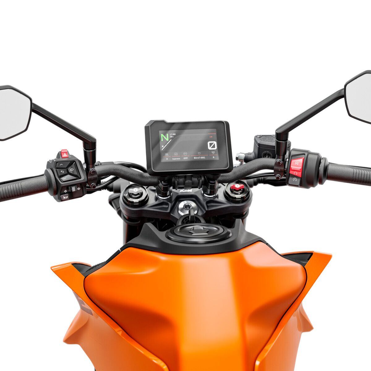

The 390 has an updated 5-inch TFT dash lifted from other models in the KTM lineup. The 250 makes do with an identical looking unit, except its display is LCD.
The 390 has an updated 5-inch TFT dash lifted from other models in the KTM lineup. The 250 makes do with an identical looking unit, except its display is LCD. (KTM/)

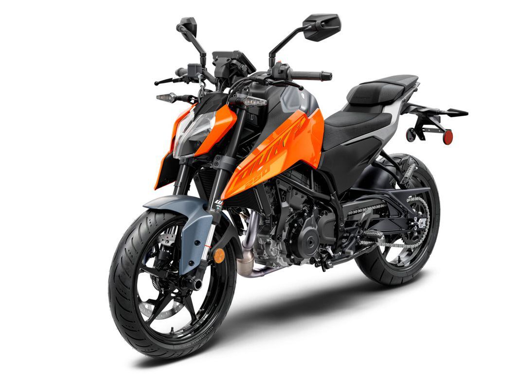

The 250 Duke is available in Electronic Orange (pictured) and Ceramic White colors.
The 250 Duke is available in Electronic Orange (pictured) and Ceramic White colors. (KTM/)

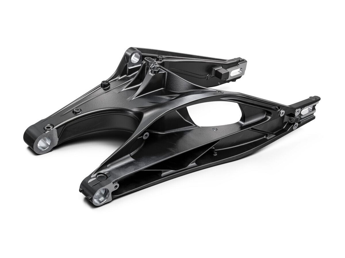

The KTM’s new swingarm sure is a far cry from the extruded swingers of yesteryear’s entry-level motorcycles.
The KTM’s new swingarm sure is a far cry from the extruded swingers of yesteryear’s entry-level motorcycles. (KTM/)The smaller Dukes’ looks continue to share a strong family resemblance with its middleweight and open-class naked bikes.
