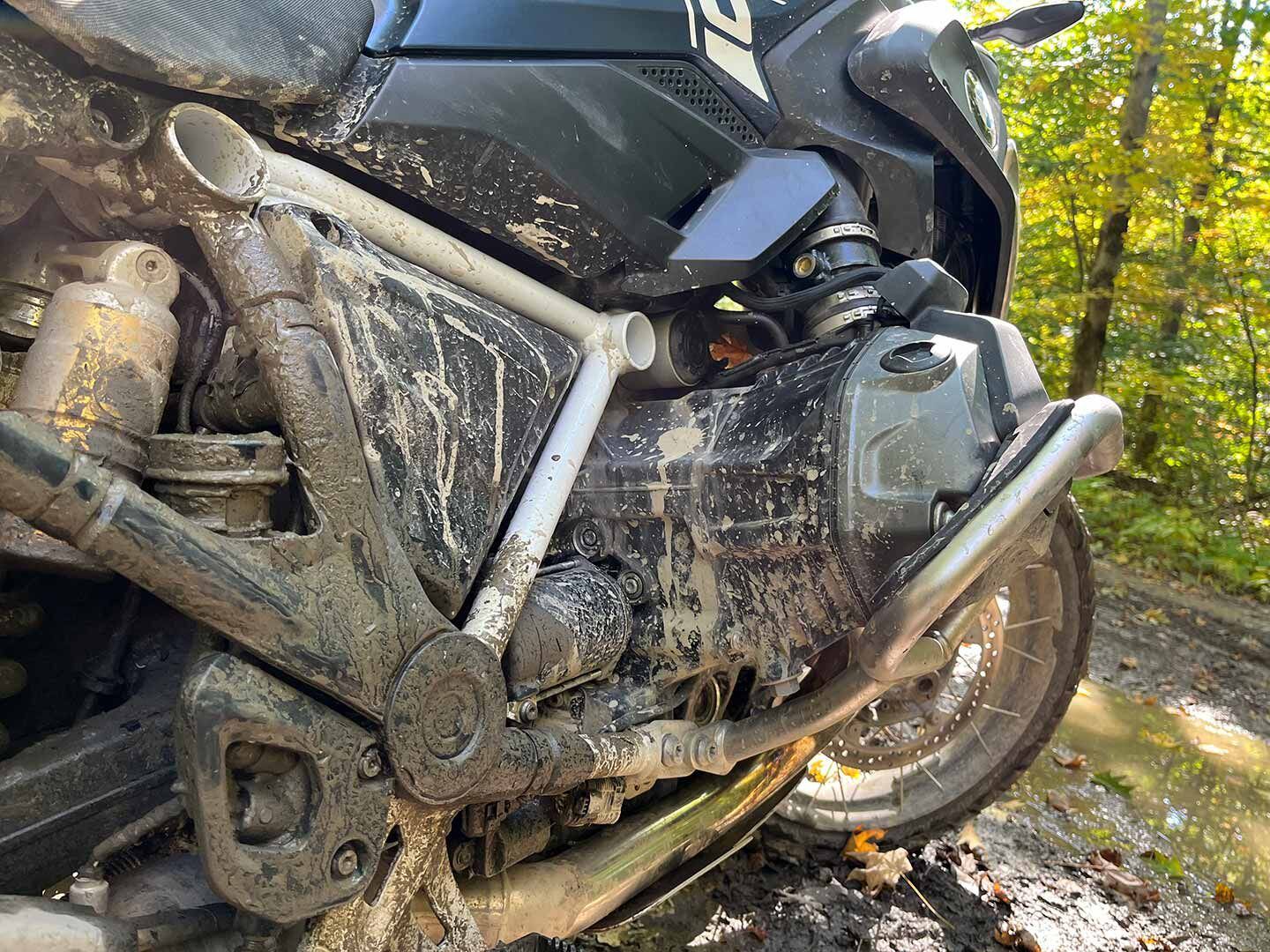

The GS’ cylinder with a coating of mud. All is right with the world.
The GS’ cylinder with a coating of mud. All is right with the world. (Seth Richards/)
As Kevin Cameron points out, one of the main benefits of an opposed twin is balance. Because its two crankpins are spaced 180 degrees apart, the shaking forces of piston motion cancel each other out. For off-road riding, where slow-speed maneuverability is paramount, another huge benefit of the layout is that the cylinders sit next to the crankcase instead of on top of it, creating a very low center of gravity.
Due to having long-travel suspension and large fuel tanks that sit high up—especially above an inline- or V-configured engine—some ADV-tourers can feel particularly vulnerable to changes in rotational motion; getting them off-center at low speeds can be dicey. In comparison, a boxer-powered GS feels far less cumbersome. The GS’ outriggerlike cylinder heads give tremendous stability—for the same reason a trapeze artist holds a long pole on the wire.
Related: Trophy Life—Training for the BMW GS Trophy With Ben Phaup
For riders who are venturing off-road for the first time or touring with camping gear and several days of food stowed on board, the GS’ low CG is hugely confidence-inspiring. Despite its big-bike stature, the GS is stealthily accommodating to riders of varying skill levels. As Executive Editor Justin Dawes points out in the 2021 open-class adventure bike shootout, “When the going is slow and technical, the GS shines. It seems to balance all by itself even at walking speeds, allowing riders to pick a line and and then pick it apart.”
Still, like all heavyweight adventure-tourers, riders must use their own bodyweight to their advantage. On a lightweight single-cylinder dual sport, riders can get away with a lot, but on a 600-pound ADV bike, gravity can become their enemy quickly. Here, the GS’ flat engine is once again an asset. In low-speed maneuvers, it affords riders a platform on which they can drop their outside knee to assist in counterbalancing the bike, preventing it from tipping over. Its built-in knee “rest” takes thinking about body position out of the equation to a large degree, making it automatic and repeatable. In this way, the GS’ design accommodates its proper usage. Its own shape dictates the shape the rider’s body makes and frees up mental space. As a bonus, when the bike does fall over, it only falls over halfway. It takes far less effort to lift it off its cylinder head than lifting a lighter bike that’s buried its handlebar in the dirt.

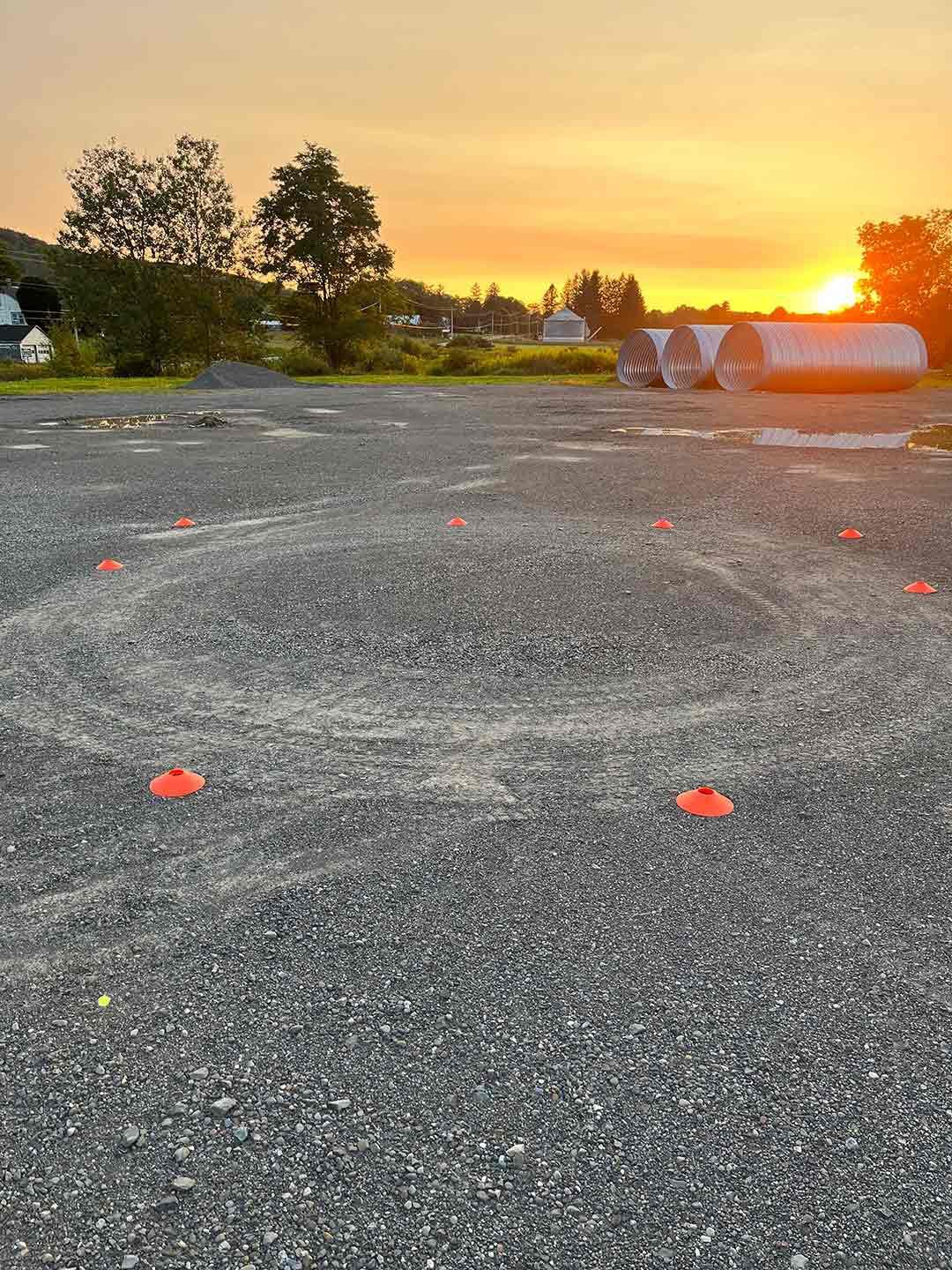

Cones set up at the local highway department for practicing 16-foot box turns. The GS excels at slow-speed maneuvers.
Cones set up at the local highway department for practicing 16-foot box turns. The GS excels at slow-speed maneuvers. (Seth Richards/)
The GS’ on-off throttle response is about as close to perfect as you’ll find this side of internal combustion. While power delivery is altered in its various ride modes, even at its most direct (in Dynamic modes), it’s buttery smooth from the moment the throttle butterflies open. Such clean throttle response helps riders give smooth inputs at the throttle, which in turn keeps the chassis settled.
On top of that, a glance at the dyno confirms the GS’ linear power delivery. While critics complain that the boxer engine isn’t as exciting as one that paints the dyno chart with peaks and valleys, when it comes to rideability, that’s for the best. Those peaks and valleys may make for an exhilarating ride, but come at the cost of traction. While modern rider aids can intervene to smooth a killer powerband, a naturally linear one that doesn’t break traction in the first place is still a better way to drive forward. When traction is at a premium off-road, the GS’ linear power delivery and smooth throttle response give the rear tire a fighting chance to get a grip.
