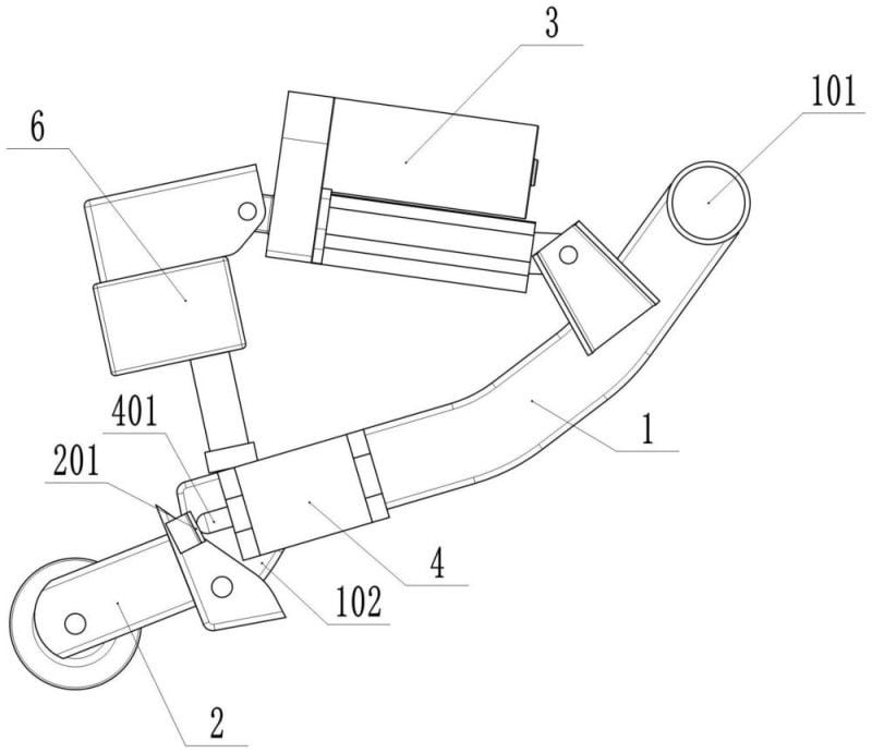

Loncin’s idea is a bit more involved than simply adding electrically extending training wheels that bolt to the swingarm, but remains a self-contained, add-on package that could be fitted to pretty much any bike with a dual-sided swingarm. The extra wheels could be extended at the touch of a button or automatically when you come to a halt, but instead of simply extending to a fixed length they have sensors on each leg that are triggered when the wheel on that leg touches the ground, allowing the system to work on an uneven surface or a cambered road.

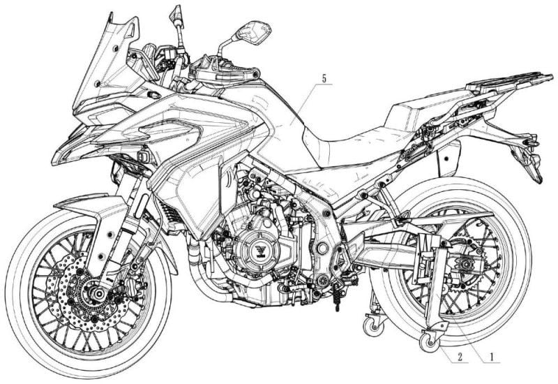

Two versions of the idea are illustrated in the patent application. The first has the wheels mounted on leading arms, pivoting at their rear end and operated by electrically extending arms fixed to the bike’s swingarm in front of them. The second variant uses a parallelogram system, with two lateral links attached to an upright with the wheel at the bottom.
Detailed view of the system, that in theory could be attached to any double-sided swingarm.
Detailed view of the system, that in theory could be attached to any double-sided swingarm. (Voge/)
Voge isn’t a brand that’s well known in the US yet, but it’s the export-focused, luxury arm of the vast Loncin bike making company. It already has a fast-growing presence in Europe, with a range of bikes from 125cc to 650cc, and recently launched the 900DS—a parallel-twin adventure bike using BMW’s F 900 engine. Loncin already manufactures that engine on BMW’s behalf, so the arrangement is similar to the one that allows CFMoto to use KTM’s 799cc twin in the Ibex. The bike shown in the new patent is the Voge 525DSX, a parallel-twin adventure bike that was launched earlier this year.
