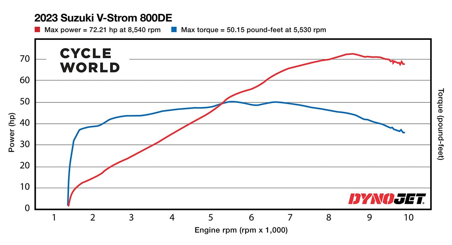

2023 Suzuki V-Strom 800DE Dyno Chart.
2023 Suzuki V-Strom 800DE Dyno Chart. (Robert Martin/)
Before loading the 2023 Suzuki V-Strom 800DE on our in-house Dynojet 250i dynamometer, the middleweight adventure bike measured a 507-pound wet weight on our automotive scales. On the Cycle World dyno, the Suzuki V-Strom 800DE produced 72.2 hp at 8,500 rpm and 50.2 lb.-ft. of torque at 5,500 rpm. For reference this places the Suzuki above the Yamaha Ténéré 700 (61.7 hp and 42.5 lb.-ft. of torque), Aprilia Tuareg 660 (69.9 hp and 44.2 lb.-ft. of torque), and Honda Transalp (70.6 hp and 47 lb.-ft. of torque) in the Cycle World performance database. The Suzuki V-Strom 800DE’s abundance of low-end torque and linear power delivery provide a thumpy engine characteristic that is tractable off-road yet exhilarating on the pavement. This engine has already won over the CW staff, and we expect that this powerplant will pay off for Suzuki for many years to come.
