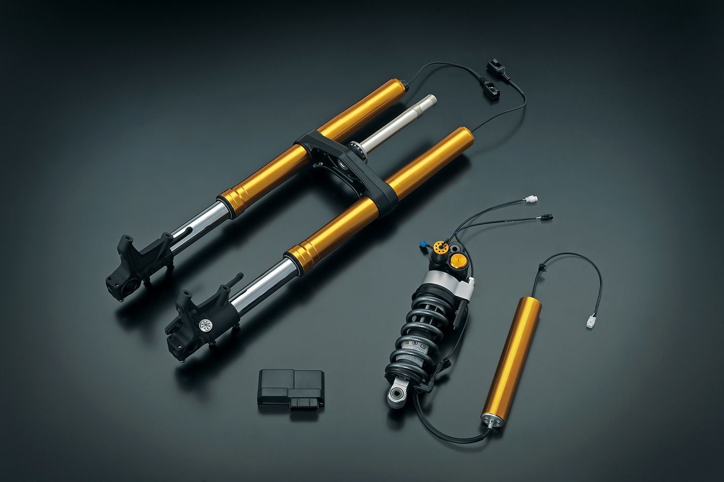

Suzuki Advanced Electronic Suspension (SAES) is supplied by Showa (and very similar to what’s used on Kawasaki’s Versys 1000 SE LT+) but modified to Suzuki’s liking. New to Suzuki, but not to the category, the suspension uses the now common “skyhook” approach, meaning stroke sensors and IMU data help monitor the motion of the motorcycle’s sprung weight in relation to an imaginary reference point directly above it. On rough roads, front and rear damping settings are adjusted in real time to keep the seat and handlebars stable, while the wheels and tires absorb bumps. Hard, Medium, and Soft settings are available, enabling the rider to tailor the damping based on the type of riding they’re doing. A customizable User mode further enables fine-tuning of Hard, Medium, and Soft base settings in single-level increments.
Electronic suspension—the first on a Suzuki—is supplied by Showa. The package consists of an SFF-CATM fork and BFRC-Lite shock. Notice the Suspension Control Unit (SCU) and motor unit that’s used to automatically adjust spring preload at the rear.
Electronic suspension—the first on a Suzuki—is supplied by Showa. The package consists of an SFF-CATM fork and BFRC-Lite shock. Notice the Suspension Control Unit (SCU) and motor unit that’s used to automatically adjust spring preload at the rear. (Suzuki/)
Suzuki says the system doesn’t completely eliminate pitch, “because the rider perceives changes in the bike’s posture and intuitively uses those movements to control it.” That said, the GX does have a system for adjusting damping force under deceleration, which helps control rear wheel lift during extreme braking.
Suzuki has also equipped the GX with an electronic rear spring preload system that detects load and automatically adjusts to maintain ideal chassis posture—think passenger getting on/off, or luggage being added/removed. One automatic and three manual preload settings are available: Auto, Single Rider, Single Rider + Gear, and Tandem. Base settings for each of the manual rear preload levels can be fine-tuned in single-level increments when building out the User suspension mode.

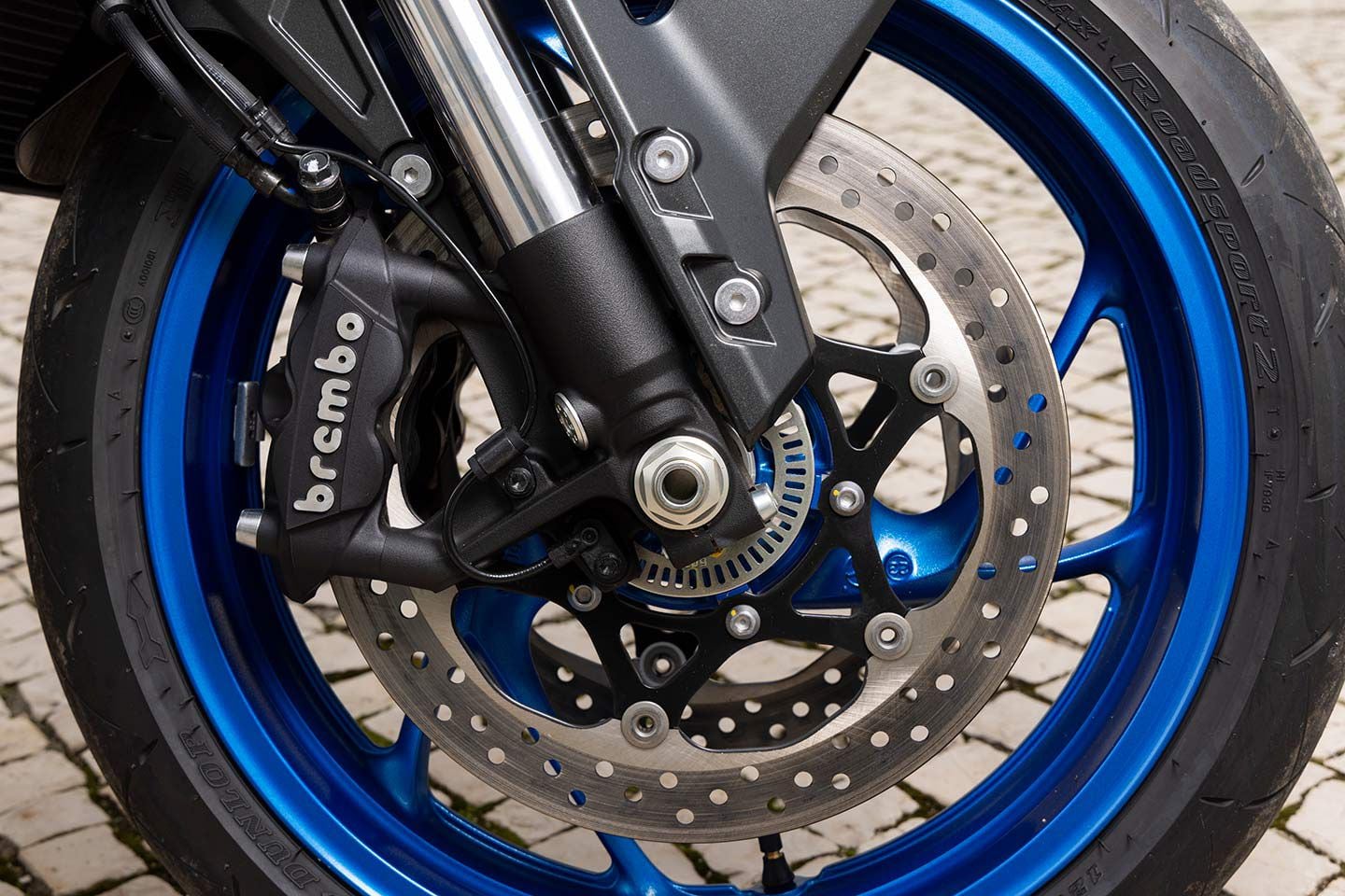

Front brakes lack initial bite and power through the pull, which leaves something to be desired on a bike that’s as capable as the GSX-S1000GX+.
Front brakes lack initial bite and power through the pull, which leaves something to be desired on a bike that’s as capable as the GSX-S1000GX+. (Suzuki/)

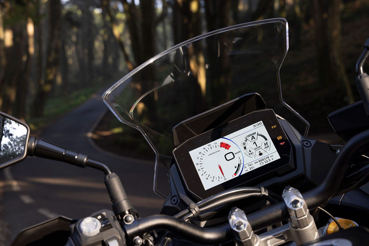

The 6.5-inch TFT display is easy to read at a glance and information is well organized. Riding modes (A, B, and C) are preset for power output, traction control, and suspension adjustments, but can be customized. There are seven levels of traction control (plus off), four suspension modes (Soft, Medium, Hard, User), and four rear preload settings (Auto, Single Rider, Single Rider + Gear, and Tandem).
The 6.5-inch TFT display is easy to read at a glance and information is well organized. Riding modes (A, B, and C) are preset for power output, traction control, and suspension adjustments, but can be customized. There are seven levels of traction control (plus off), four suspension modes (Soft, Medium, Hard, User), and four rear preload settings (Auto, Single Rider, Single Rider + Gear, and Tandem). (Suzuki/)
All adjustable systems are managed via a crystal clear, 6.5-inch TFT display that you’d be hard-pressed to fault. Information is well organized, visibility is great at all angles, and the (limited) submenus are easy to navigate. In a world where dashes are becoming more and more cumbersome, this is a standout feature and something GX+ owners will appreciate.

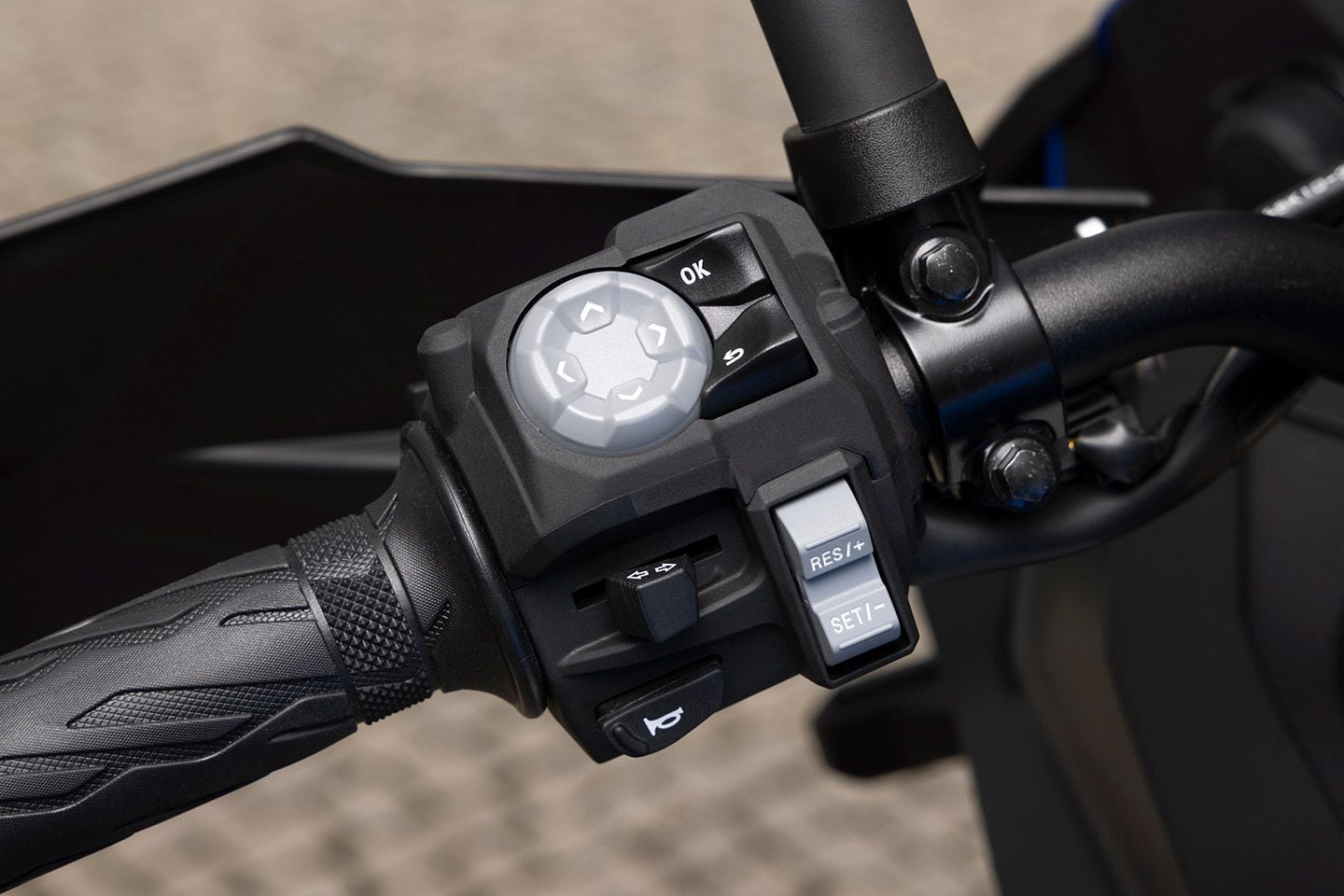

Suzuki is not one to overengineer the simple stuff. Switch gear isn’t large or intricate, but works exactly as you need it to.
Suzuki is not one to overengineer the simple stuff. Switch gear isn’t large or intricate, but works exactly as you need it to. (Suzuki/)

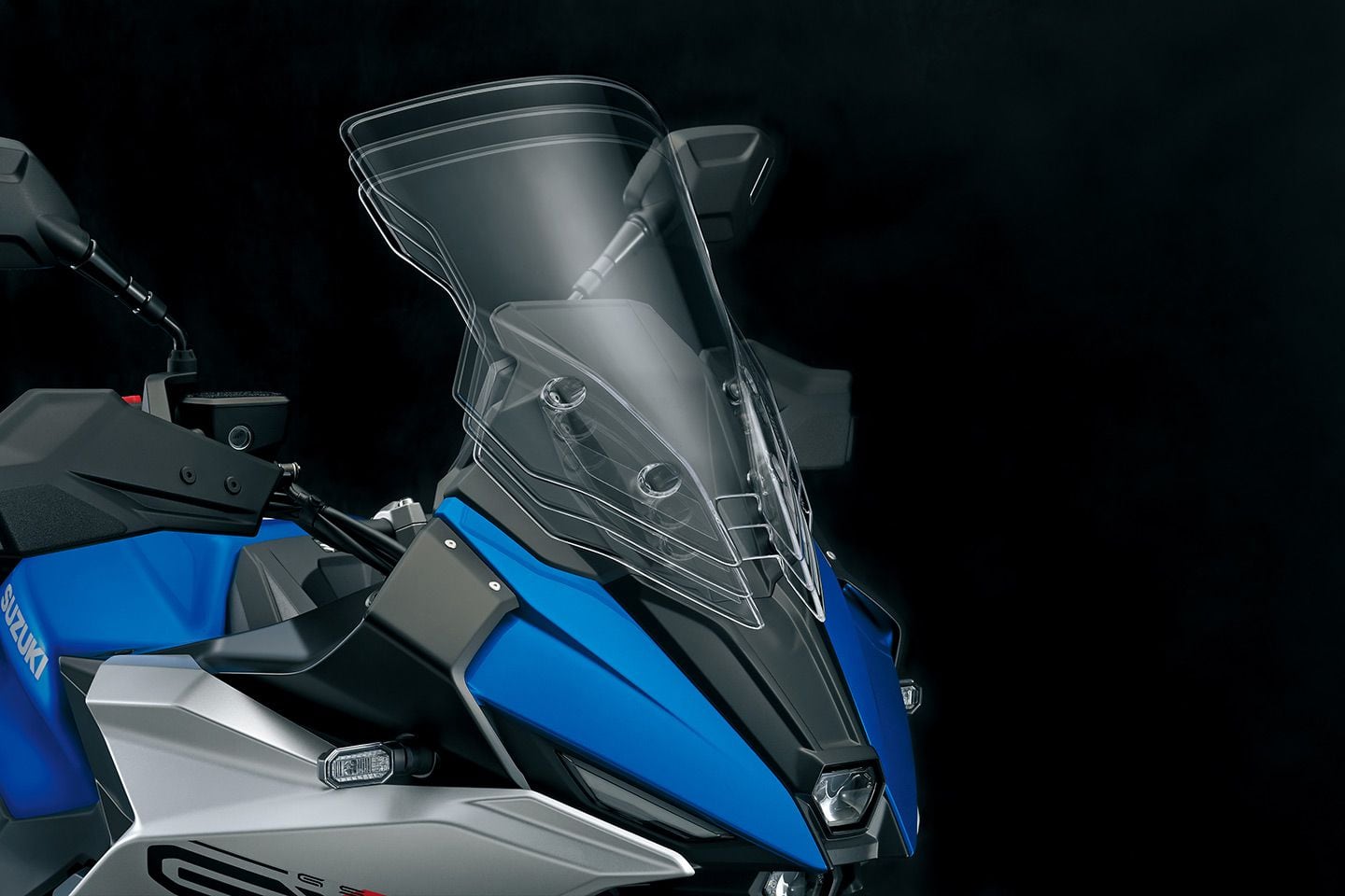

A model-specific windscreen is adjustable to three positions, enabling the rider to raise the screen by 1.7 inches. Tools are required, however, which feels like a big miss when you consider the intended use and that much of the GX+’s competition comes with screens that can be adjusted by hand, on the fly.
A model-specific windscreen is adjustable to three positions, enabling the rider to raise the screen by 1.7 inches. Tools are required, however, which feels like a big miss when you consider the intended use and that much of the GX+’s competition comes with screens that can be adjusted by hand, on the fly. (Suzuki/)

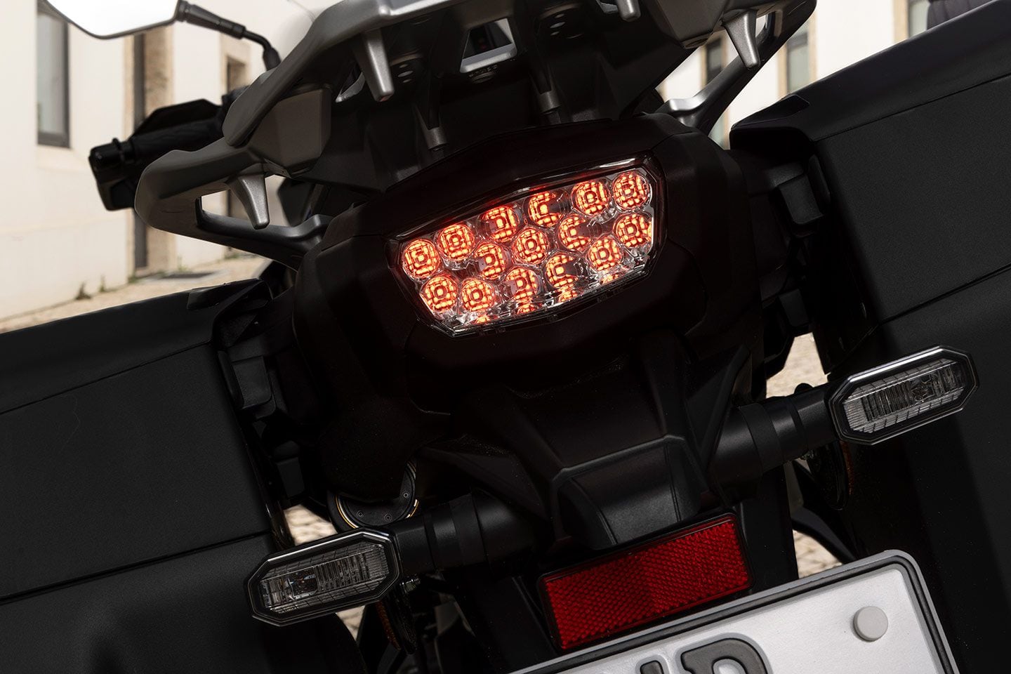

While the LED headlights and turn signals are quite sleek, the taillight and plastic casing are less stunning. It’s nothing major, but does stand out on an $18,500 bike.
While the LED headlights and turn signals are quite sleek, the taillight and plastic casing are less stunning. It’s nothing major, but does stand out on an $18,500 bike. (Suzuki/)

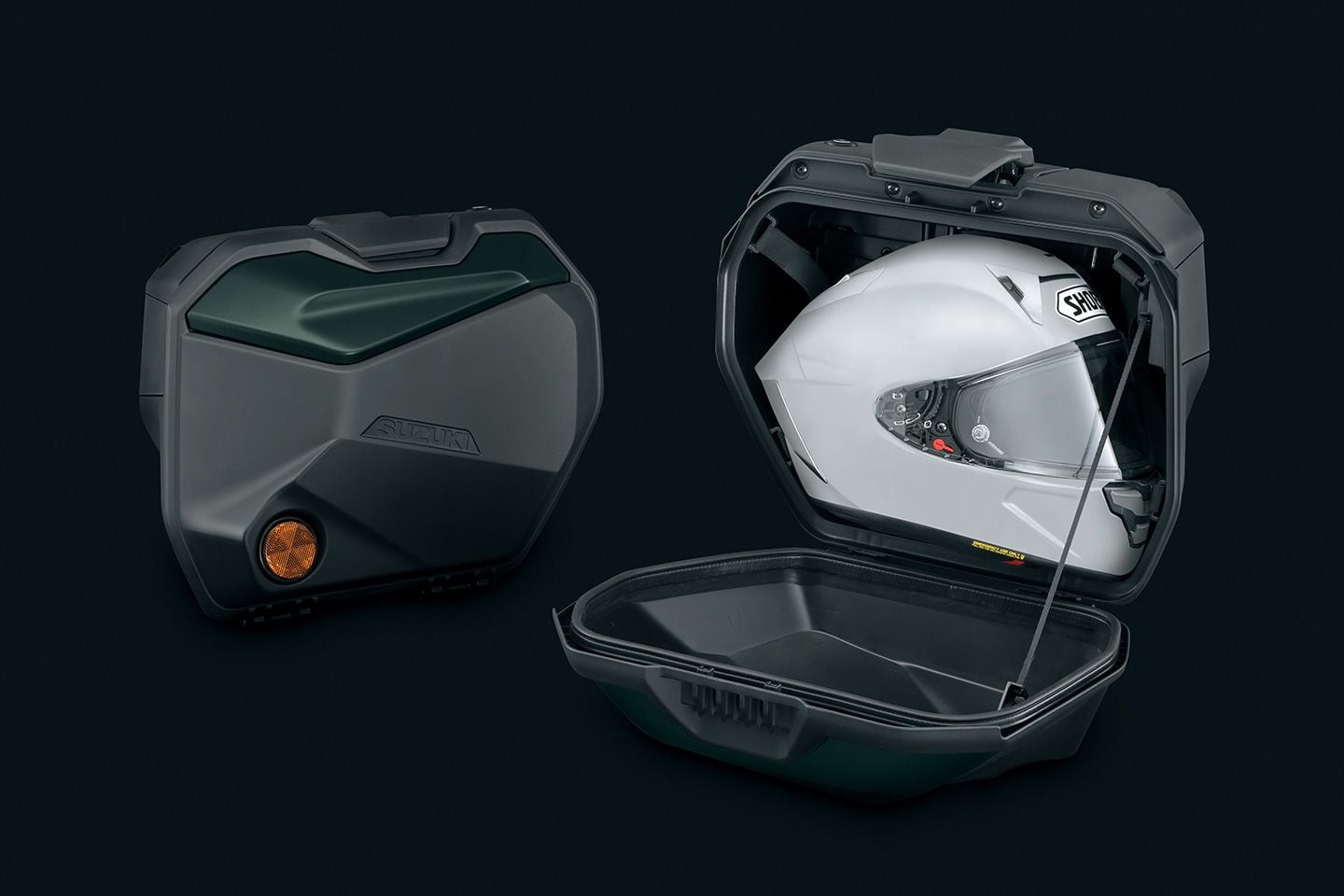

Side cases have 25.7 liters (0.9 cubic feet) of storage space and an 11-pound weight capacity. Our size medium helmet fit, even if just barely. Notice the Pearl Matte Shadow Green color.
Side cases have 25.7 liters (0.9 cubic feet) of storage space and an 11-pound weight capacity. Our size medium helmet fit, even if just barely. Notice the Pearl Matte Shadow Green color. (Suzuki/)An optional premium seat is available alongside other accessories, and worth the money based on the increased comfort it provides. Additional support is owed mostly to double-layer structure, with soft foam on the outside and harder foam on the inside. The stock seat is too soft and creates pressure points. An added benefit of the premium seat is that it’s designed to stay cooler when exposed to UV rays.e inside. The stock seat is too soft and creates pressure points. An added benefit of the premium seat is that it’s designed to stay cooler when exposed to UV rays.
