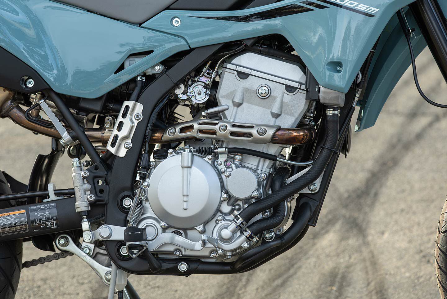

Both models utilize the same 292cc engine that has tractable low-end power and a connective throttle response.
Both models utilize the same 292cc engine that has tractable low-end power and a connective throttle response. (Kevin Wing/)
Both the Kawasaki KLX300 and KLX300SM utilize the same 292cc DOHC liquid-cooled four-valves-per-cylinder four-stroke engine, semi-double cradle frame, and suspension components, but each variant receives different spring rates and suspension travel more suitable to their respective discipline. The KLX300 features a 43mm inverted cartridge fork offering 10 inches of travel with adjustable compression damping and a Uni-Track gas-charged shock with rebound and preload adjustment offering 9.1 inches of travel. The dual sport variant is fitted with a 250mm front rotor and dual-piston caliper, along with a 21-inch front wheel and 18-inch rear wheel.

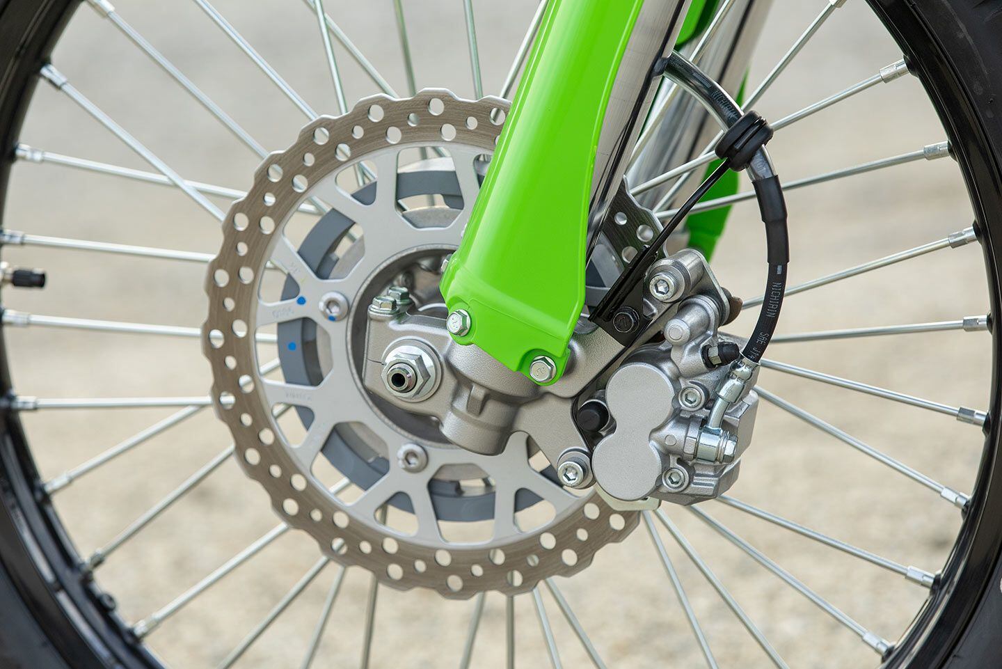

The 2024 Kawasaki KLX300’s braking system utilizes a 250mm disc and dual-piston caliper.
The 2024 Kawasaki KLX300’s braking system utilizes a 250mm disc and dual-piston caliper. (Kevin Wing/)

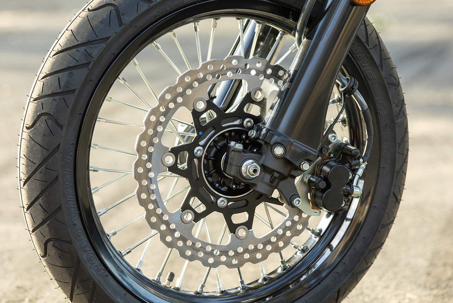

The 2024 Kawasaki KLX300SM utilizes a large 300mm front disc and dual-piston caliper.
The 2024 Kawasaki KLX300SM utilizes a large 300mm front disc and dual-piston caliper. (Kevin Wing/)

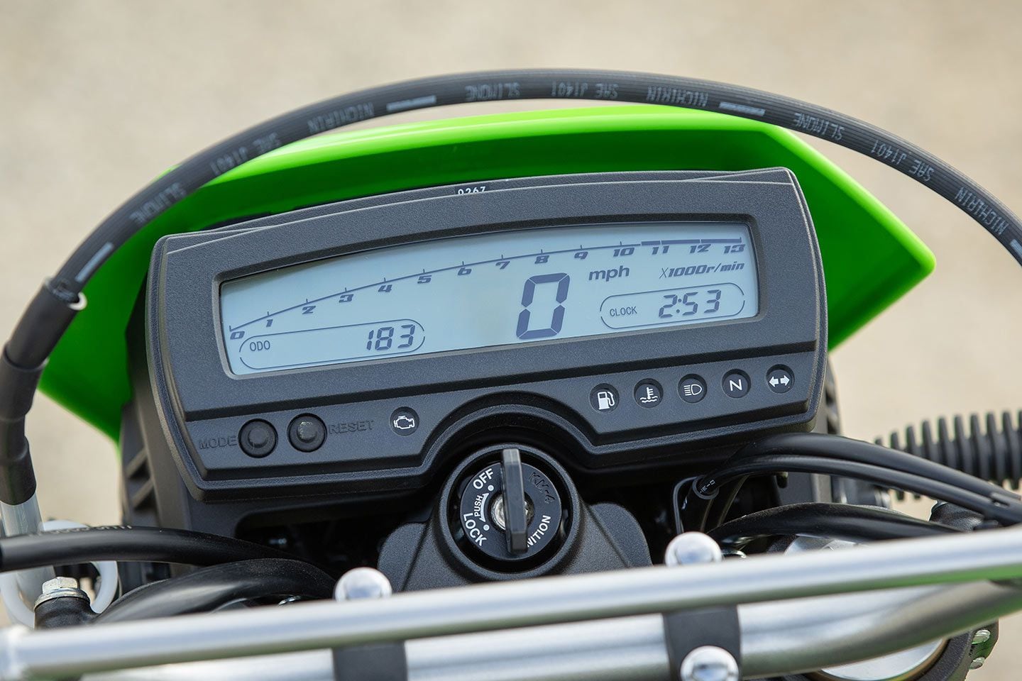

Even on steep jump faces the KLX300 maintains a neutral jump trajectory. (Kevin Wing/)Kawasaki's KLX300 and KLX300SM retain their simplistic digital dash for 2024. Both models would benefit from a proper fuel gauge and gear position indicator, like the unit found on the Honda CRF300L.
Kawasaki's KLX300 and KLX300SM retain their simplistic digital dash for 2024. Both models would benefit from a proper fuel gauge and gear position indicator, like the unit found on the Honda CRF300L. (Kevin Wing/)
