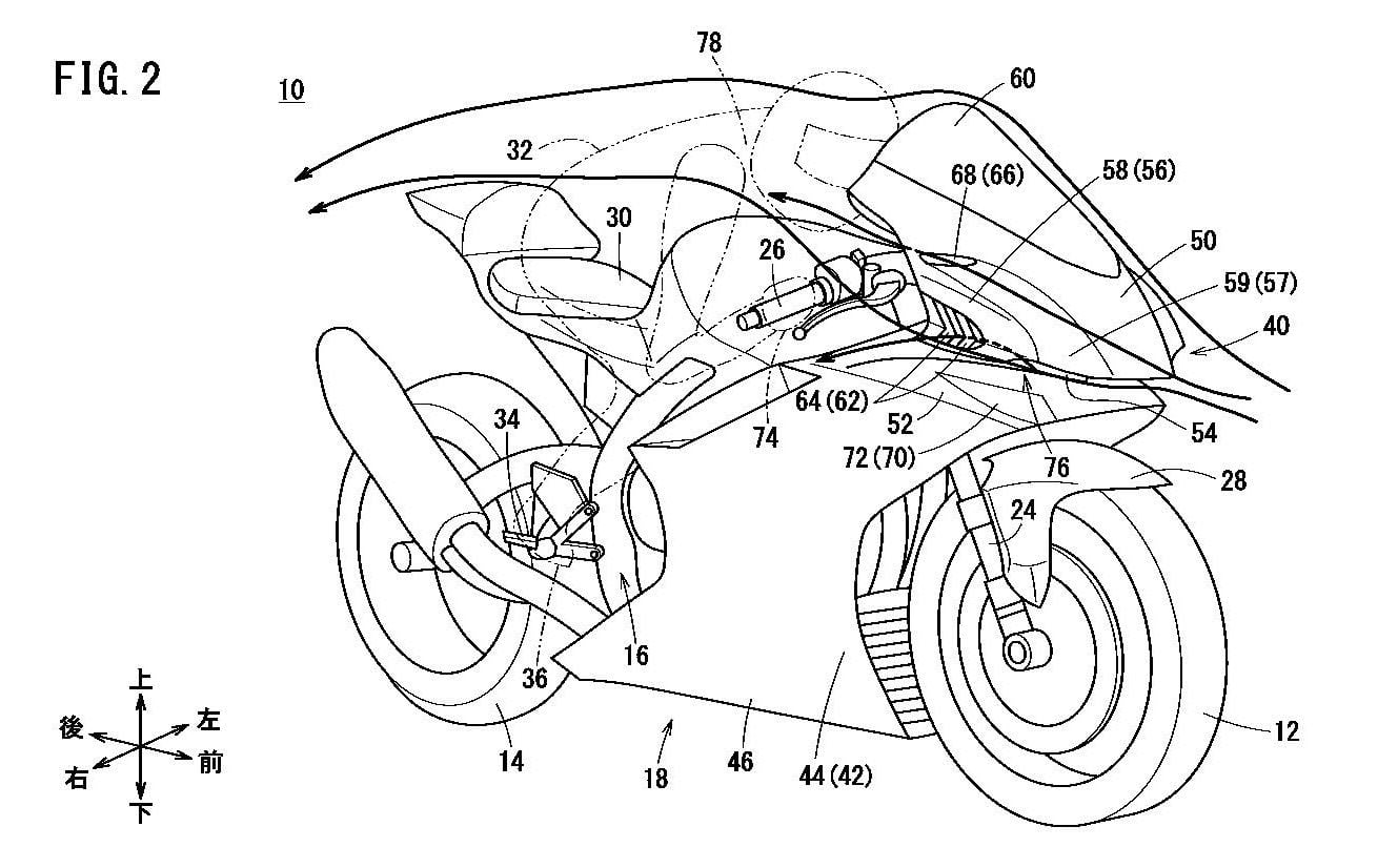

Honda patent drawing shows a new aero and front fairing that may find its way to the CBR1000RR-R Fireblade SP.
Honda patent drawing shows a new aero and front fairing that may find its way to the CBR1000RR-R Fireblade SP. (Honda/)
Honda has just given its CBR1000RR-R SP Fireblade a surprisingly substantial set of technical updates for the 2024 model year, but most of them are underneath a largely unchanged set of bodywork. Now a new patent application from the company shows that a more substantial set of visual revisions are under development with a focus on boosting downforce while simultaneously slashing drag.
One of the few external revisions to the 2024 CBR1000RR-R SP is the addition of new, MotoGP-inspired, hoop-style winglets on the nose, replacing the side-mounted, multilayered versions of its predecessor. These are a tried-and-tested solution to the growing demand for front-end downforce, proved in the heat of competition and offering a handy visual link to Honda’s MotoGP machines, but inevitably add drag when compared to a cleaner fairing design. The completely reworked shape seen in a newly published patent application aims for the best of both worlds, dropping the sticking-out wings and reducing the bike’s frontal area in pursuit of less drag while introducing an innovative nose design aimed at replicating the downforce of the missing winglets.
Honda’s patent describes removing winglets from the outside of the fairing and letting the front cowl do the aerodynamic work.

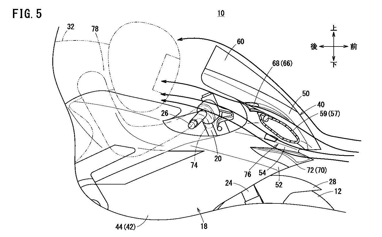

The key visible components of the new design are the clearly visible intakes on either side of the screen, just ahead of the handlebars. These are paired with a second set of intakes mounted lower down, inside the concave section just below the leading edge of the nose. Both intakes are matched to outlets on the rear side of the fairing, but what isn’t immediately visible is the shape of the internal bodywork that the air flows over between the intakes and outlets. This is only revealed in one drawing in Honda’s patent application (marked Fig. 5) that shows a cutaway section of the nose and reveals that the air flows around an aggressively angled wing profile inside the bike.
Air flows through the front cowl and over a wing inside (marked 59).
Air flows through the front cowl and over a wing inside (marked 59). (Honda/)
As well as creating downforce and reducing the bike’s frontal area, the design is claimed to offer added aerodynamic benefits further back, directing airflow more cleanly over and around the rider. The patent says that having passed through the nose and over the internal wing sections, the “discharged air functions as an air curtain… As a result, the wind protection range for the occupant can be reduced, and the size…[of the bike] when viewed from the front can be reduced. Therefore, aerodynamic drag can be further reduced.”
