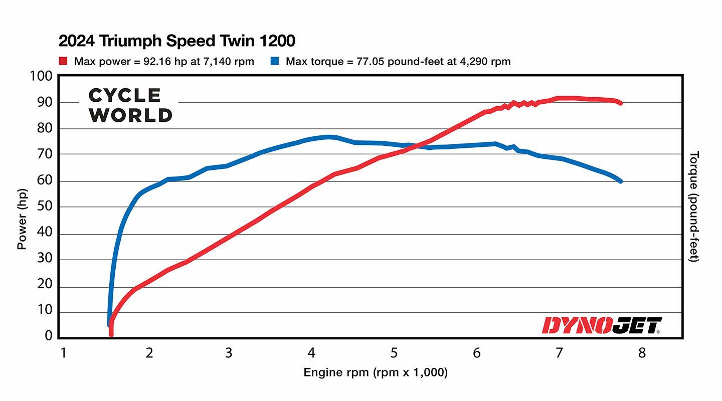

Before hitting our in-house Dynojet 250i dynamometer, the 2024 Triumph Speed Twin 1200 weighed 479 pounds on our automotive scales.
2024 Triumph Speed Twin 1200 Dyno Chart.
2024 Triumph Speed Twin 1200 Dyno Chart. (Robert Martin/)
On the Cycle World dyno, the roadster produced 92.2 hp at 7,100 rpm and 77.1 lb.-ft. of torque at 4,300 rpm. The abundance of torque and linear power delivery throughout the entire rev range along with its iconic engine pulse make the Triumph Speed Twin 1200 one of the most charismatic standards available.
