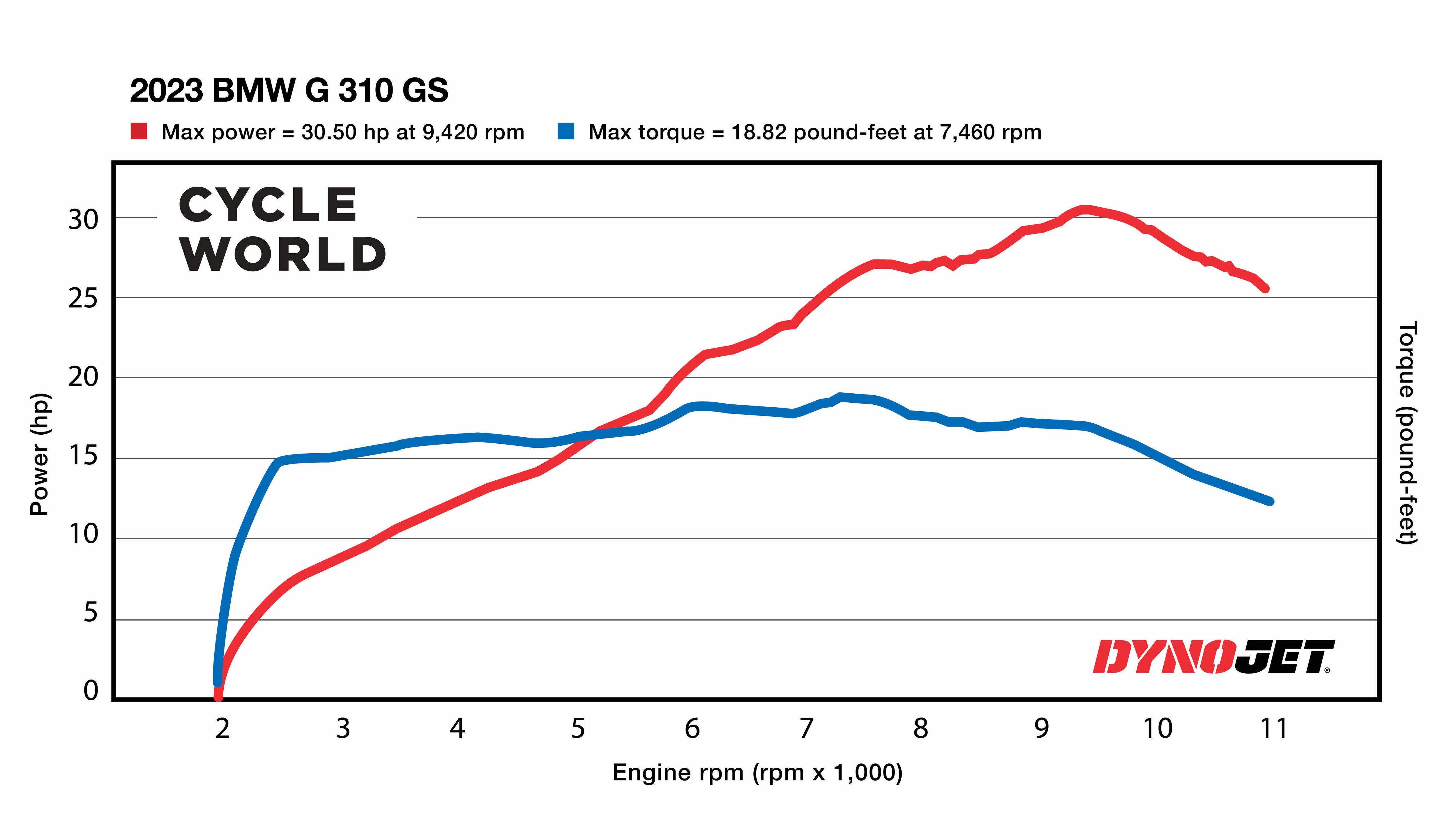

2023 BMW G 310 GS Dyno Chart
2023 BMW G 310 GS Dyno Chart (Robert Martin/)
On the Cycle World dyno, the 313cc single produced 30.5 hp at 9,420 rpm and 18.8 lb.-ft. of torque at 7,460 rpm. The engine’s flat torque curve and linear power delivery are predictable and manageable in every condition. But to get the most out of the single requires keeping the revs past 7,000 rpm.
