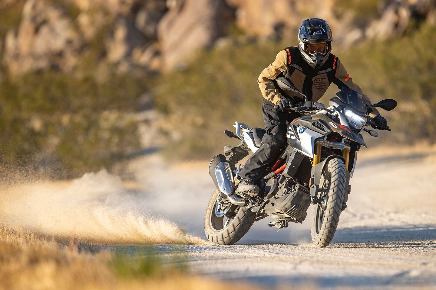

The BMW G 310 GS can be described in one word: playful.
The BMW G 310 GS can be described in one word: playful. (Jeff Allen/)

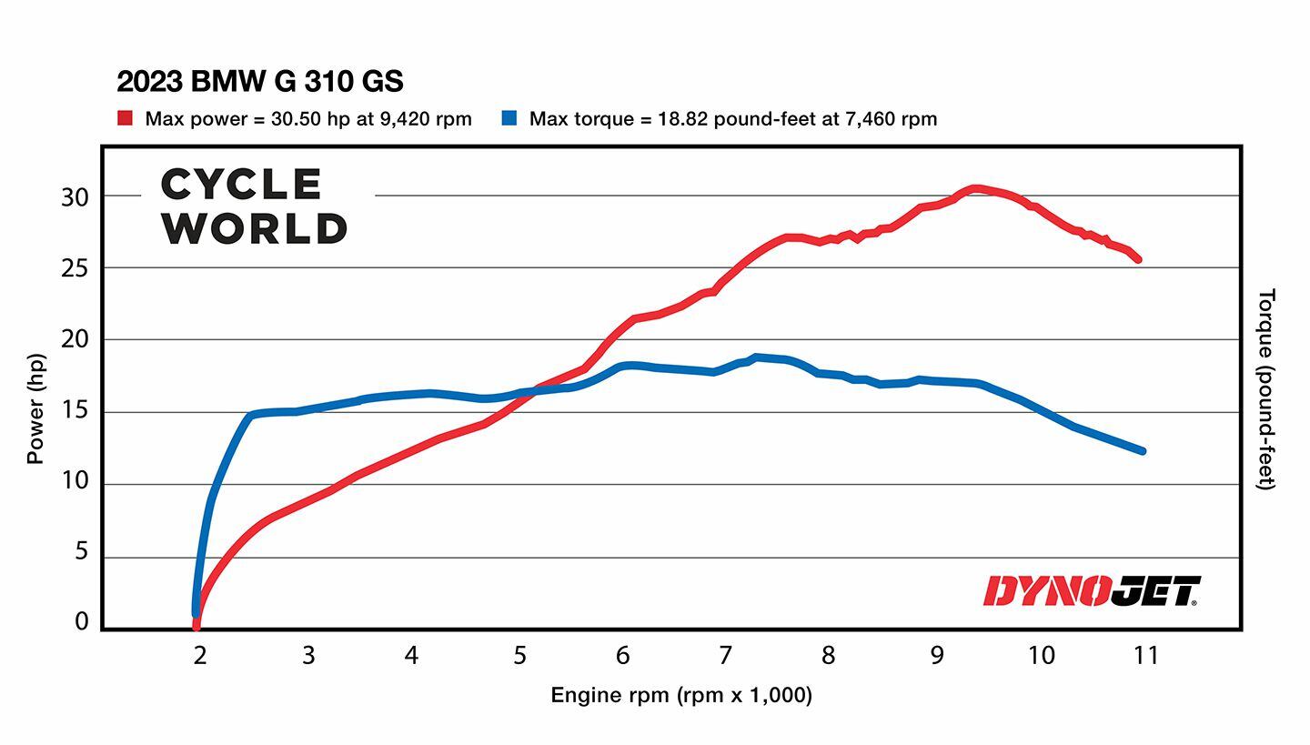

The BMW G 310 GS’s top-end performance may be attributed to its bore and stroke of 80mm x 62.1mm. (Jeff Allen/)2023 BMW G 310 GS dyno chart.
2023 BMW G 310 GS dyno chart. (Robert Martin/)
The 313cc single offers an extremely linear power delivery all the way up to its approximate 11,000 rpm redline. On our in-house Dynojet 250i dynamometer, the 2023 BMW produced 30.5 hp at 9,420 rpm and 18.8 lb.-ft. of torque at 7,460 rpm. Peak power is produced after 9,000 rpm—and that is felt on the road. Revving the engine to its cutoff provided the most drive out of corners. But its soft bottom-end proves useful with easy modulation for less experienced riders. Off-road the powerplant offers usable low-end torque that helps keep the road-biased Metzeler Tourance rear tire hooking up. Throttle response is soft but direct. Sliding corners or chugging up a hill, inputs applied at the throttle predictably translate to power delivery at the rear wheel.

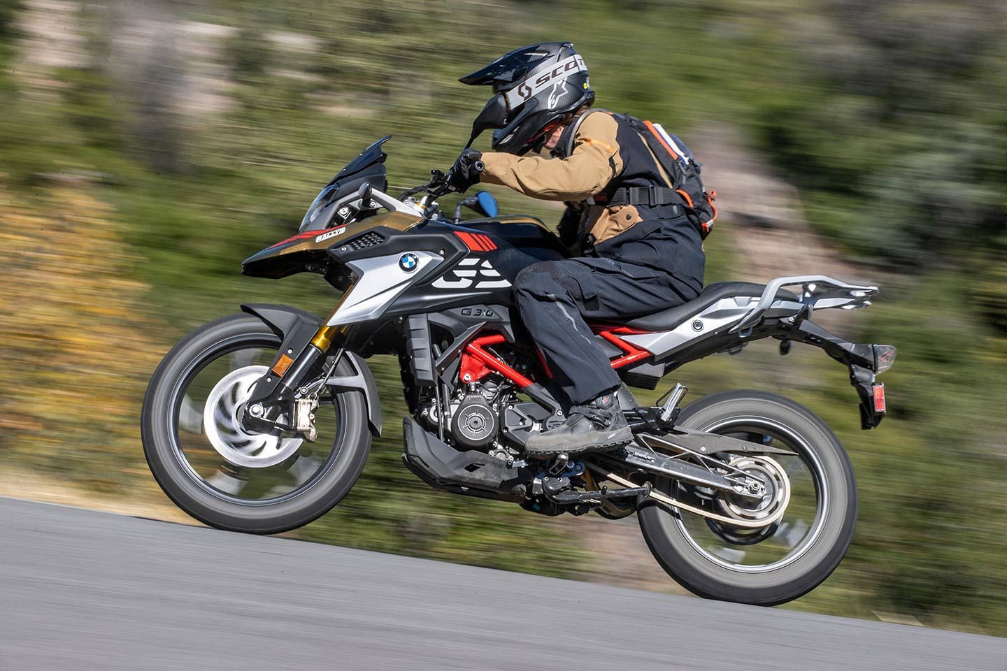

Suspension settings are soft and comfortable. Cruising around town or traversing a canyon road at moderate speeds, the components provide heaps of feedback, giving the rider a sense of control as well as increasing the available grip the surface has to offer. But aggressive riding will quickly find the limits of the BMW’s suspension. Charging down a twisty road, the suspension blows through the stroke and generates a lot of weight transfer, causing the steering to feel vague. Off-road, the supple suspension comfortably absorbs rocks and other small obstacles. But again, plowing through a rough section will quickly find the components’ limitations and make the bike a handful.
Carrying its weight well, this mini GS effortlessly rolls onto the side of its tire.
Carrying its weight well, this mini GS effortlessly rolls onto the side of its tire. (Jeff Allen/)

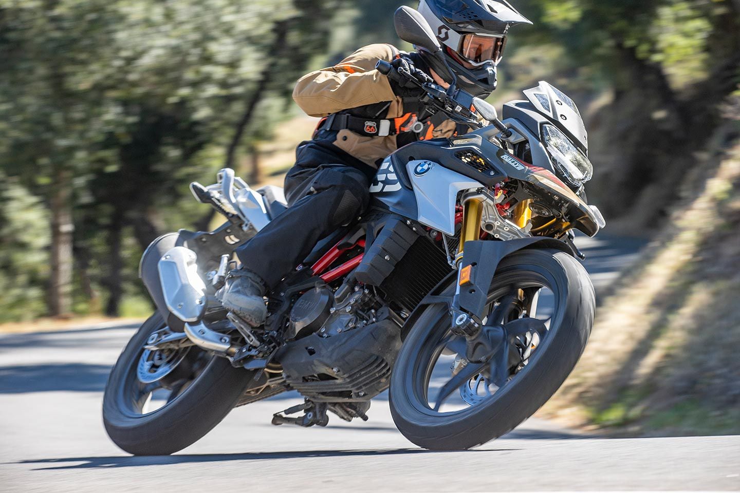

With no traction control rider aid, managing rear wheel grip is solely dependent on the pilot.
With no traction control rider aid, managing rear wheel grip is solely dependent on the pilot. (Jeff Allen/)

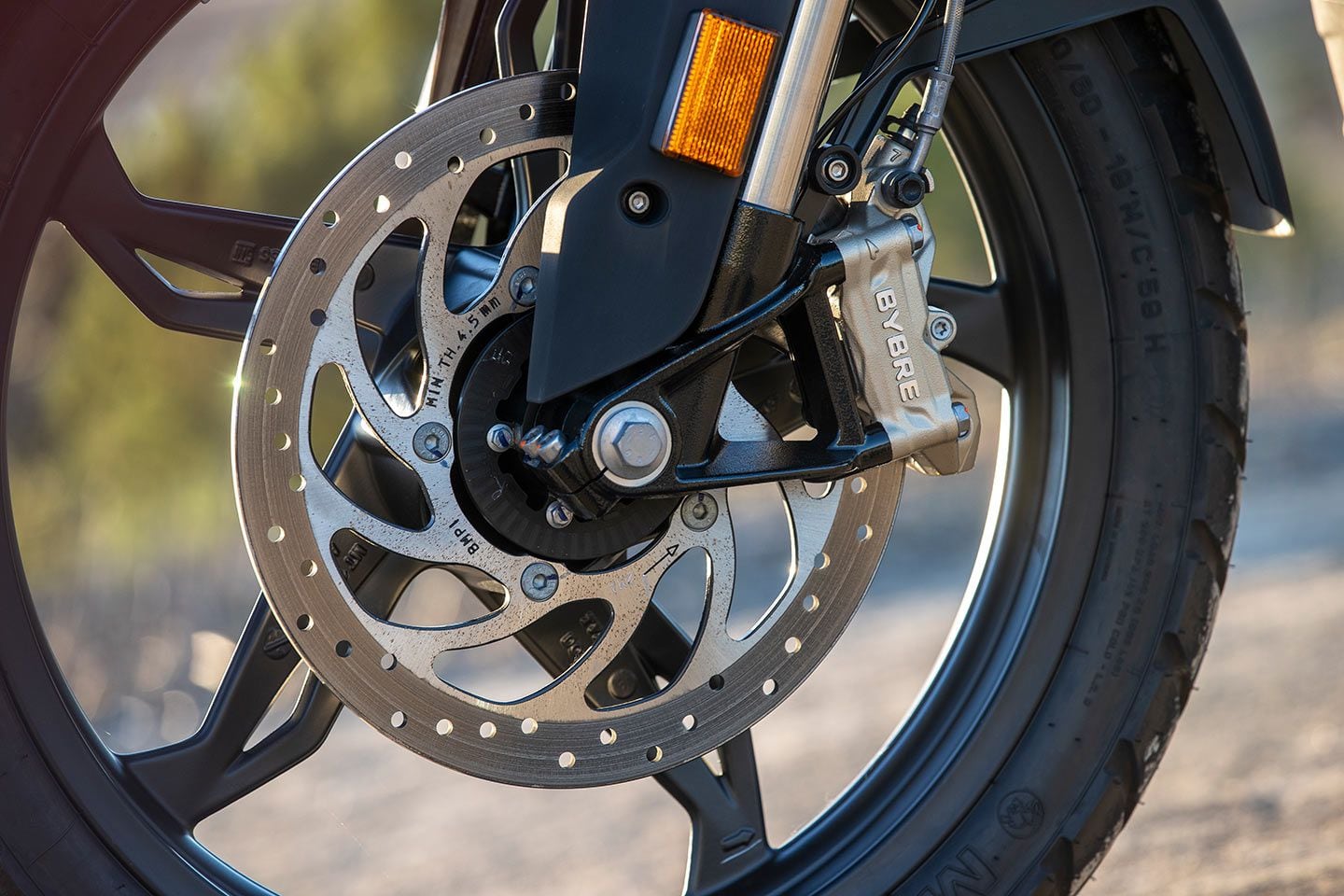

ByBre braking components are fitted at both ends of the motorcycle. Up front is a single four-piston radial-mounted caliper with a 300mm disc. At the back is a single-piston caliper with a 241mm disc. The components are responsive and progressive, but pronounced fork dive is present. Entering corners under hard braking the fork inevitably lives at the bottom of the stroke. No fault of the binders, just soft suspension.

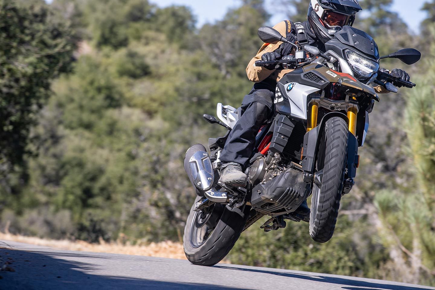

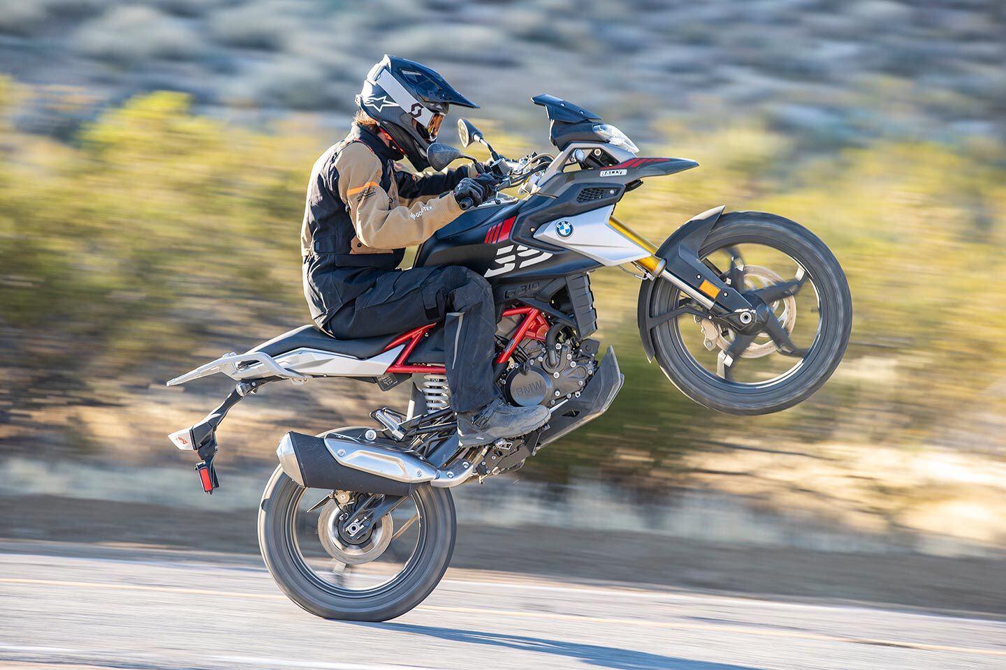

Yes, the G 310 GS is certainly capable of wheelies.
Yes, the G 310 GS is certainly capable of wheelies. (Jeff Allen/)The six-speed gearbox is tight and slick making it easy to change gears at any speed.

Standard seat height on the 2023 BMW G 310 GS is 32.8 inches. BMW offers a low seat option of 32.3 inches or a high seat option of 33.4 inches. (Jeff Allen/)BMW fitted the G 310 GS with a four-piston ByBre caliper, resulting in ample stopping power from the 300mm disc.

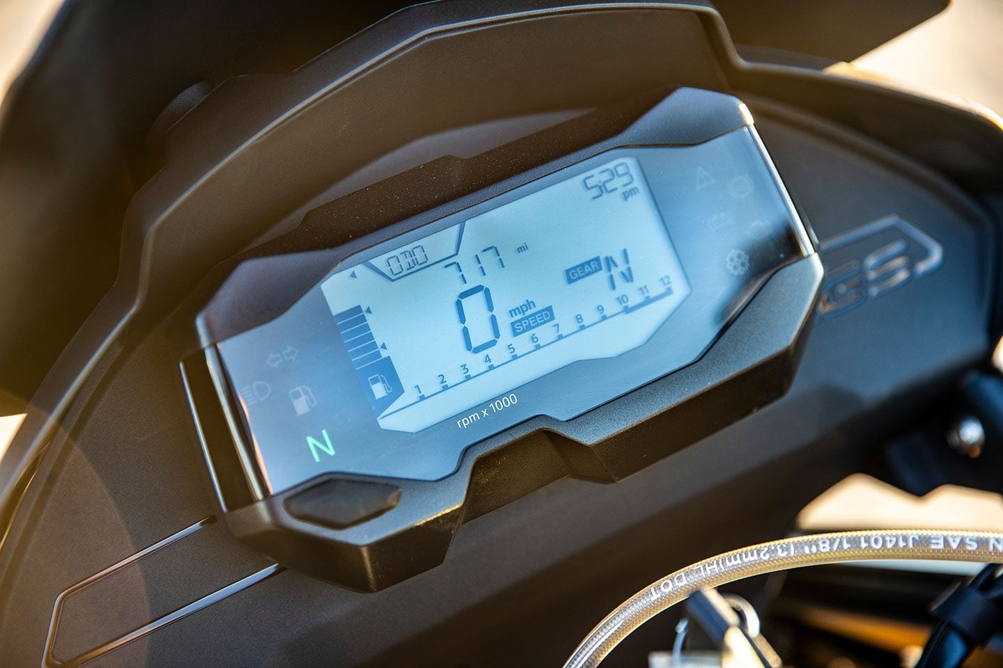

BMW fitted the G 310 GS with a four-piston ByBre caliper, resulting in ample stopping power from the 300mm disc. (Jeff Allen/)The digital dash is rudimentary but very functional. And the gear position indicator is a nice touch.

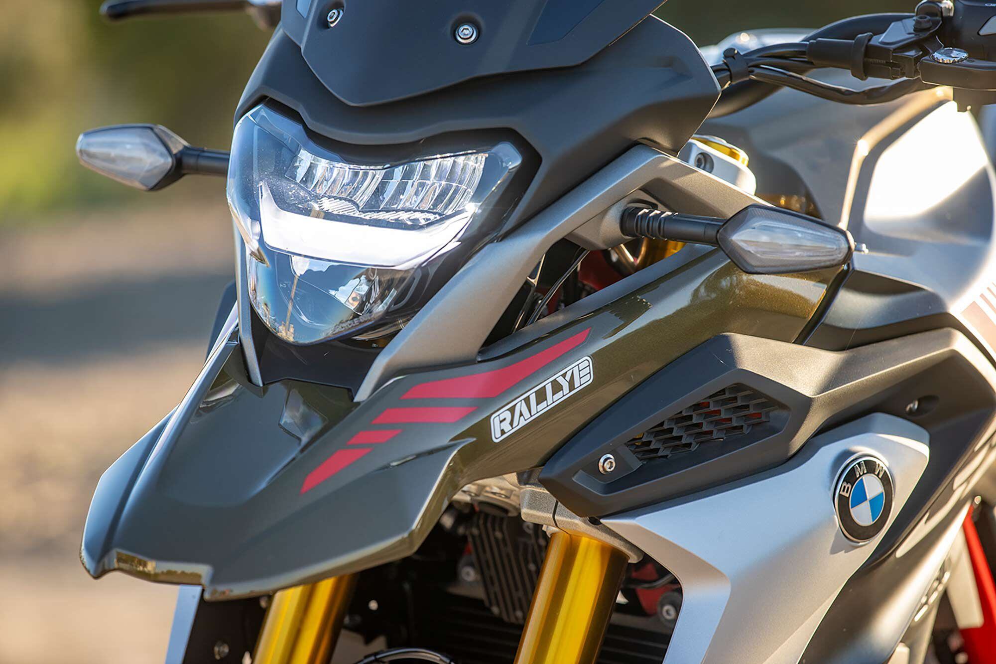

BMW equipped the G 310 GS with a LED headlight, taillight, and turn indicators. (Jeff Allen/)BMW gave the G 310 GS traditional ADV beak styling. The Kalamata Dark Gold Metallic paint and red frame are a nice touch too.
BMW gave the G 310 GS traditional ADV beak styling. The Kalamata Dark Gold Metallic paint and red frame are a nice touch too. (Jeff Allen/)The BMW G 310 GS is not all bark and no bite. For modest off-road adventures, the lightweight ADV will surely get you there.

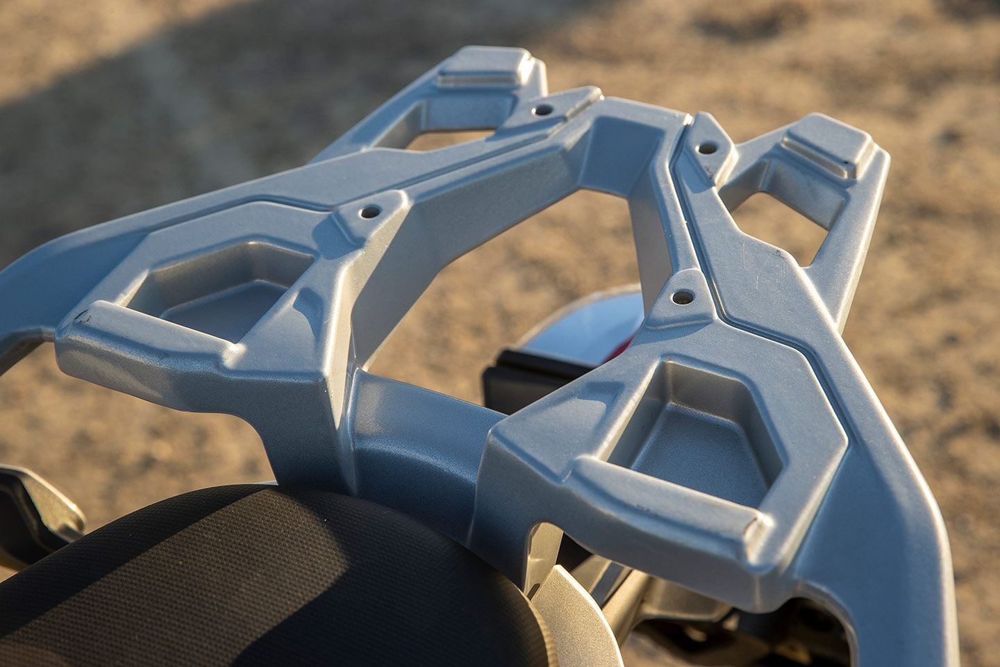

The BMW G 310 GS is not all bark and no bite. For modest off-road adventures, the lightweight ADV will surely get you there. (Jeff Allen/)Adding to the vehicle's utility is a large luggage rack. BMW offers a hard, 29-liter top case as an accessory.
