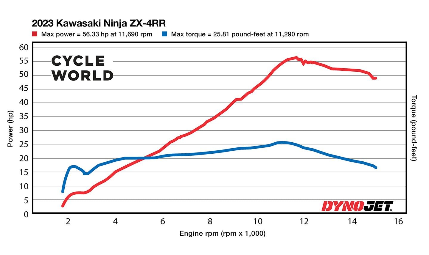

2023 Kawasaki Ninja ZX-4RR Dyno Chart.
2023 Kawasaki Ninja ZX-4RR Dyno Chart. (Robert Martin/)
On the Cycle World dyno, the 2023 Kawasaki Ninja ZX-4RR produced 56.3 hp at 11,700 rpm and 25.8 lb.-ft. of torque at 11,300 rpm. For reference, the 2022 KTM RC 390 (Cycle World’s 2022 Best Lightweight Streetbike) produced 40.2 hp at 8,900 rpm and 24.4 lb.-ft. of torque at 6,900 rpm, but has a lower wet weight of 365 pounds. The 4RRs linear power delivery and flat torque curve offers a flexible package for commuters and trackday enthusiasts alike. But like many small-displacement inline-fours, to get the most out of the engine requires keeping the rpm singing past the midrange and beyond.
