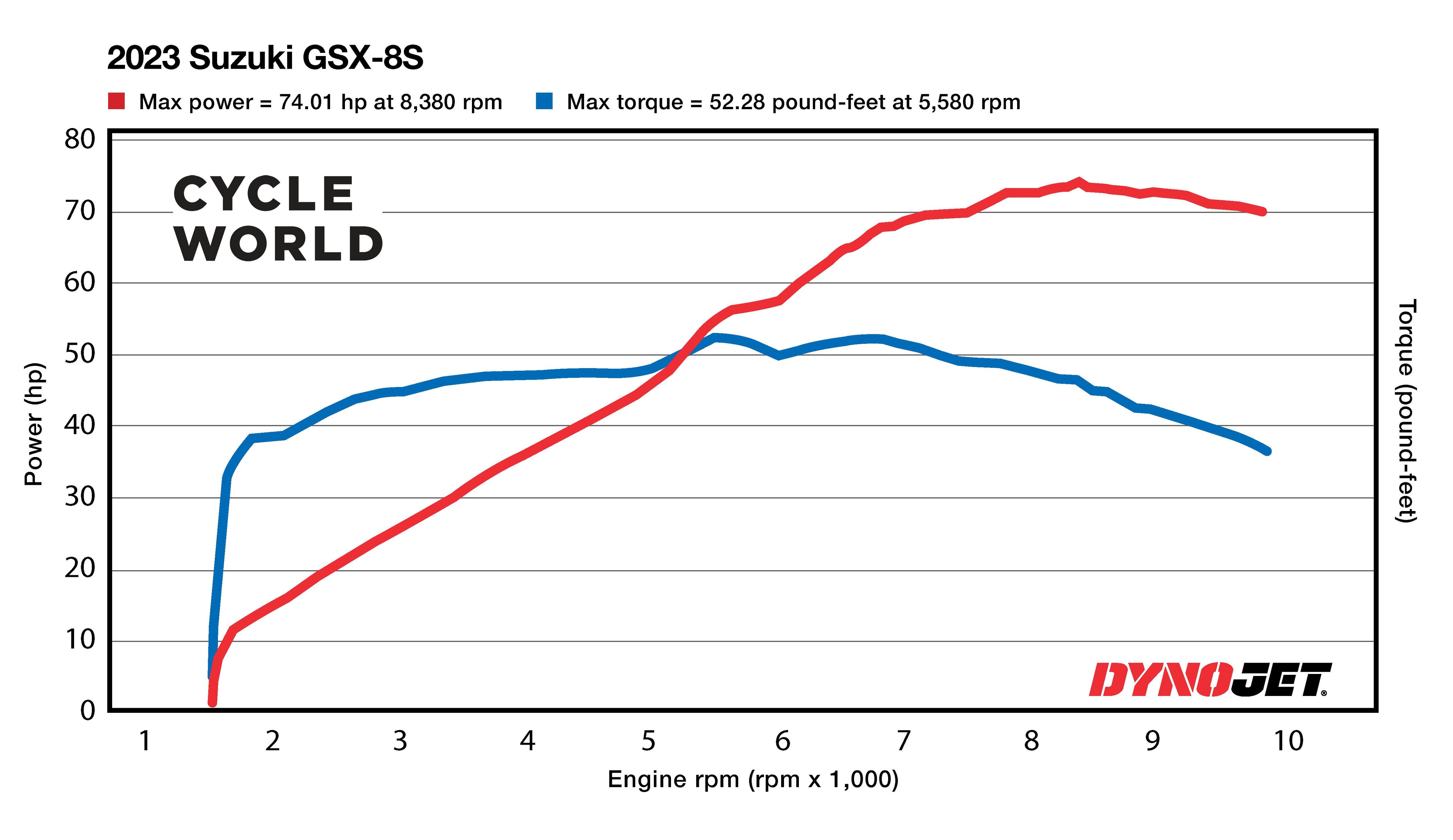

2023 Suzuki GSX-8S Dyno Chart.
2023 Suzuki GSX-8S Dyno Chart. (Robert Martin/)
Before rolling onto our in-house Dynojet 250i dynamometer, the 2023 Suzuki GSX-8S measured a wet weight of 446 pounds on our automotive scales. On the Cycle World dyno, the 2023 Suzuki GSX-8S produced 74 hp at 8,380 rpm and 52.3 lb.-ft. of torque at 5,580 rpm. For reference, the 2023 Suzuki V-Strom 800DE produced slightly less power at 72.2 hp and 50.2 lb.-ft. of torque. In both models, this engine is a gem—an office favorite due to its visceral acceleration from low rpm. The GSX-8S’ punchy character earned it Cycle World’s 2023 Best Middleweight. An abundance of torque available right off idle and a linear power curve provide a direct snap all the way through the midrange. Whether you are traversing a twisty backroad or commuting to work, these engine characteristics provide a thumpy response where riders need it most.
