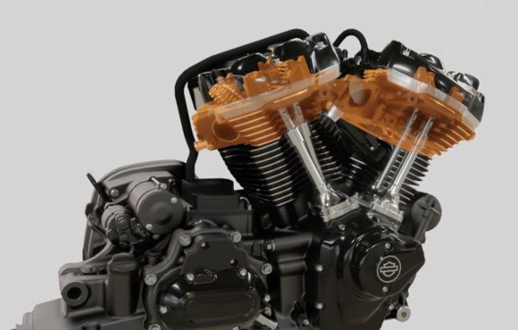

The Motor Company now offers its CVO Road Glide ST with the 121 HO engine—121 HO translates to 121ci (1,977cc) High Output—influencing the rear wheel strongly with a claimed 127 hp at 4,900 rpm and 145 lb.-ft. of torque at 3,000.
H-D’s 121 HO engine puts out 127 hp and 145 lb.-ft. of torque.
H-D’s 121 HO engine puts out 127 hp and 145 lb.-ft. of torque. (Brian J. Nelson/)
This engine puts aside the variable valve timing of non-ST 121 engines in favor of a camshaft with longer, race-inspired valve timing, redlined at 5,900 rpm.

More power means more heat, continuing to underline the usefulness of liquid-cooling around the exhaust valve seats. Many problems of heat engines are caused by high temperature “creep,” which is the slow yielding of metals under stress, even far below their melting point. When the material around the exhaust valve seats and port runs too hot, creep may become a problem, loosening seat inserts or distorting/displacing exhaust valve seats. This causes valve leakage that heats the parts even more. Liquid-cooling keeps the aluminum in critical locations at safe temperatures.
Liquid-cooling is used in the heads to fend off damage to the valve seats by high temperature.
Liquid-cooling is used in the heads to fend off damage to the valve seats by high temperature. (Brian J. Nelson/)
