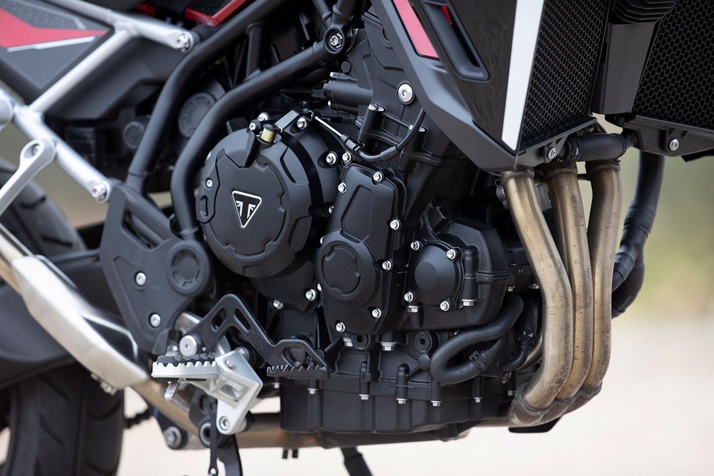

The Tiger 900’s T-plane crank triple now has 106.5 hp—that’s 13 percent more than in 2023.
The Tiger 900’s T-plane crank triple now has 106.5 hp—that’s 13 percent more than in 2023. (Triumph Motorcycles/)
All of this gets Triumph to that 13 percent increase in horsepower. Triumph now claims a peak output of 106.5 hp—the outgoing model had 93.7. That’s top-of-class horsepower. Torque has increased by 2.2 lb.-ft. to 66.4. Horsepower closely follows the previous model until 7,000 rpm and then it just keeps building to its 9,500-rpm peak. Even with the added go, Hinckley says that emissions have been reduced by 9 percent while fuel economy gets a 9 percent bump. Valve inspection interval has now gone from 12,000 to 18,000 miles.

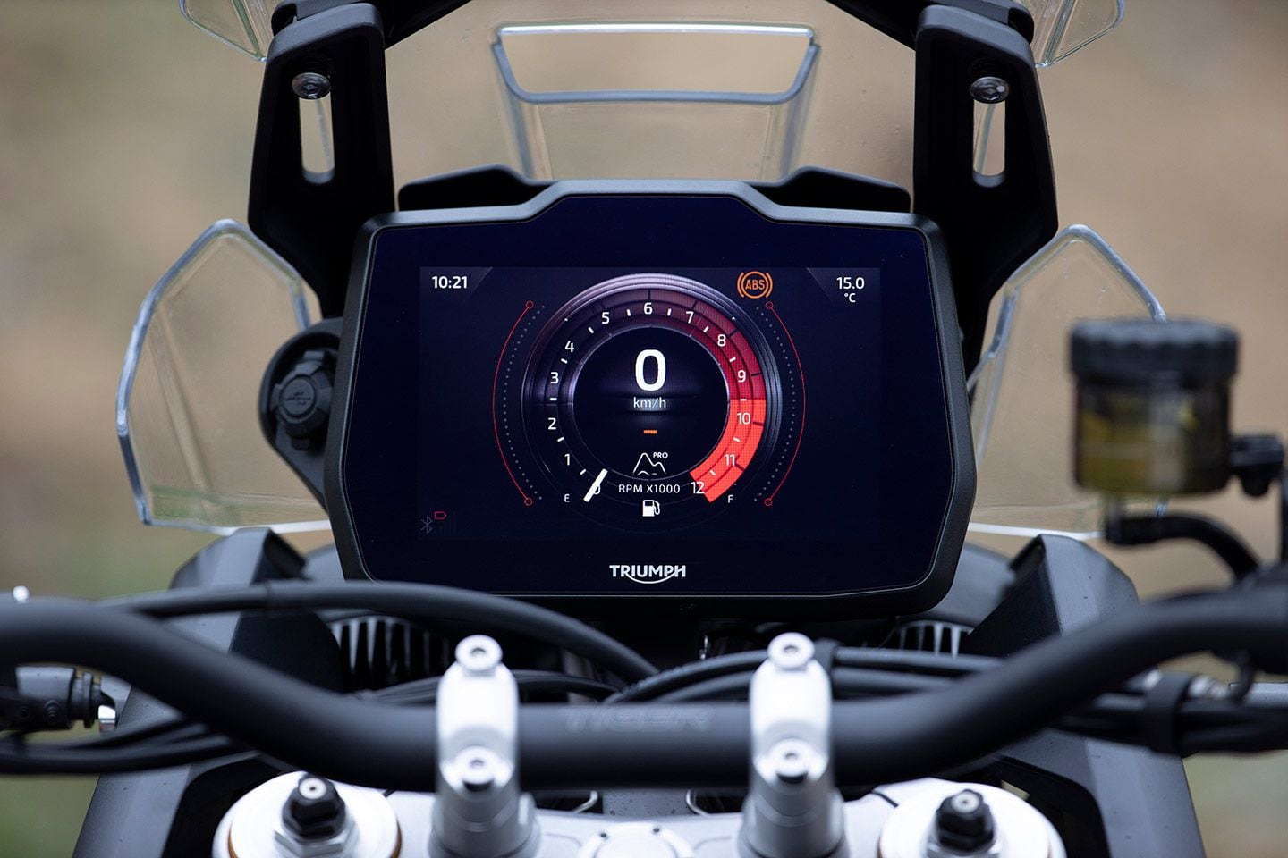

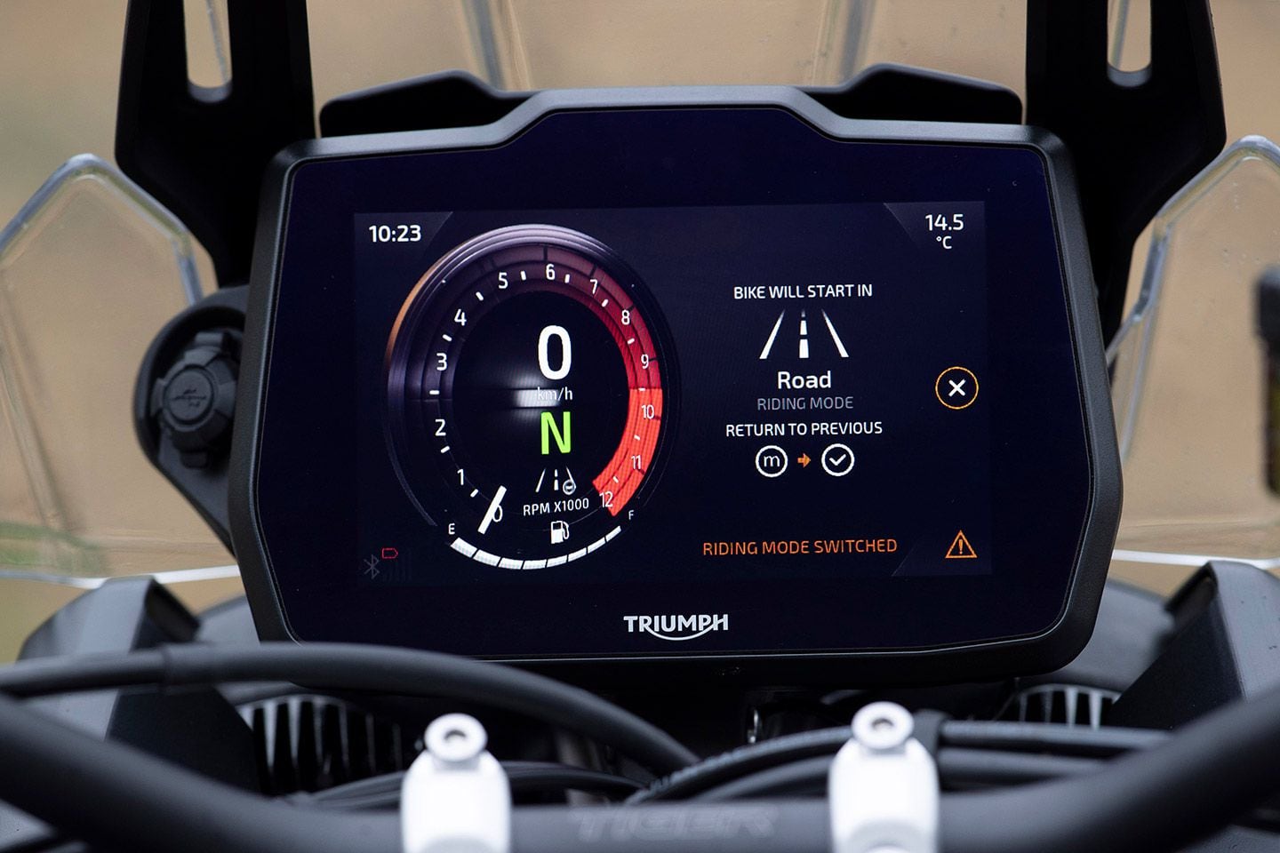

A new 7.1-inch TFT display lifted from the Tiger 1200 is bright and beautiful. The interface for Bluetooth functions such as calls and audio as well as adjusting modes, traction control, and ABS through Triumph’s slick switch cube on the left side of the handlebar is intuitive and easy to use. Mode selection also has its own button, and there are four in total to choose from on the GT: Sport, Road, Rain, Off-Road. The GT Pro gets an additional User mode, and the Rally Pro goes one more with a Off-Road Pro mode.
A 7.1-inch TFT dash is bright and easy to read in any lighting conditions.
A 7.1-inch TFT dash is bright and easy to read in any lighting conditions. (Triumph Motorcycles/)
Sport mode delivers the full force of the Tigers’ newfound horsepower with a quick and snappy throttle response. The lean-sensitive traction control kicks in only when you ask too much of the rear tire—though it does allow for a little bit of slip or squirm before it imperceptibly helps you out. Road mode is still stout in character without the aggression of Sport, with the traction control keeping everything in a line. Rain mutes everything for total control in slippery conditions. Off-Road lets the rear wheel loose for both sliding in the dirt as well as moving forward in softer terrain. The Rally Pro’s Off-Road Pro shuts the TC off completely—a handy feature in sand or mud. User mode lets you set up throttle response, TC, and ABS. When keyed off, the Tiger reverts from the User and Off-Road modes to a road mode unless you confirm those modes on start-up with a two-button push sequence. As you spend time with the Tiger off-road, those two presses become nearly automatic.
A press of two buttons reinstates all settings from before the bike was shut off.
A press of two buttons reinstates all settings from before the bike was shut off. (Triumph Motorcycles/)

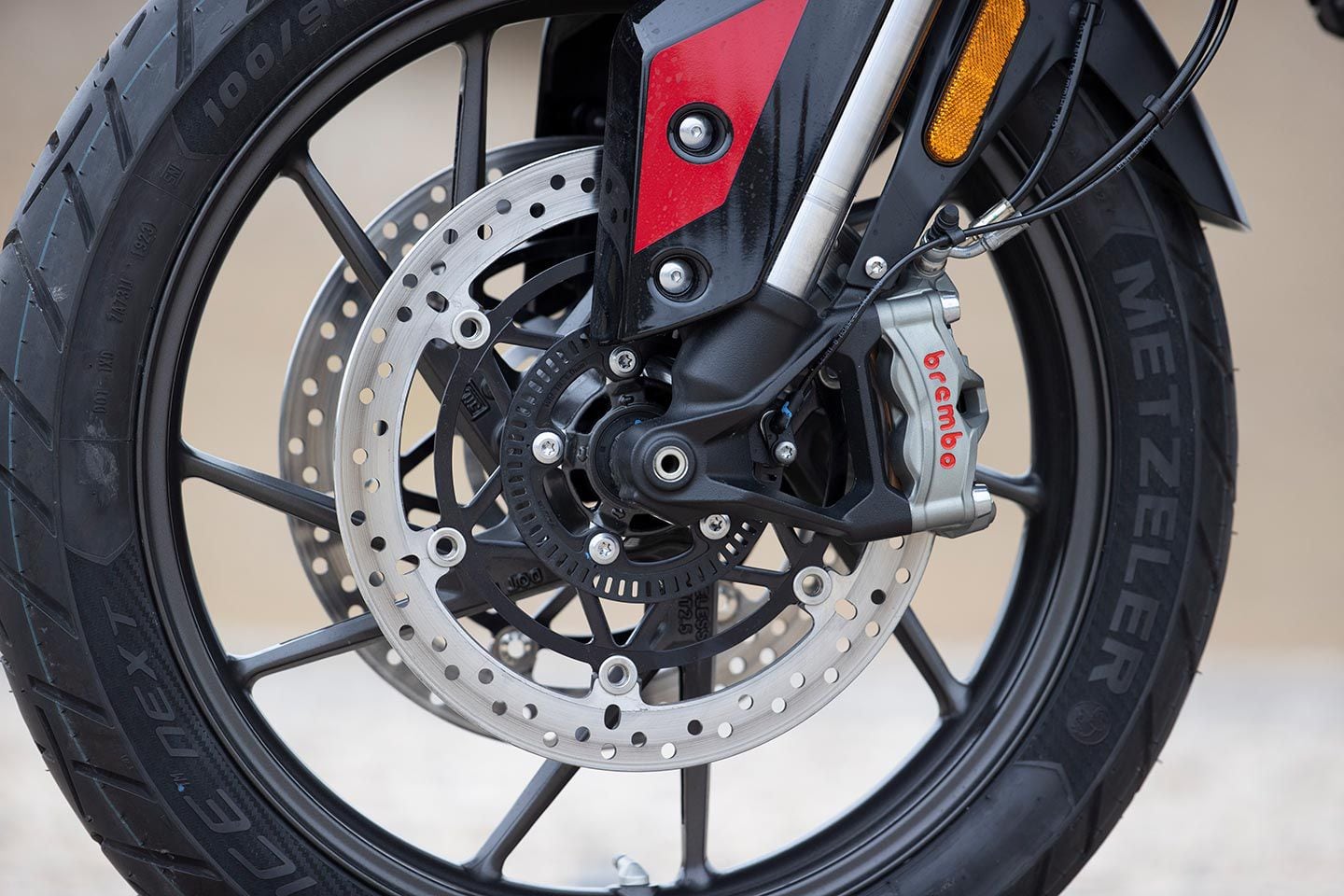

The ride modes are also tied to the ABS settings. In Sport and Road, the Continental MK MIB Evo brake control module links the front 320mm rotors squeezed by four-piston Brembo Stylema Monoblocks to the rear 255mm disc and single-piston Brembo caliper. An overzealous stab at the front lever or rear pedal results in a strong yet metered braking response that keeps the wheels in line and skid free. Off-Road unlinks the brakes and turns off the rear ABS, while in Off-Road Pro the ABS is shut off completely; this is the most important reason to memorize that two-button dance on start-up while riding off-road—you’ll only forget once after trying to slow down a 503-pound ADV on a high-speed dirt road with road ABS.
Brembo four-piston Stylema calipers clamp 320mm dual front discs on the GT Pro and Rally Pro.
Brembo four-piston Stylema calipers clamp 320mm dual front discs on the GT Pro and Rally Pro. (Triumph Motorcycles/)

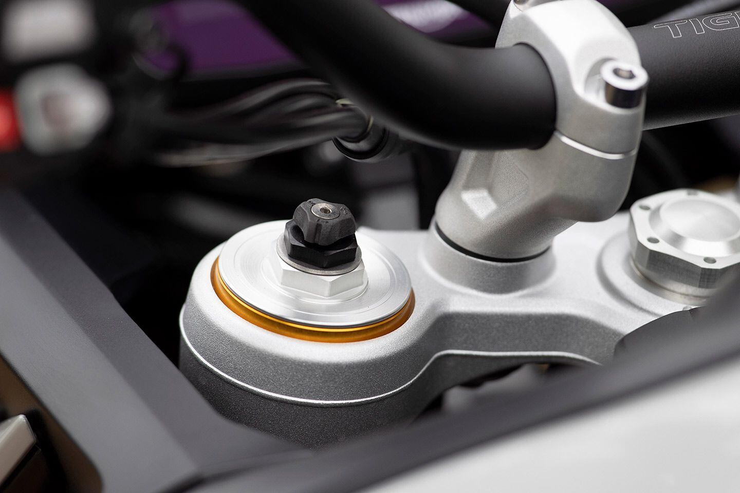

While the engine is shared between all three Tiger 900 models, the GT and Rally models get different suspension, wheels, tires, and frames—all of which gives the GTs and Rally Pro very different handling and capability. Up front, the GT and GT Pro share a 45mm Marzocchi fork that moves through 7.1 inches (180mm) of travel and is adjustable for compression and rebound damping. At the back of the GT, a Marzocchi monoshock is manually adjustable for preload and rebound; the GT Pro gets electronic adjustment of preload and rebound with presets for passenger and load configurations but can be adjusted in the menu to your liking as well. Both GTs have 6.7 inches (170mm) of travel at the rear. Wheels are cast aluminum units in a 19-inch front and 17-inch rear wrapped with Metzeler Tourance Next tires that are meant for on-road performance. Rake is 24.6 degrees with 4 inches of trail.
Front suspension on the Tiger 900 Rally Pro is adjustable for preload, compression, and rebound.
Front suspension on the Tiger 900 Rally Pro is adjustable for preload, compression, and rebound. (Triumph Motorcycles/)
On the Rally Pro, rake is slightly steeper at 24.4 degrees with more trail at 4.6 inches. Wheels are tubeless spoked units with Bridgestone Battlax Adventure tires in 21/17-inch sizing. Suspension is by Showa with a 45mm fork that is adjustable for preload, compression, and rebound with 9.4 inches (240mm) of travel. At the back, a fully adjustable monoshock delivers 9.1 inches (230mm) of travel. All adjustments are manual. This raises the seat height to a minimum seat height of 33.9 inches (34.7 in the high position) over the 32.2/33.1 inches of the GT and GT Pro.

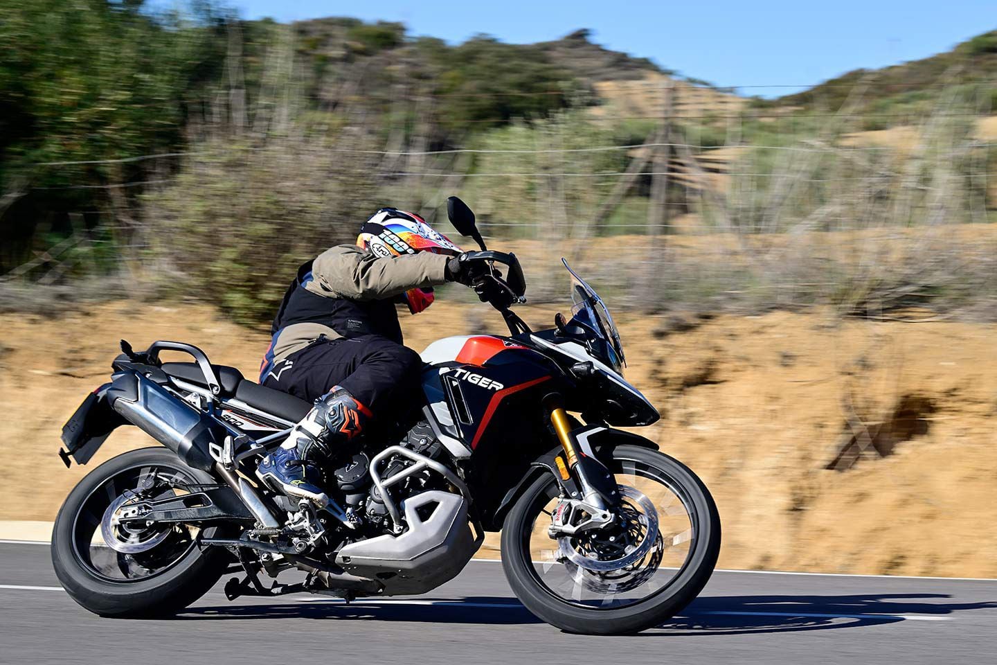

Despite longer suspension travel and a 21-inch front tire, the Tiger 900 Rally Pro is excellent on the street.
Despite longer suspension travel and a 21-inch front tire, the Tiger 900 Rally Pro is excellent on the street. (Triumph Motorcycles/)

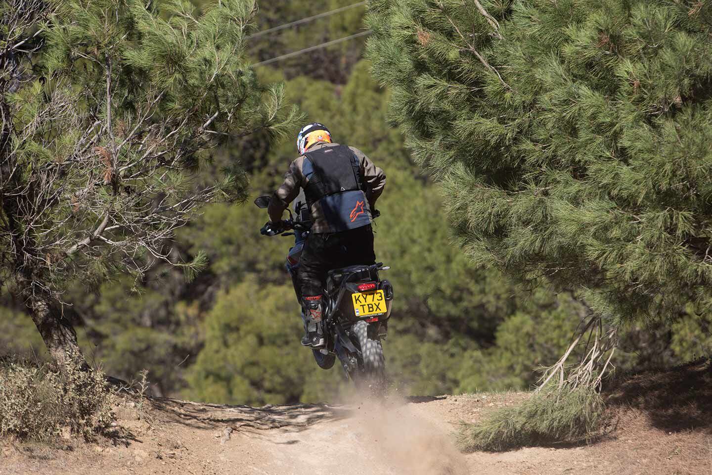

Off-road, the Tiger 900 Rally Pro is just as connected and rock solid. Off-road mode is excellent for fire road shredding with its dirt-specific front ABS confidently slowing the bike without the front wheel completely locking; not once was there a need to completely remove ABS from the front tire for fire roads and two-track. During our very limited time at Triumph Adventure Experience Spain’s off-road training area, Off-Road Pro mode was the ticket, allowing for ultimate braking control on its single-track and small MX-style obstacles.

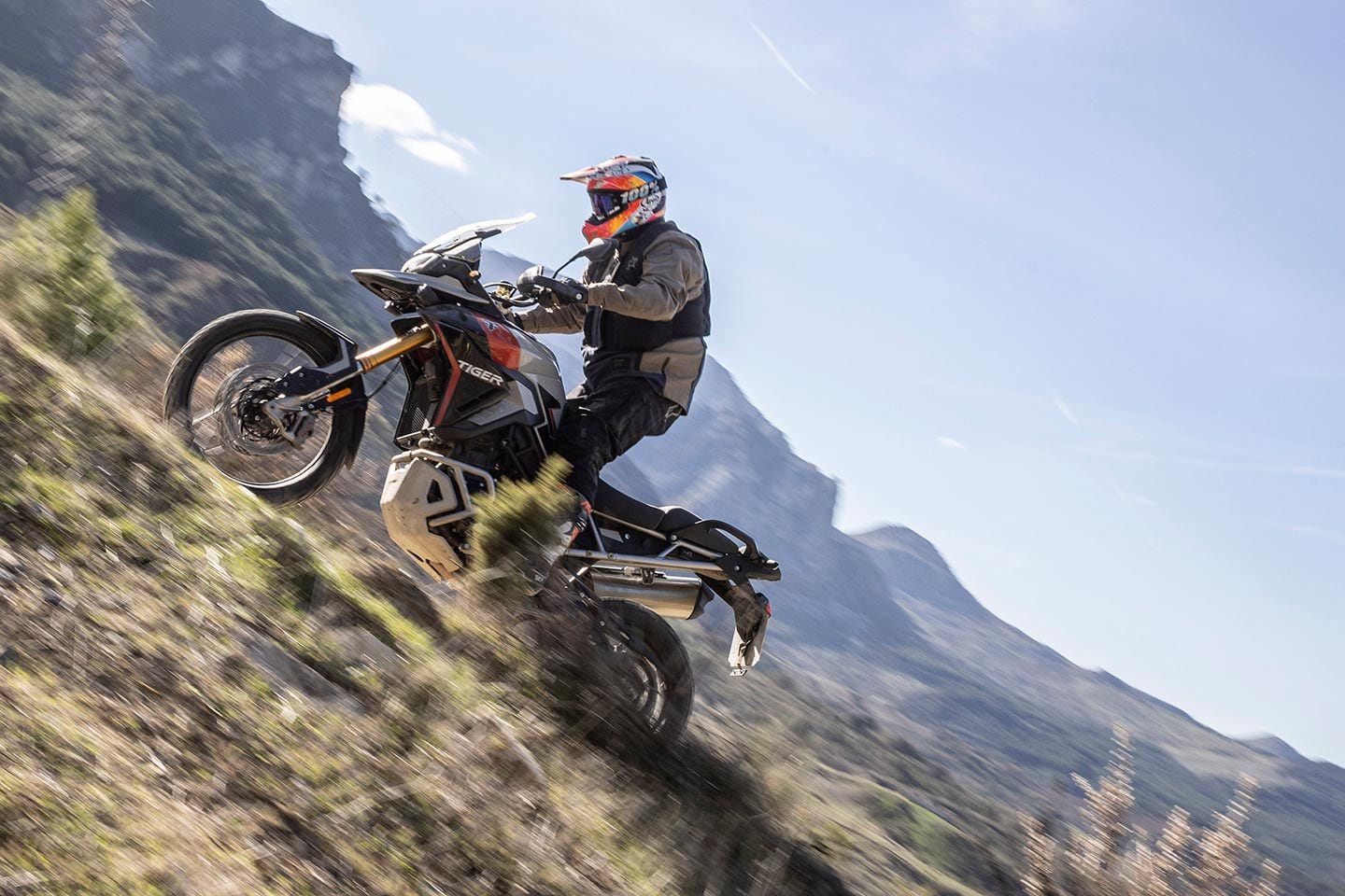

Jumping the Tiger 900 Rally Pro will find the limits of the Showa fully adjustable suspension.
Jumping the Tiger 900 Rally Pro will find the limits of the Showa fully adjustable suspension. (Triumph Motorcycles/)
Right out of the box, suspension settings are dialed in for chunky fire road blasting, sucking up chop and holes without deflection or harshness. Both ends roll over all but the biggest rocks straight and true. Airing out the Rally Pro does find the limits of its 9-plus inches of travel, but even when the end of the travel is reached, the bike remains in control. It’s not the most aggressive ADV in the dirt, but its abilities are at a high level within the class.

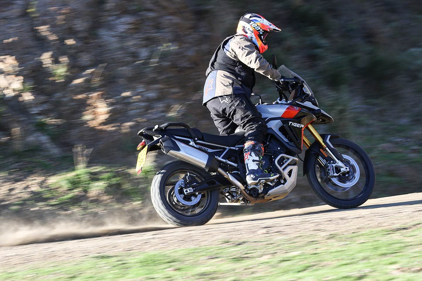

The Tiger 900 Rally Pro is a fire road slayer.
The Tiger 900 Rally Pro is a fire road slayer. (Triumph Motorcycles/)

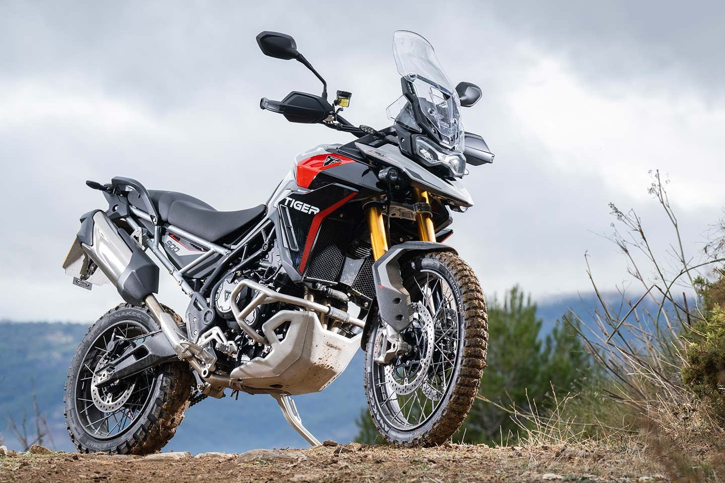

Triumph’s Tiger 900 GT Pro and Rally Pro set a new standard for Hinckley’s middleweight adventure motorcycles. Powered by one of the most engaging engines in the class, both machines now stand toe-to-toe with the competition when the throttle is whacked wide open. The refinement, fit and finish, and overall solid feel are undeniable, and the updated bodywork is modern and clean.
Triumph’s Tiger 900 Rally Pro is the clear winner in the brand’s middleweight ADV lineup.
Triumph’s Tiger 900 Rally Pro is the clear winner in the brand’s middleweight ADV lineup. (Triumph Motorcycles/)
While the GT Pro doesn’t fully live up to the promise of its updated chassis and engine, the Rally Pro is a stunner, nearly negating the need for the GT and GT Pro if you can deal with the taller seat height and no electronic shock adjustment. Triumph doesn’t want its Tiger 900 to be a “well-kept secret” but Tiger 900 Rally Pro owners will nod to the ADV world’s bandwagon chasers and give a sly smile, for they know how good it can get. You should look into joining the club, initiation is $17,395.
2024 Triumph Tiger 900 Rally Pro ($17,395).
2024 Triumph Tiger 900 Rally Pro ($17,395). (Triumph Motorcycles/)

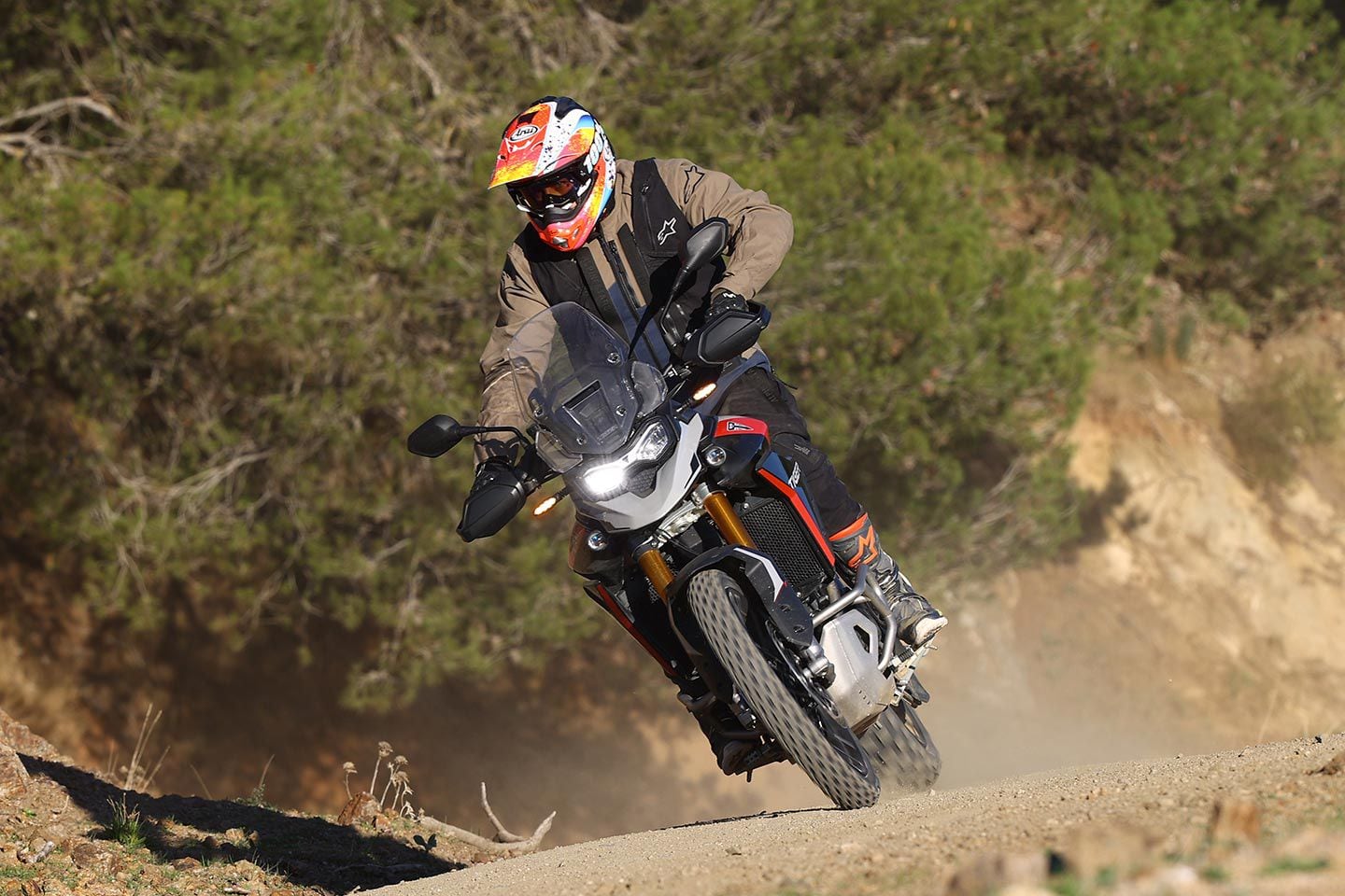

Off-road ABS is well calibrated for fire road surfaces.
Off-road ABS is well calibrated for fire road surfaces. (Triumph Motorcycles/)
