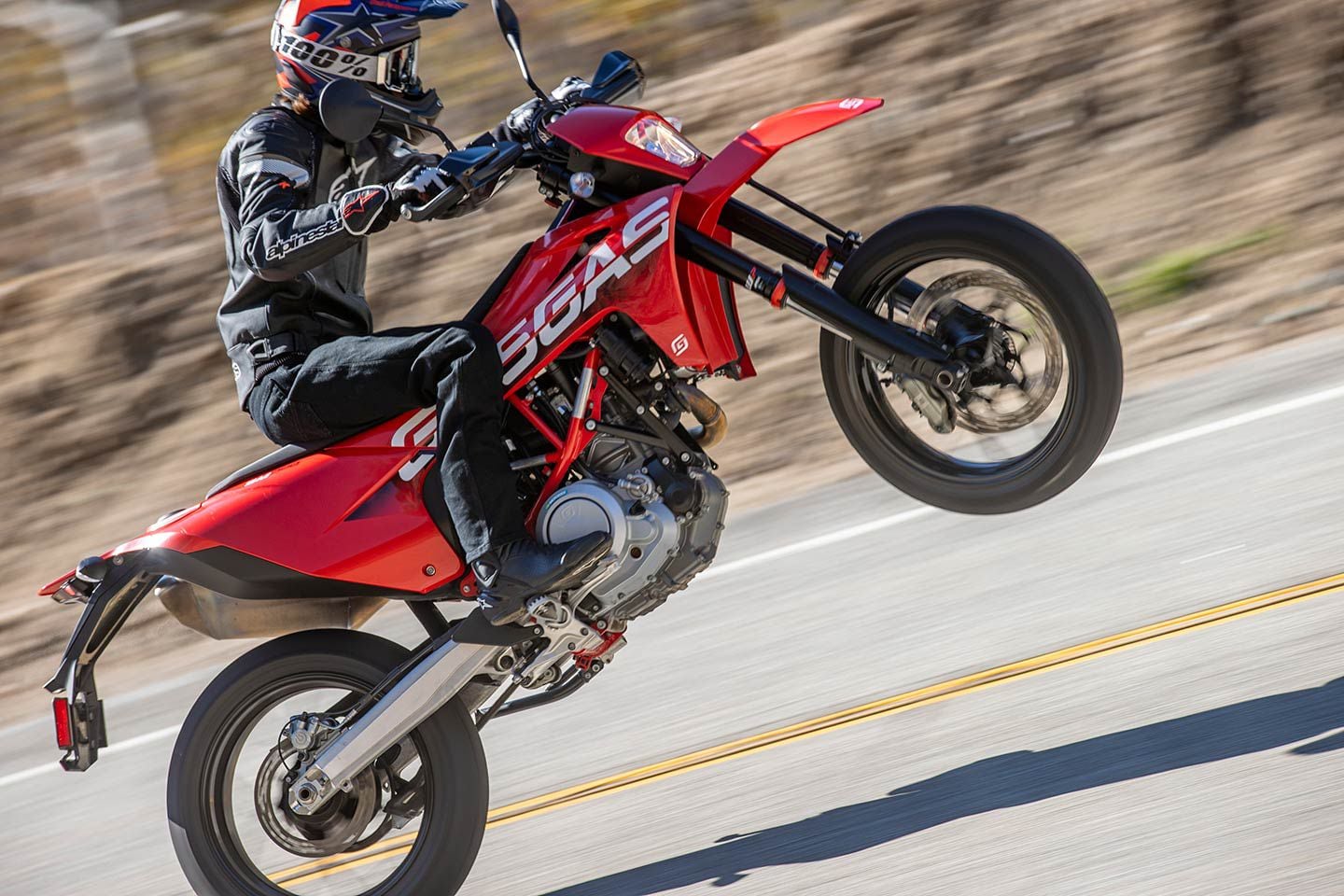

The SM 700 is the only supermoto in the GasGas product lineup.
The SM 700 is the only supermoto in the GasGas product lineup. (Jeff Allen/)

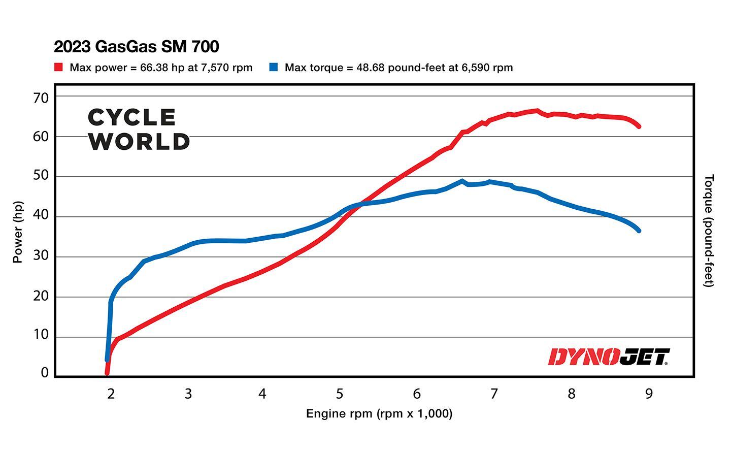

2023 GasGas SM 700 Dyno Chart.
2023 GasGas SM 700 Dyno Chart. (Robert Martin/)
Before hitting our Dynojet 250i dynamometer, we put the big-bore supermoto on our automotive scales, which registered 349 pounds with a full tank of fuel. On the Cycle World dyno, the 2023 GasGas SM 700 produced 66.4 hp at 7,600 rpm and 48.7 lb.-ft. of peak torque at 6,600 rpm. For reference, the 2019 KTM 690 Enduro R (with a similar engine) produced 59.2 hp at 8,250 rpm and 43.4 lb.-ft. of peak torque at 6,800 rpm on the Cycle World dyno. The LC4 engine is one of the most entertaining in motorcycling. Its acceleration and torque from the midrange to its roughly 9,000 rpm redline are awesome. We’d love a little bit more performance from the bottom-end, but the engine’s large displacement and dual counterbalancers give it the legs to run comfortably at highway speeds.
