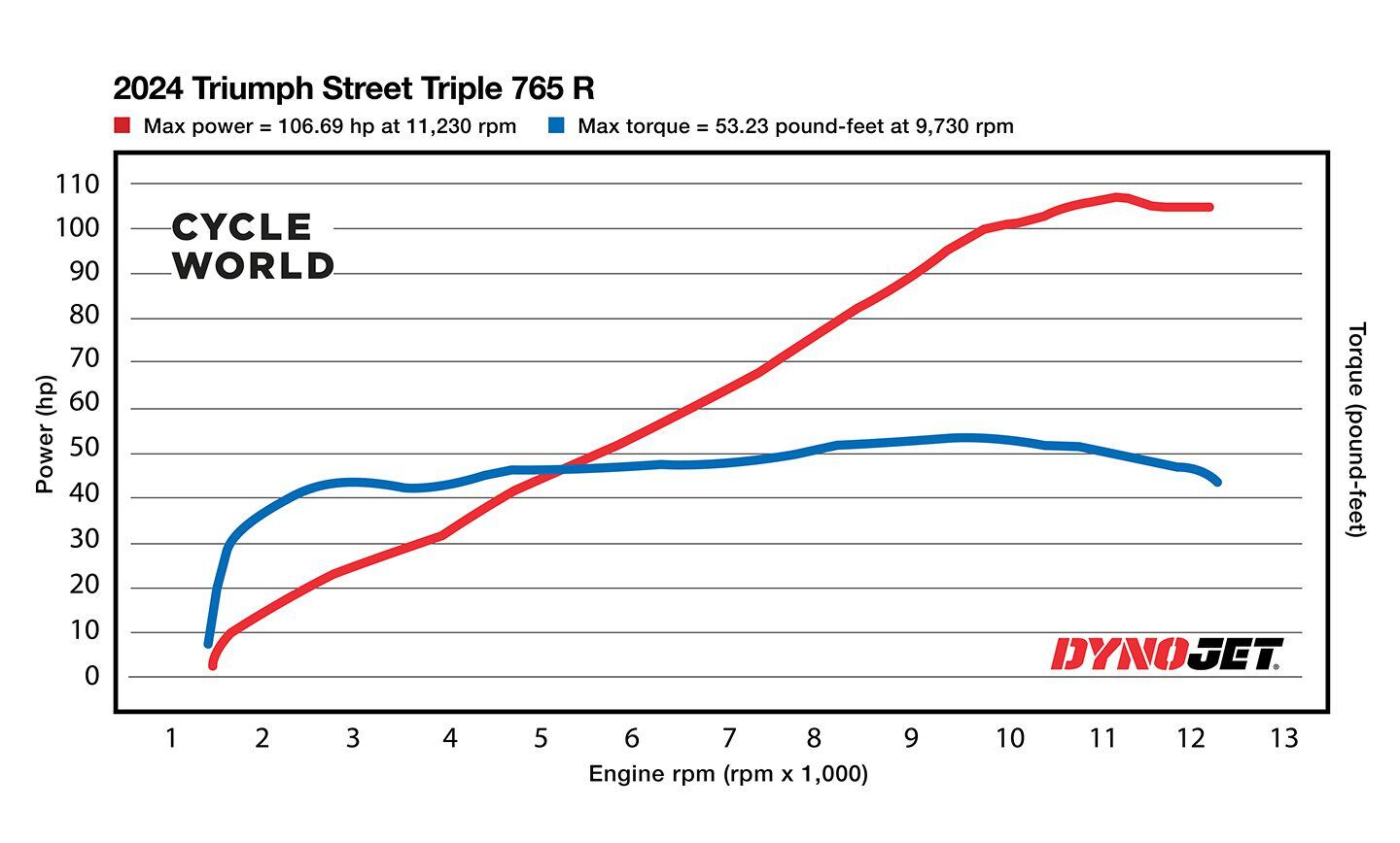

2024 Triumph Street Triple 765 R Dyno Chart.
2024 Triumph Street Triple 765 R Dyno Chart. (Robert Martin/)
Before hitting our in-house Dynojet 250i dynamometer, the 2024 Triumph Street Triple 765 R weighed 419 pounds on our automotive scales. On the Cycle World dyno, the roadster produced 106.7 hp at 11,230 rpm and 53.2 lb.-ft. of torque at 9,730 rpm. Looking at the picturesque power and torque curves, what more can be said? The engine’s extremely linear power delivery and flat torque curve give the Street Triple flexibility at any rpm.
