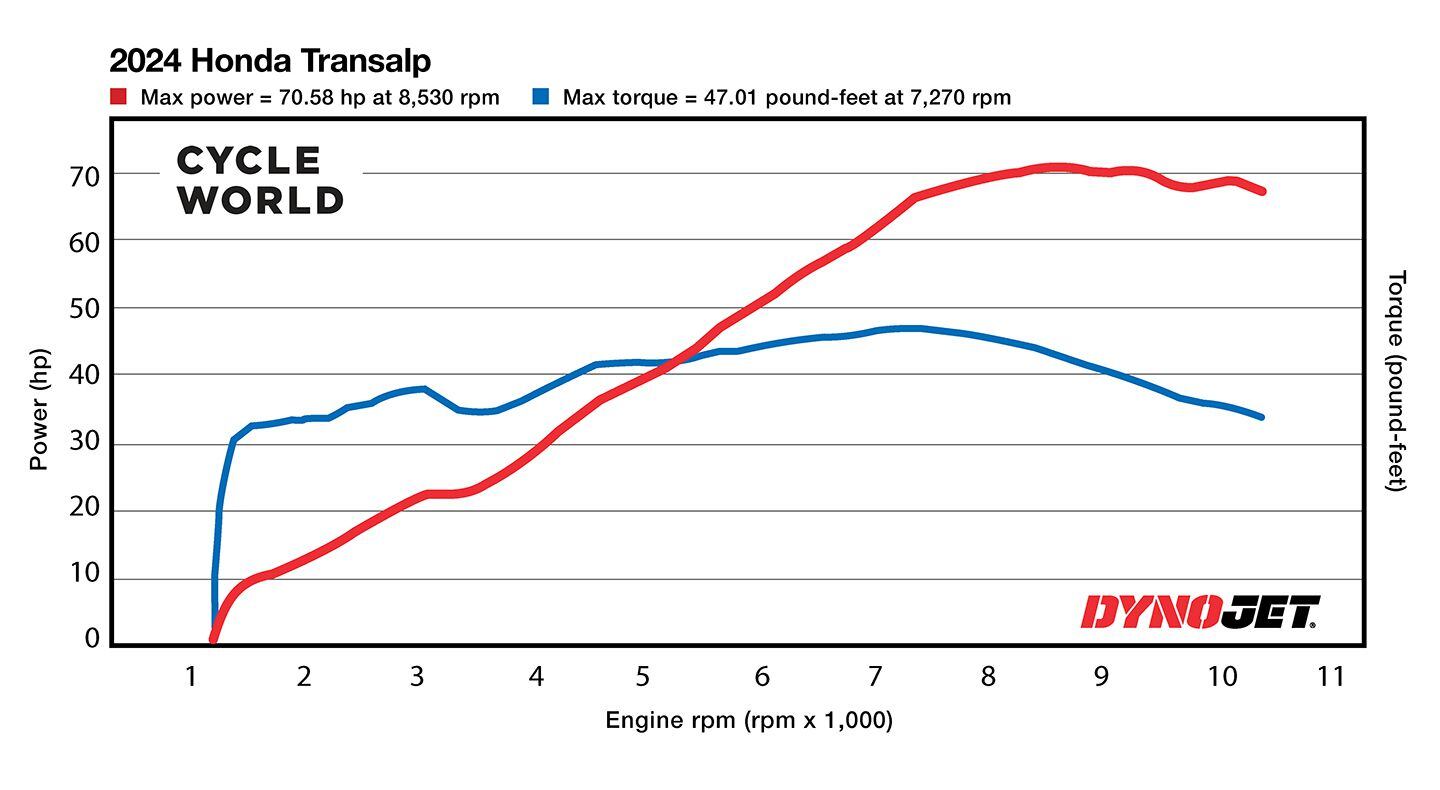

2024 Honda Transalp Dyno Chart.
2024 Honda Transalp Dyno Chart. (Robert Martin/)
On the Cycle World dyno, the 2024 Honda Transalp produced 70.58 hp at 8,530 rpm and 47.01 lb.-ft. of torque at 7,270 rpm. For reference, the 2023 Suzuki V-Strom 800DE produced 72.21 hp and 50.15 lb.-ft. of torque and the 2023 Yamaha Ténéré 700 produced 61.68 hp and 42.45 lb.-ft. of torque. The Transalps torque curve dips around 3,500 rpm, but at the top-end, the bike makes nearly peak horsepower all the way up to its 10,000-plus redline. The Honda does not have the same torquey feel as the Suzuki, but when revving up the 755cc parallel twin and making use of every rpm, the Transalp is very rewarding.
