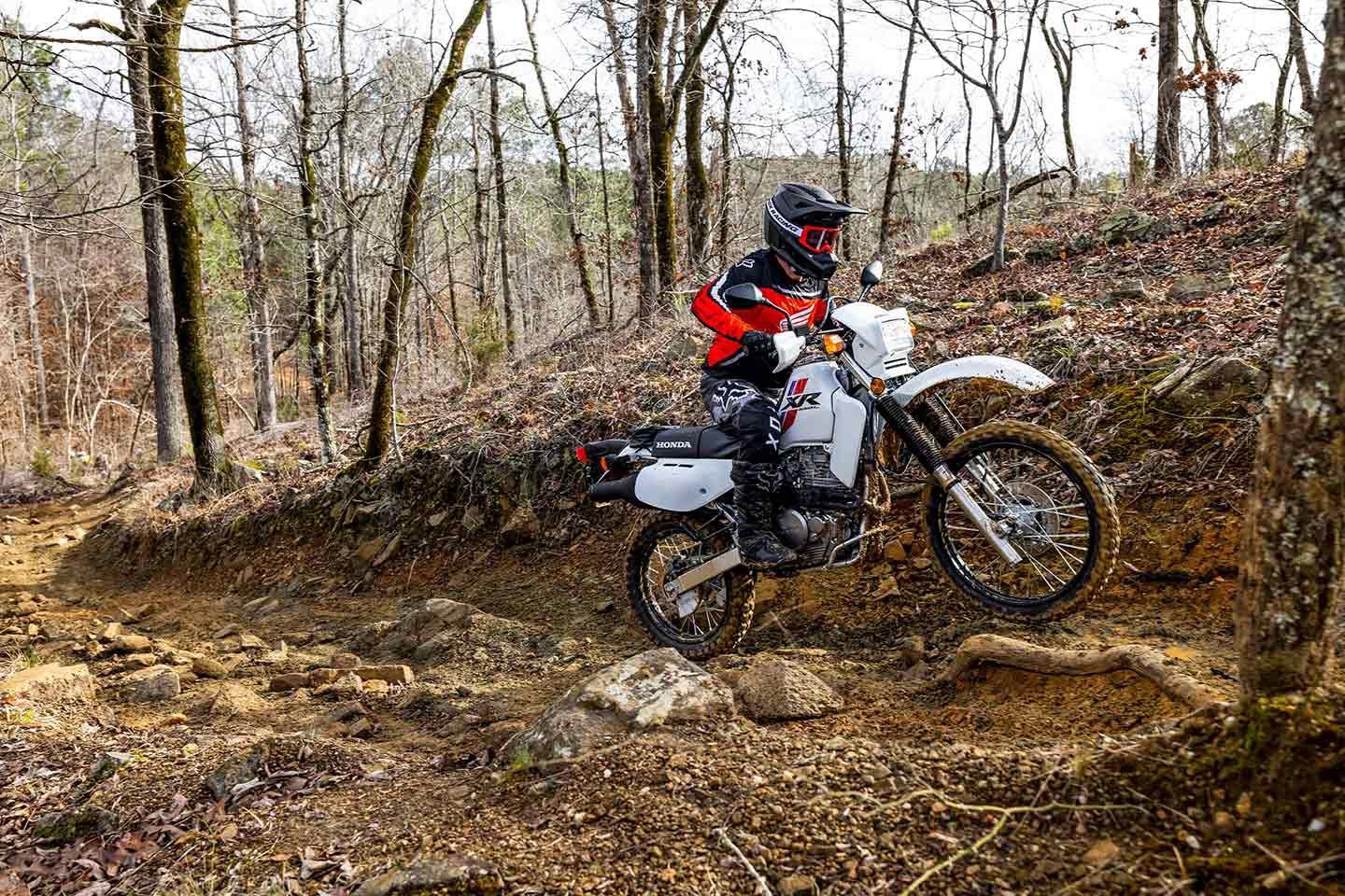

In sum, the XR650L is the most off-road-worthy of the bunch; it’s the lightest and has the most ground clearance, but also the tallest seat.
Compared to the competition, the big XR-L benefits from loads of ground clearance.
Compared to the competition, the big XR-L benefits from loads of ground clearance. (Honda/)

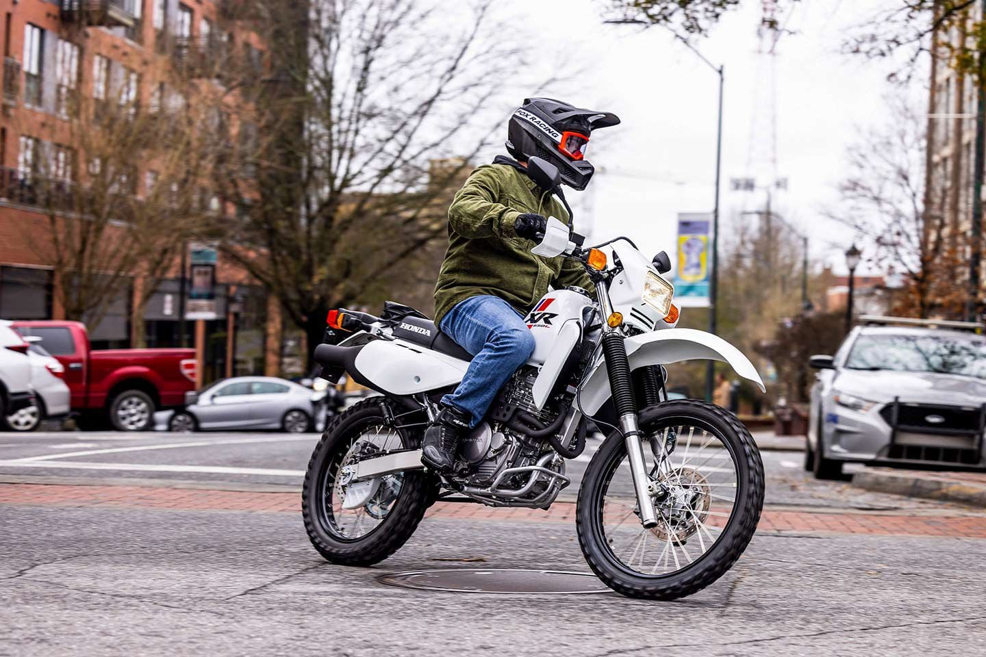

A tall-in-the-saddle seating position means the XR-L affords the rider a great view over cars. The downside is inseam-challenged riders will struggle with the 37-inch seat height.
A tall-in-the-saddle seating position means the XR-L affords the rider a great view over cars. The downside is inseam-challenged riders will struggle with the 37-inch seat height. (Honda/)

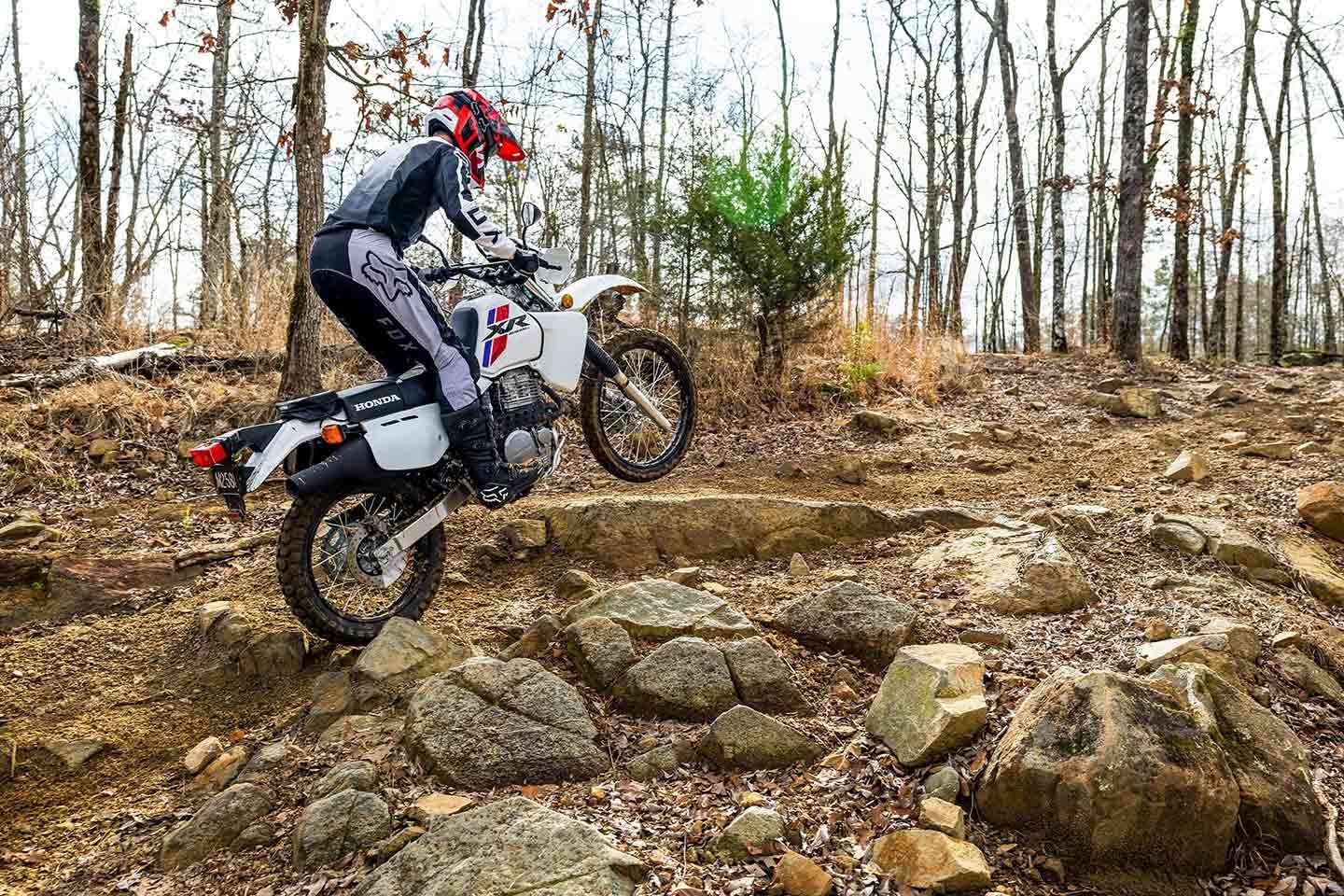

Those elephant ears on the sides of the fuel tank direct air to the cylinder at highway speeds in the interest of long-term reliability. They’ve always looked goofy. Good looks are big Acerbis or IMS tank away.
Those elephant ears on the sides of the fuel tank direct air to the cylinder at highway speeds in the interest of long-term reliability. They’ve always looked goofy. Good looks are big Acerbis or IMS tank away. (Honda/)

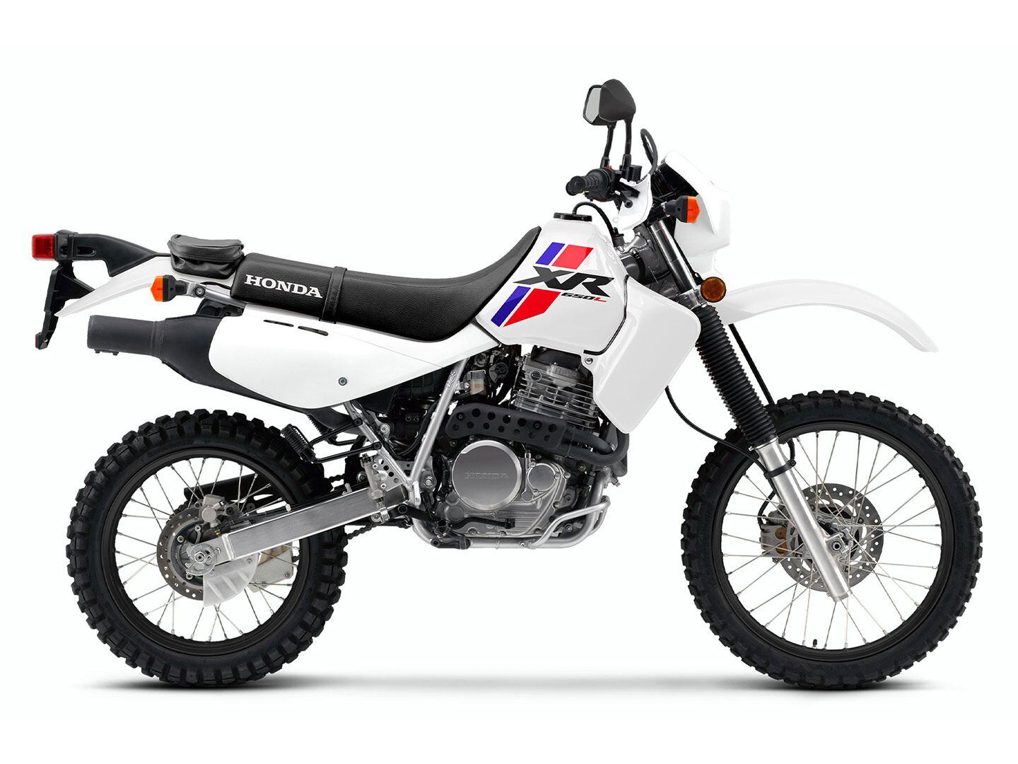

The XR650L may not be a lightweight dual sport, but it’s as robust as a sledgehammer.
The XR650L may not be a lightweight dual sport, but it’s as robust as a sledgehammer. (Honda/)

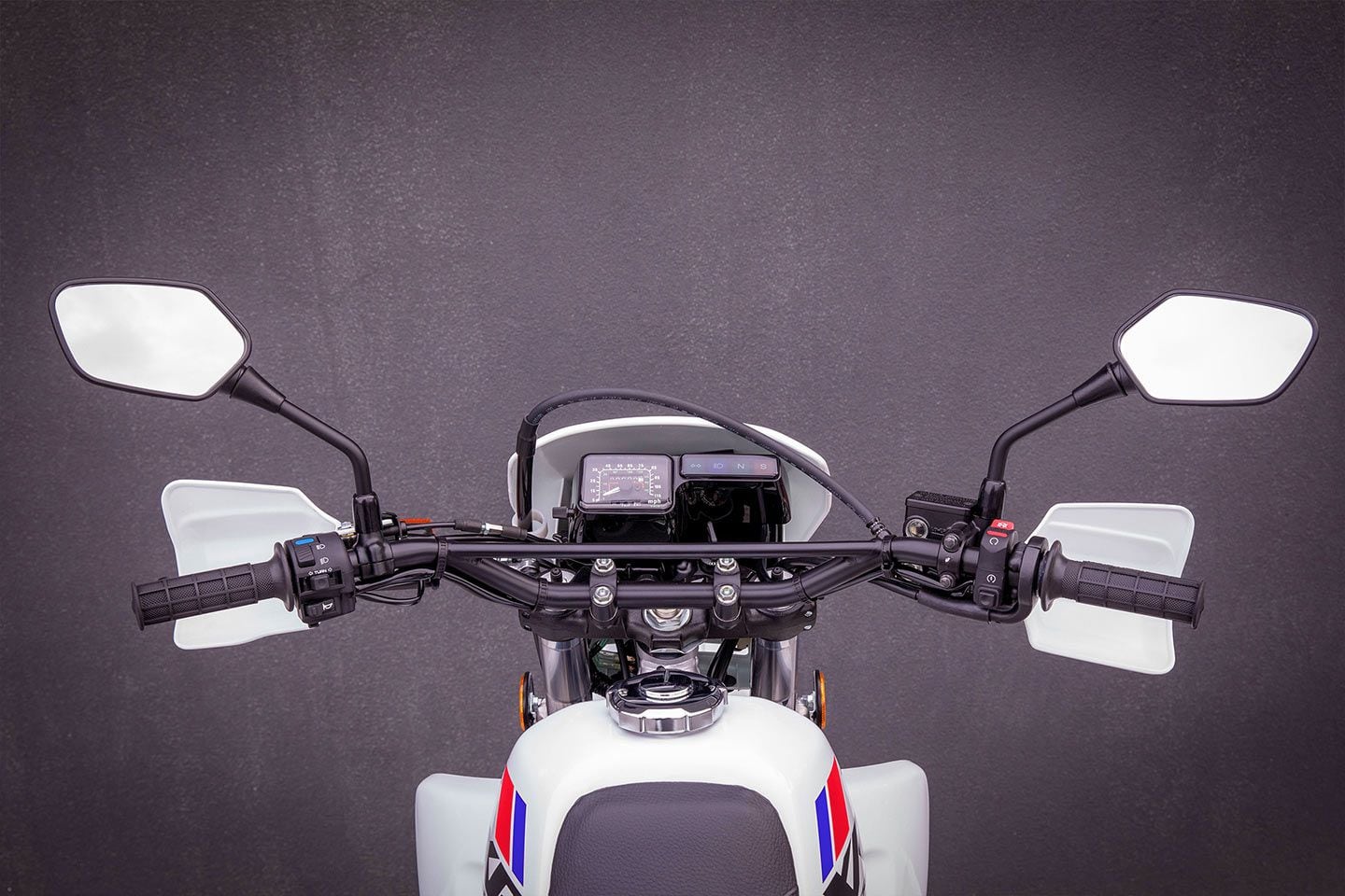

The bare-bones cockpit has nothing superfluous. The speedometer goes to 115 mph. The motorcycle’s top speed is pretty close to that as well.
The bare-bones cockpit has nothing superfluous. The speedometer goes to 115 mph. The motorcycle’s top speed is pretty close to that as well. (Honda/)
Electronics? What electronics? Aside from what’s required for ignition and lighting, the XR650L is devoid of modern rider aids, fuel injection, heated grips, etc.
