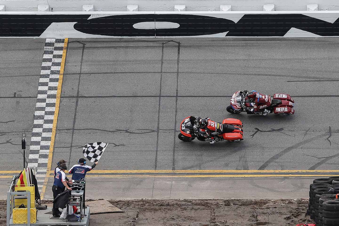

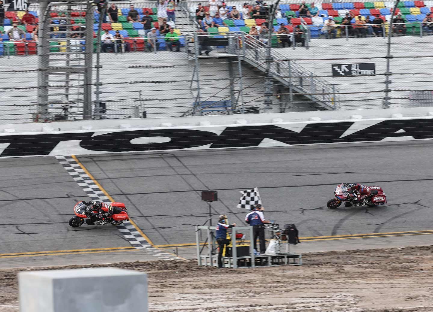

The bare bones of Daytona’s two six-lap Baggers races are that Kyle Wyman (Factory Harley-Davidson Race Team) won them both from the chicane on the last lap, and that second in both cases was fast learner Troy Herfoss on an S&S factory Indian. Herfoss is fresh off his third Australian Superbike championship and had never seen Daytona.

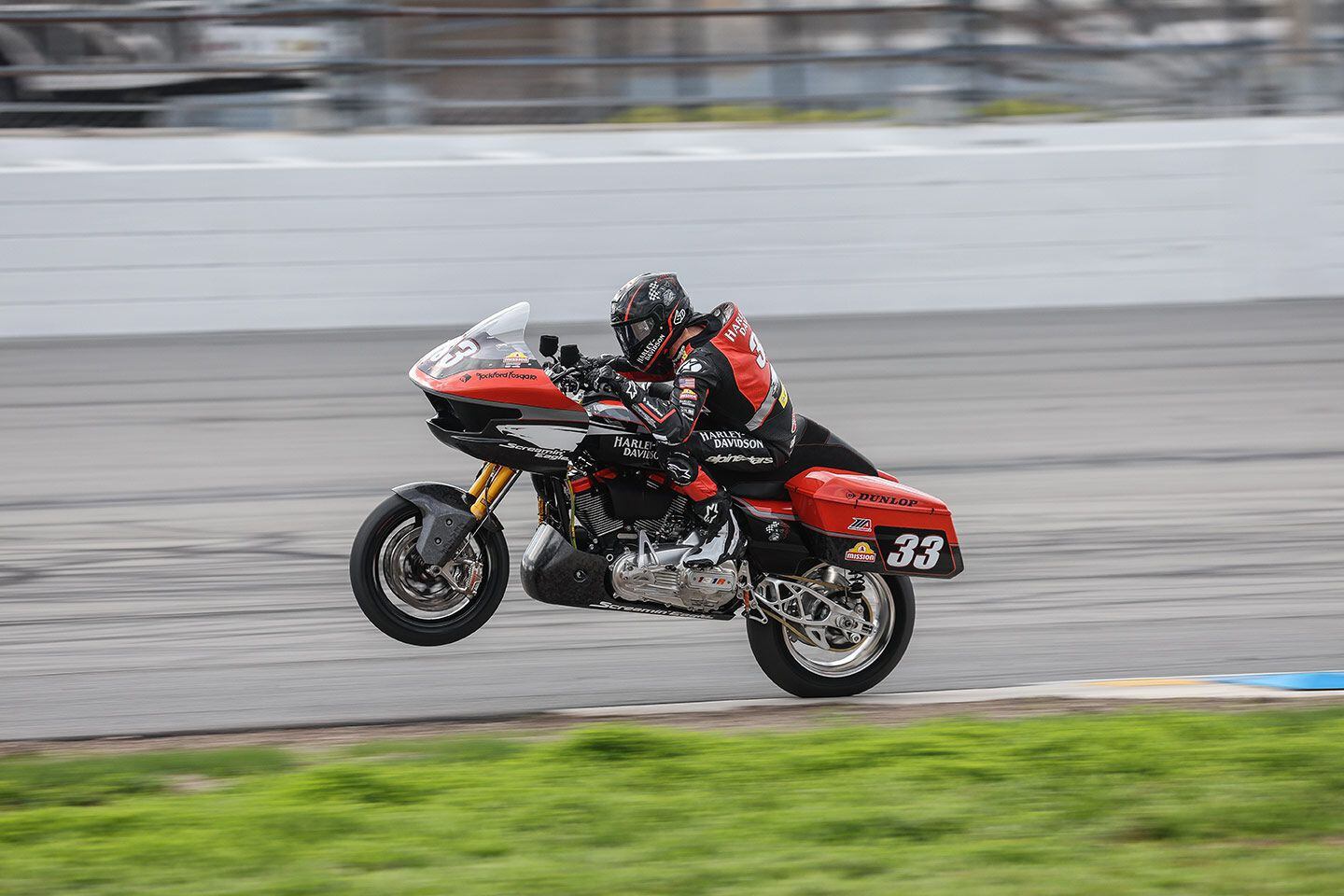

H-D’s Kyle Wyman took double wins in Daytona.
H-D’s Kyle Wyman took double wins in Daytona. (Harley-Davidson/)
Last year the Indians were dragging their frames (just ahead of the crankcase) in corners, but amended rules now allow machining to correct this. Before this, Indian coped by raising ride height, but some riders couldn’t hold up such a tall bike at rest. Remember that these bikes were originally designed for a maximum lean angle of 32 degrees!
It looks like both companies have updated their front “streamlining” to make it less of an “air dam” (one rider’s term for such mandatory obstructions).

In both races, Herfoss appeared to have the win in hand approaching the V-shaped chicane, but inexperience with “Daytona chicane-craft” defeated him both times. In the second case (Saturday’s race), he braked late for the chicane, and ran wide in the right-hander, snatching a quick look over his left (outside!) shoulder. That was all the invitation Wyman needed to pass inside and exit onto the banking with the lead. He later said, “He had a friggin’ mile and he gave it to me!”
Herfoss took second in both KOTB races at Daytona.
Herfoss took second in both KOTB races at Daytona. (Brian J. Nelson/MotoAmerica/)
Herfoss recited forthrightly, “I overshot the chicane.” It will be interesting to see how this man’s ability to gain ground through twisties will reward him. He adapted quickly to the completely strange-to-him bike, to a track he’d never before seen, and to a crew with whom he’d never worked.
