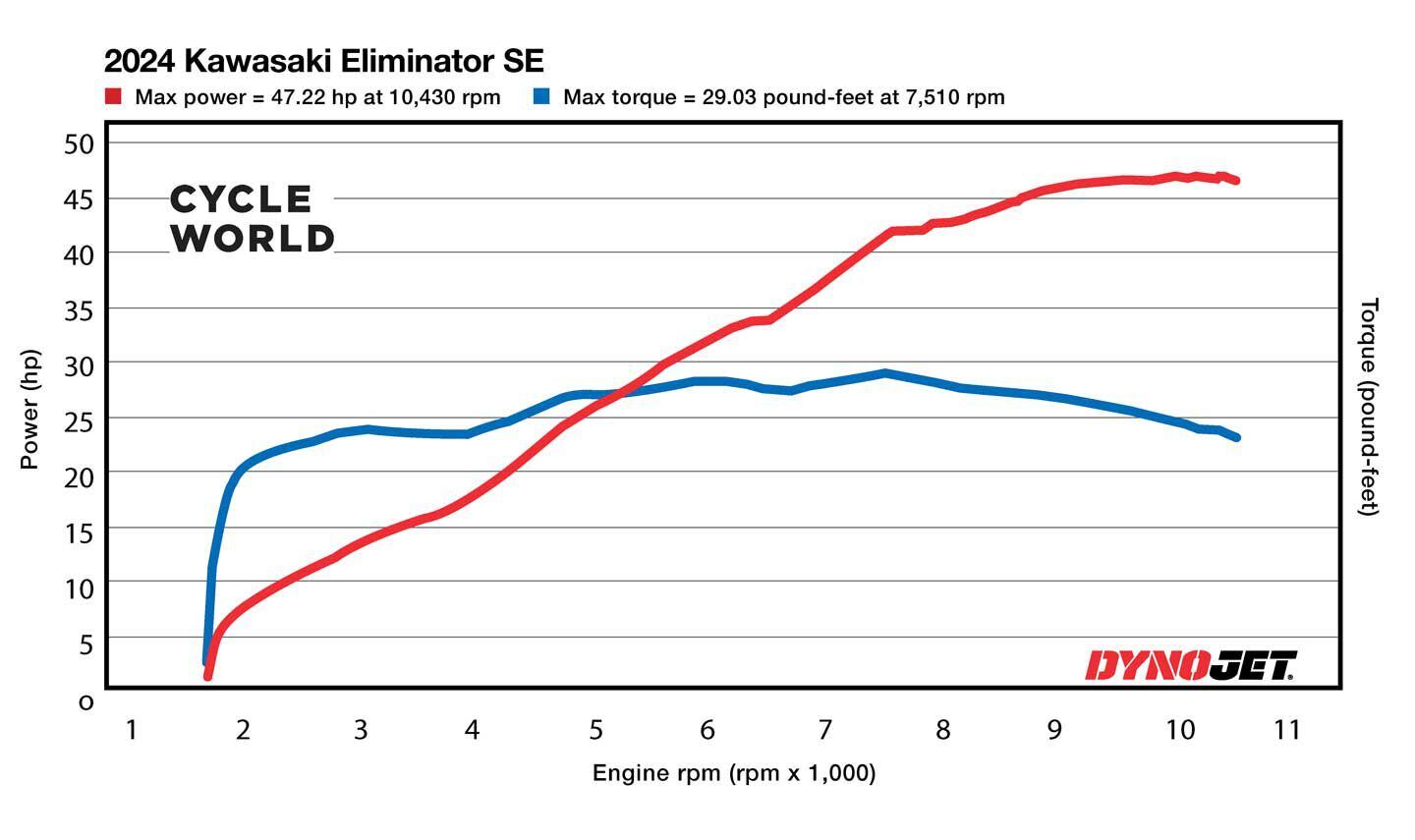

2024 Kawasaki Eliminator SE Dyno Chart.
2024 Kawasaki Eliminator SE Dyno Chart. (Robert Martin/)
Before hitting our in-house Dynojet 250i dynamometer, the 2024 Kawasaki Eliminator SE weighed 395 pounds on our automotive scales. On the Cycle World dyno, the Eliminator produced 47.22 hp at 10,430 rpm and 29.03 lb.-ft. of torque at 7,510 rpm. For reference, the 2019 Kawasaki Z400 produced 44.08 hp at 9,830 rpm and 25.12 lb.-ft. of torque at 8,250 rpm.
The increased stroke of 6.8mm in the small-displacement twin was in an effort to increase low-end torque, according to Kawasaki, and that is clearly demonstrated in our testing. The 2024 Kawasaki Eliminator offers more horsepower than the previous iteration of this engine as well as providing riders with more available torque at a lower rpm. But despite the changes in displacement, the now 451cc parallel twin still maintains the smooth and linear power delivery as before.
