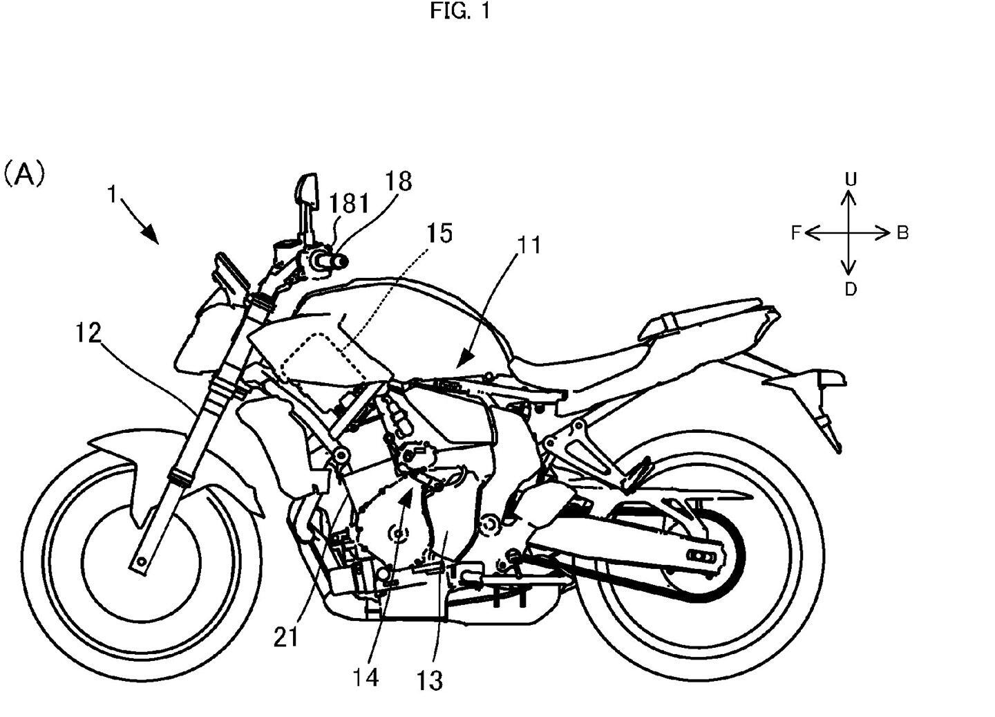

The illustration of a MT-07 shows the bar-mounted shift buttons (181).
The illustration of a MT-07 shows the bar-mounted shift buttons (181). (Yamaha/)
The system operates as you might expect. There are up and down shift buttons on the left-hand bar (marked 181) on the patent illustrations, and a pair of electric actuators fitted just above the transmission. One on the left, to operate the shifter, and one on the right to control the clutch. A motor control module translates the demands from the bar-mounted buttons into operations of the clutch and shifter to give smooth gear changes, as well as controlling the clutch for getaways and stops. Yamaha’s patent suggests that the system could also be used in a fully automatic mode, controlling the timing of gearshifts as well as the mechanics of making them happen.

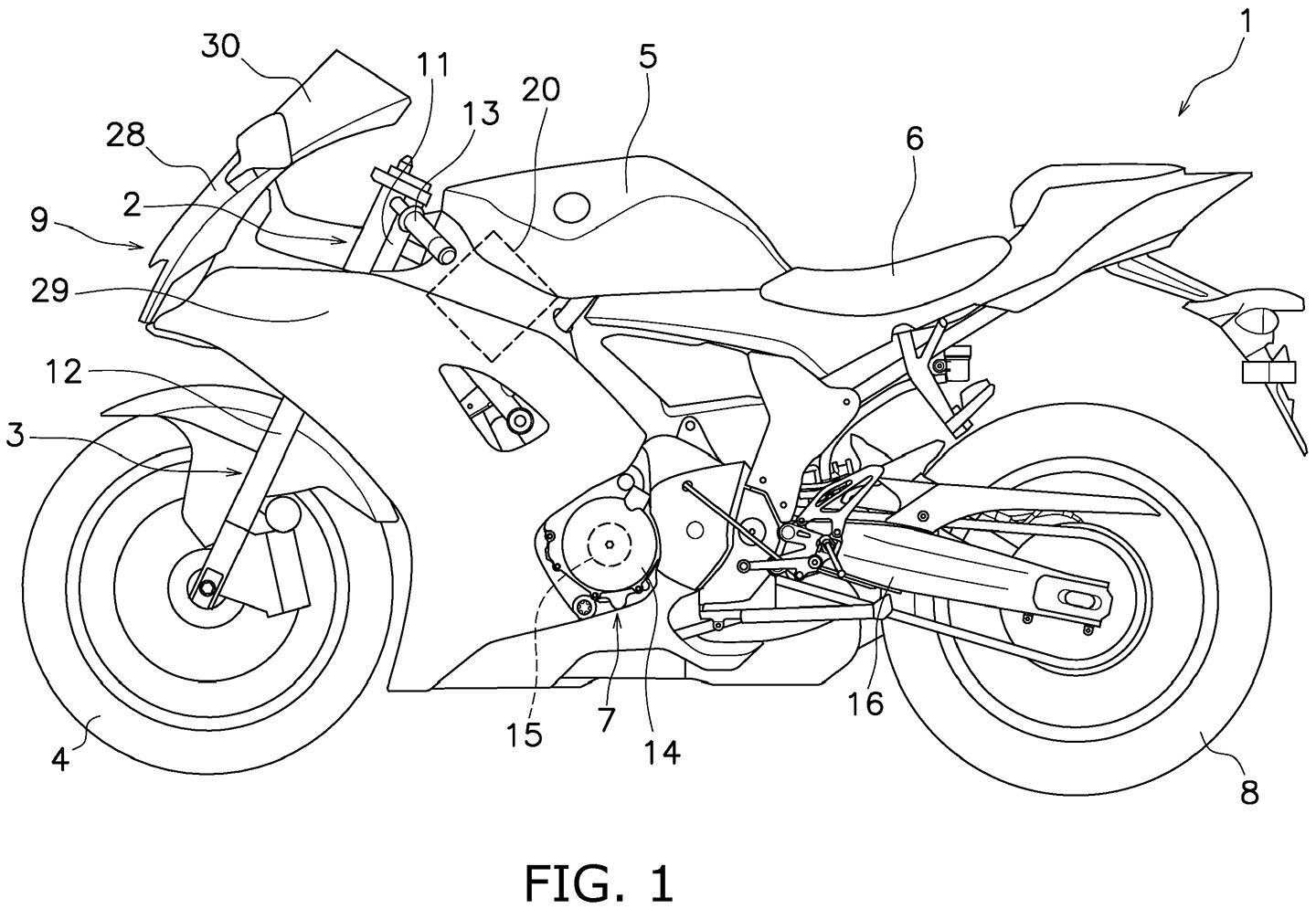

A second patent shows a Yamaha YZF-R7 as an application.
A second patent shows a Yamaha YZF-R7 as an application. (Yamaha/)

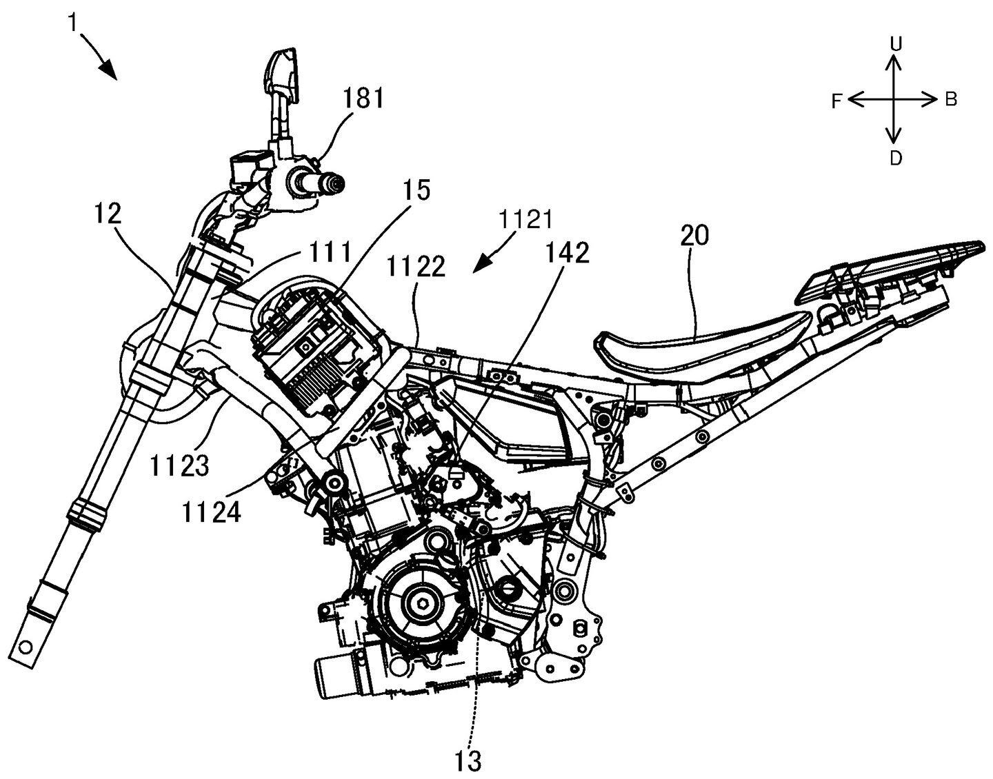

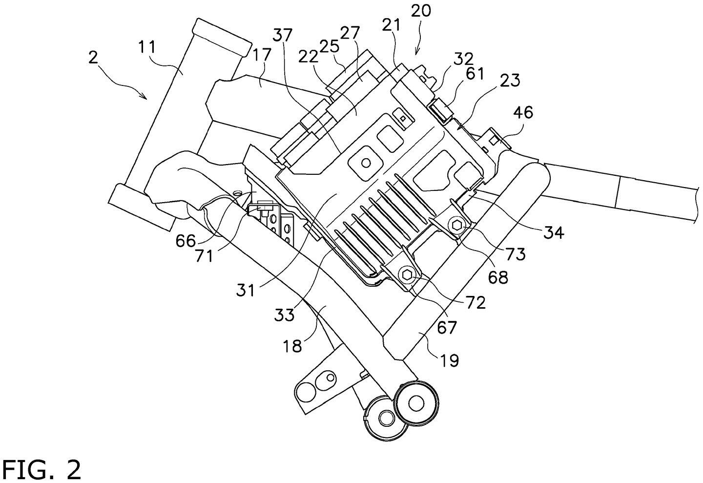

The control unit is mounted on the outside of the left-hand frame rail, fed cooling air by a scoop on the side of the fuel tank. A second control unit—its purpose not revealed—is mounted in the same position but on the right-hand side of the frame. The new transmission control unit also appears in another recent patent application by the same author. Again, the patent specifically relates to its mounting position on the bike, but this time it’s illustrated on a Yamaha YZF-R7 rather than an MT-07. In this second patent there’s no mention of the control unit’s purpose, only its mounting position, so the inclusion of a gearshifter on the R7 drawing (but no clutch lever) isn’t relevant to the patent text.
As well as the semi-auto shift, the MT-07 illustrated in the patent shows some distinct differences to the generations seen so far. The bodywork, for instance, while only roughly sketched, doesn’t align with the current MT-07 or its predecessors, featuring a different seat and new scoops on the sides of the tank to feed cooling air to the control units. The radiator cowls also appear to be slightly different, as does the front fender, and most significantly the fork is an upside-down unit (as used already on the R7) instead of the MT-07′s conventional design.
The electronic control units need cooling, so they are placed where air can be ducted to them.
