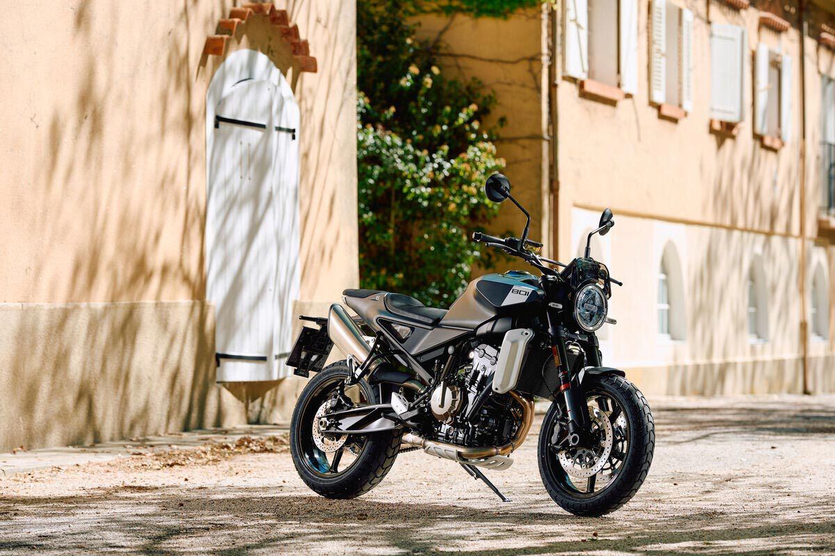

Husqvarna’s 2024 Svartpilen 801 is a totally different beast with twin-cylinder power.
Husqvarna’s 2024 Svartpilen 801 is a totally different beast with twin-cylinder power. (Husqvarna/)
Ever since Pierer Mobility AG acquired Husqvarna back in 2013, modern Huskies have smartly utilized KTM’s platforms and delivered their own spin on those motorcycles. Looking to the travel and street sectors, bikes like the Norden 901 and 701 Supermoto/Enduro were logical crossovers borrowing from those successful families. But the Svartpilen and Vitpilen naked models really have their own identities that set them apart, both visually and in terms of their target markets.
Based on KTM’s 790 Duke, the new Svartpilen 801 gives off an entirely different vibe.
Based on KTM’s 790 Duke, the new Svartpilen 801 gives off an entirely different vibe. (Husqvarna/)
As much as we loved the Svartpilen 701, its single-cylinder engine always left us wondering how good the bike could be with a twin in it. For 2024, Husqvarna has answered that question and delivered the Svartpilen 801, which is powered by the 799cc version of the LC8c borrowed from KTM’s 790 Duke.
But that still left one question remaining: Would this new model, with its dramatically upgraded engine, deliver the performance to put it onto a completely different playing field of competitors?

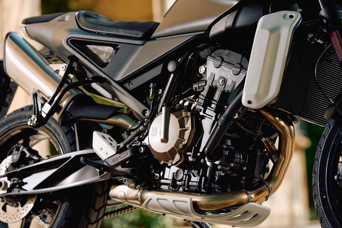

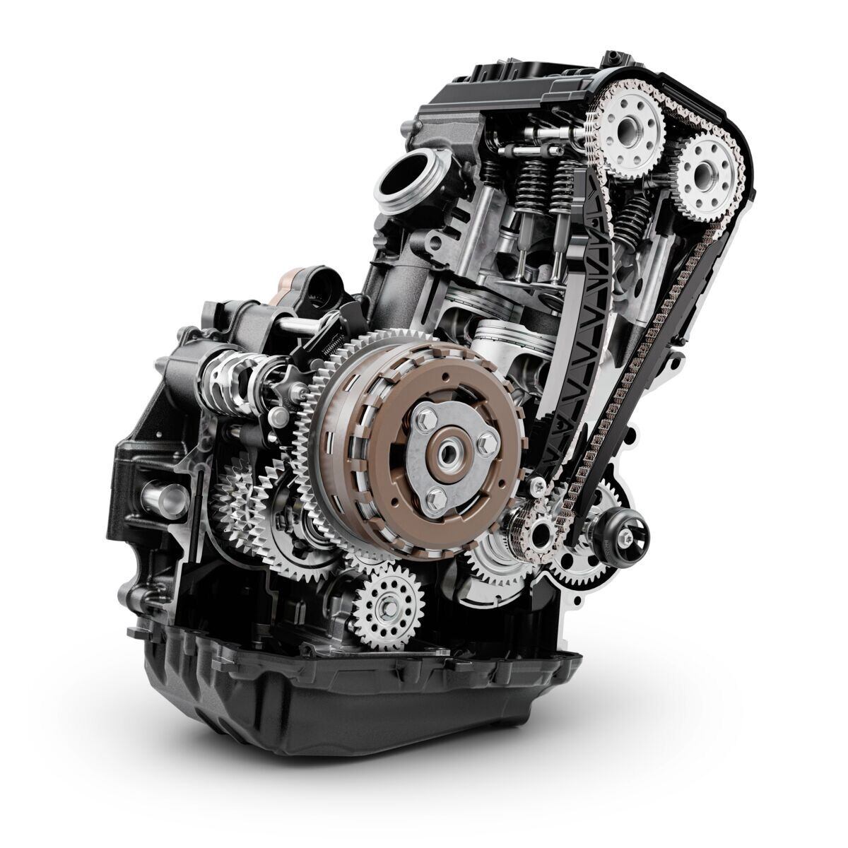

LC8c Engine
There isn’t a whole lot of mystery behind the engine that powers the Svartpilen 801. As mentioned, under Pierer Mobility, platforms and powerplants are shared among KTM, Husqvarna, and GasGas. The LC8c in this new model is shared with KTM’s 790 Duke. Another important note is that this engine was reintroduced in the not-so-distant past and is manufactured by KTM’s partner CFMoto in China, which also uses it in some of its models.
The LC8c that powers the Svartpilen is the 799cc version that is used in the KTM 790 Duke.
The LC8c that powers the Svartpilen is the 799cc version that is used in the KTM 790 Duke. (Husqvarna/)
The 799cc liquid-cooled parallel twin has double-overhead cams with four valves per cylinder. Bore and stroke measure 88.0 x 65.7mm with lightweight forged aluminum bridged-box pistons and a 12.5:1 compression ratio. The crankcase is high-pressure cast aluminum which helps keep the wall thickness to a minimum and the overall weight of the engine down to 114 pounds. Cylinders are a sleeveless aluminum design with Nikasil coating. The engine has semi dry-sump lubrication and has 15,000-kilometer (9,320-mile) service intervals. Keeping it smooth are a pair of balance shafts, one in front of the crankshaft and the other between the camshafts.
The cylinder head features a pair of assembled camshafts that are lighter than one-piece forged units. Steel intake and exhaust valves measure 36 and 29mm, respectively, and are actuated by diamond-like carbon-coated finger followers. A pair of 46mm throttle bodies feed mixture to the engine and are controlled by a ride-by-wire throttle. Spent gases pass into a pre-muffler chamber concealed between the engine and swingarm that houses the catalytic converters, and then head for a stainless-steel silencer.
The LC8c is compact, light, and produces 105 hp.
The LC8c is compact, light, and produces 105 hp. (Husqvarna/)
It doesn’t take long to appreciate the LC8c’s performance. Husqvarna claims 105 hp at 9,250 rpm with 64.0 lb.-ft. of peak torque 6,500 rpm. These numbers are obviously down a bit when compared to some of the larger-displacement versions of the LC8c like the “890″ and “990″ versions, but this engine is a perfect fit in this bike.

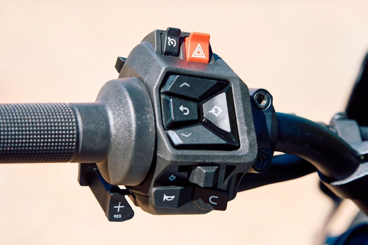

The left-bar control pod provides intuitive menu navigation.
The left-bar control pod provides intuitive menu navigation. (Husqvarna/)
Core to the standard suite are three ride modes: Sport, Street, and Rain. Within these modes are preset parameters for MTC (traction control) and ABS, which utilize a six-axis IMU to enable lean-sensitive adjustments. Also built in are predetermined settings for wheelie control, engine-brake control, and throttle response. Sport is the least intrusive with lively throttle response, reduced TC, and Supermoto ABS (allows the rear to be locked) that isn’t lean sensitive. Rain is on the opposite side of the spectrum with smooth throttle, lots of TC, and max ABS; Road is right in between.
For those who really want to get the most out of the electronics you’ll have to spring for the Dynamic package ($420), which adds a mode by that name, allows the user to manually choose between 10 levels of TC, five levels of wheelie control, and adjust the MSR (Motor Slip Regulation). Also on the optional list is cruise control ($289), which requires a new control pod on the left handlebar, and adds a programmable custom shortcut button that can be set up to control various aids.

Menu navigation is intuitive and logical using the left-bar control pod, with a block of up/down, left/right buttons allowing quick selections. The 5-inch TFT display is bright, informative, and easy to read, and offers multiple view options depending on preference. There is a standard USB-C connector port, while smartphone connectivity allows the use of the Ride Husqvarna Motorcycles app with phone and music control, plus turn-by-turn navigation.

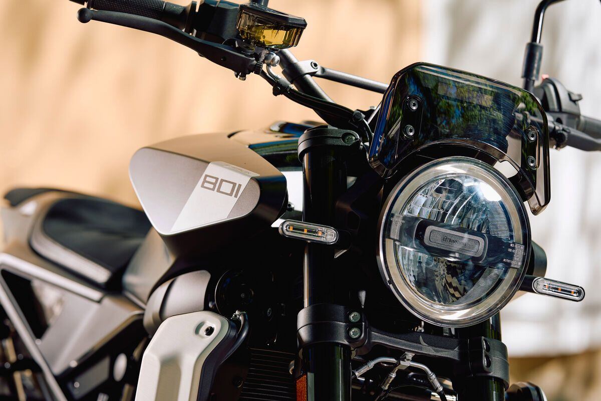

An attractive LED headlight is a dramatic departure from KTM’s angular units on the Duke line.
An attractive LED headlight is a dramatic departure from KTM’s angular units on the Duke line. (Husqvarna/)
Although Svartpilen styling doesn’t scream hooligan, think of it as a wolf in sheep’s clothing. After all, it is a close cousin to another brand that’s motto is “Ready to Race.” The apple didn’t fall far from the tree. Using the right rider-aid and mode settings, the 801 definitely has a welcome naughty streak.

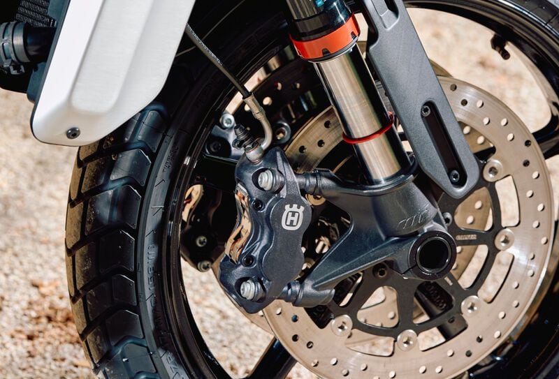

A pair of J.Juan radial-mount, four-piston calipers and 300mm discs are used on the front.
A pair of J.Juan radial-mount, four-piston calipers and 300mm discs are used on the front. (Husqvarna/)
The braking package includes a pair of radial-mount, four-piston J.Juan calipers up front that pinch 300mm discs, while a single-piston caliper mated to a 240mm disc is used at the rear. Like the clutch lever, the front brake lever offers span adjustment. Lean-sensitive ABS also offers a Supermoto mode that eliminates ABS to the rear wheel for spirited road riding or for those wishing a bit more control on gravel roads. The brakes performed well during our ride with competent power and progressive bite, but lack the outright power of top-of-the-line stoppers.

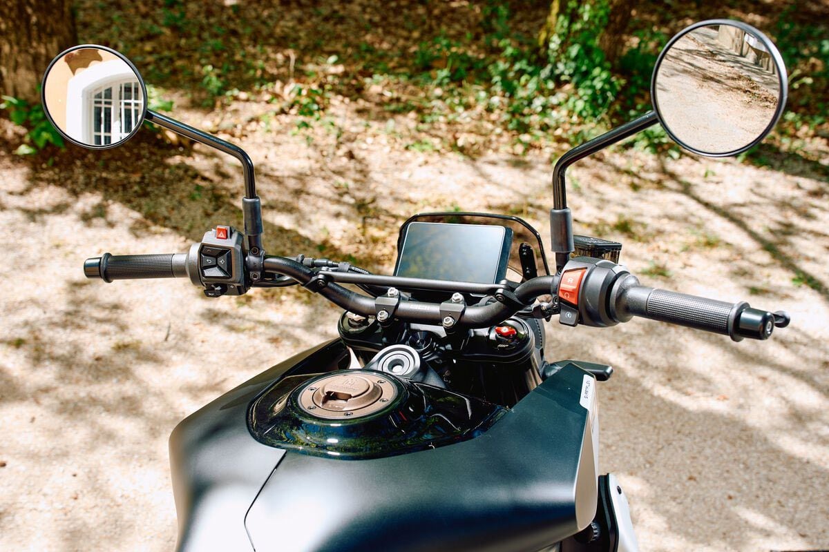

A view of the cockpit and the moto-style handlebar.
A view of the cockpit and the moto-style handlebar. (Husqvarna/)
One thing that we needed to feel out and build some trust with are the Pirelli MT 60 RS tires, which look like a dirt-track or ADV tire with mild knobbies. In our opinion, the tires were chosen more for their appearance, but ultimately they provided good overall grip on a variety of roads and conditions. If we owned this bike, we’d swap over to a full-on sport tire on the 17-inch wheels.

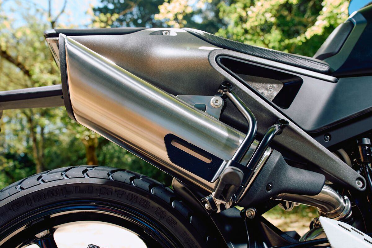

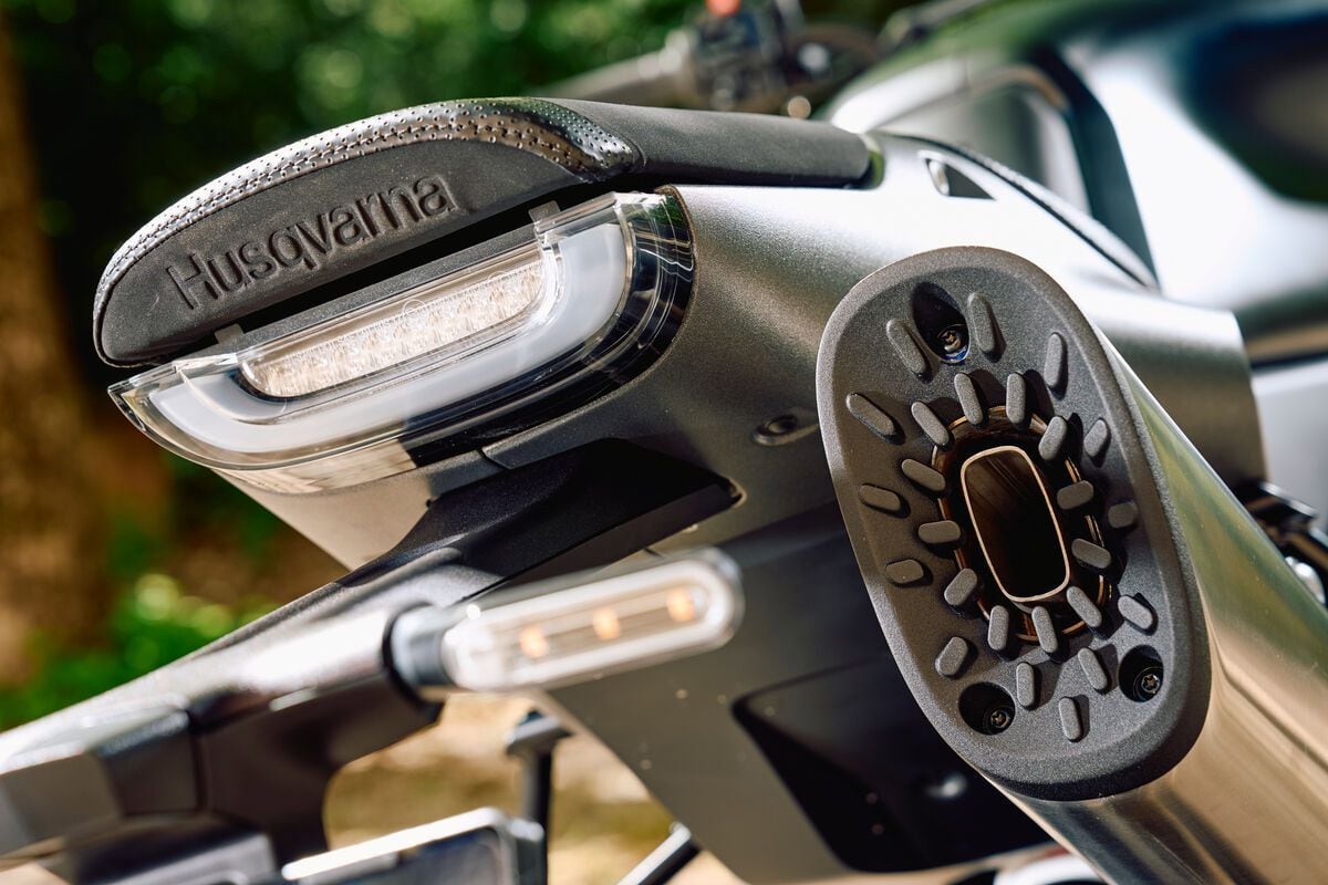

Handling is crisp and light, yet the bike offers excellent stability. (Husqvarna/)The stainless-steel silencer is slim and attractive.
The stainless-steel silencer is slim and attractive. (Husqvarna/)The rear end of the Svartpilen isn’t short on stylish details.

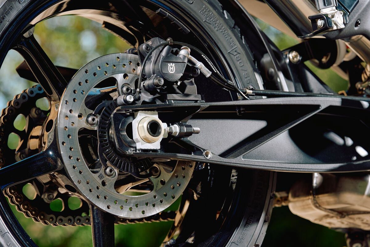

The rear end of the Svartpilen isn’t short on stylish details. (Husqvarna/)The aluminum swingarm is braced and directly actuates the shock.

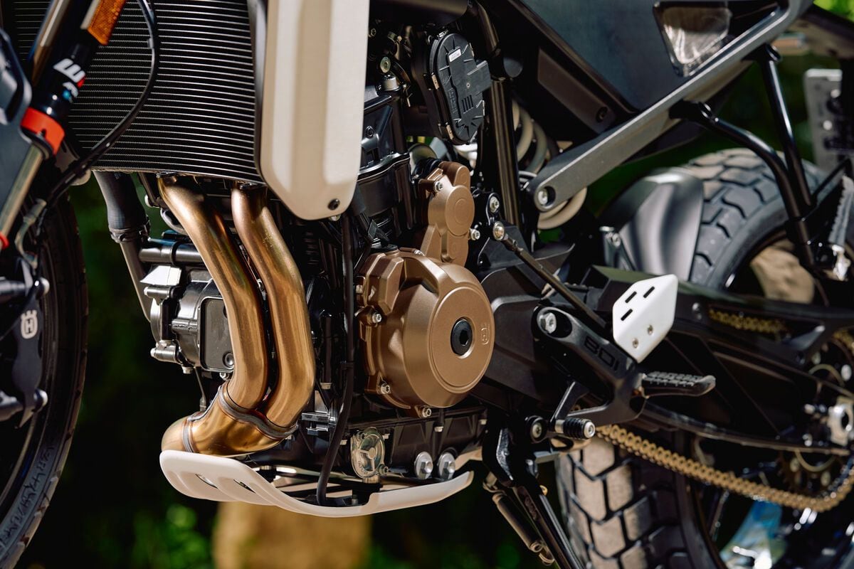

The aluminum swingarm is braced and directly actuates the shock. (Husqvarna/)If you want to scramble on your Svartpilen 801, a skid plate will protect the engine and frame.
If you want to scramble on your Svartpilen 801, a skid plate will protect the engine and frame. (Husqvarna/)A cool cutaway view of the LC8c.

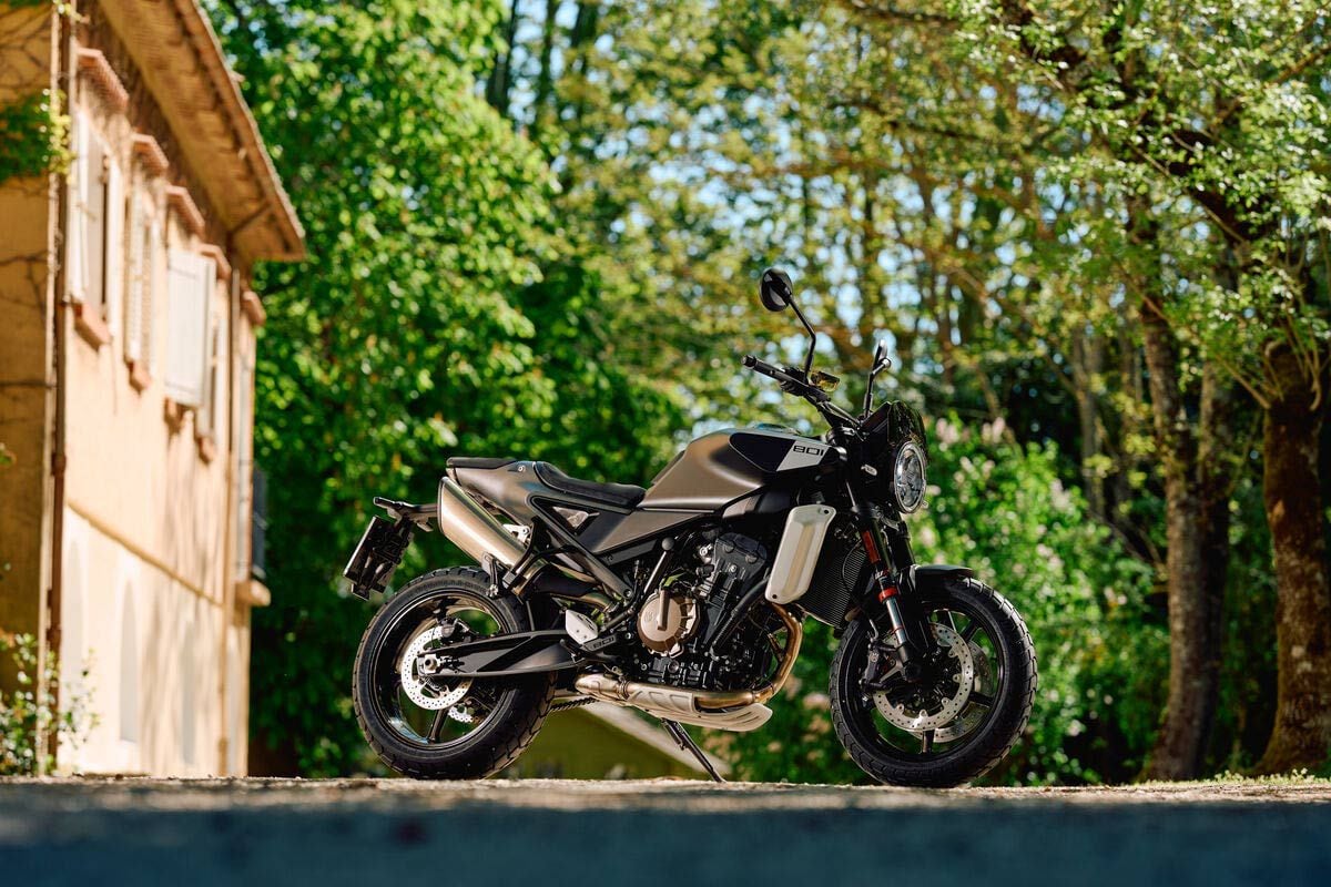

A cool cutaway view of the LC8c. (Husqvarna/)The 2024 Husqvarna Svartpilen 801.
The 2024 Husqvarna Svartpilen 801. (Husqvarna/)Watch out for bicyclists on a Saturday in France.

Rear Brake: 1-piston floating caliper, 240mm disc w/ Bosch ABS
