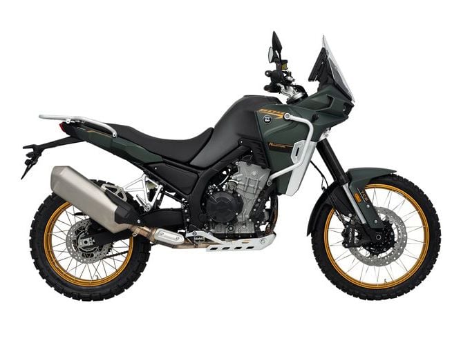

There is not a time frame yet on when the three models will go on sale in the US.
There is not a time frame yet on when the three models will go on sale in the US. (Kove/)
Step up to the Rally version and the suspension rises further still. You get 10.6 inches of fork travel and 9.8 inches of rear on offer, along with 11.5 inches of ground clearance. The seat is taller too, at 35.2 inches, and the longer fork means the wheelbase stretches out again, to 60.8 inches.
While all three models use 90/90-21 front tires, the rear rubber size differs, with 150/70-18 on the Standard and Pro, but a 140/80-18 on the Rally. That suggests more off-road-biased rubber for the Rally variant, which is also likely to be why its certified top speed is limited to 114 mph while the two other models are rated at 130 mph.
