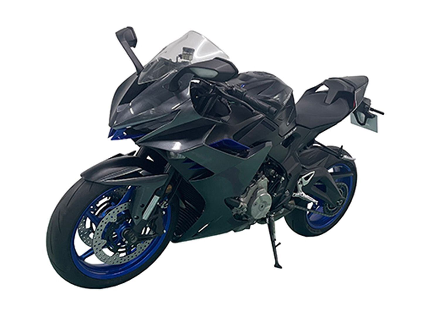

The Zontes 703RR, first shown at EICMA in this form, is now headed to production with a few minor changes.
The Zontes 703RR, first shown at EICMA in this form, is now headed to production with a few minor changes. (Zontes/)
After several years developing its new three-cylinder engine, Chinese brand Zontes unveiled its 703F adventure bike and 703RR sportbike at last year’s EICMA show. At the time they were still prototypes and technical information was very limited. But now the 703F is being delivered to customers in China, with export sales expected to follow in the next few months, while the 703RR has just been type-approved to reveal what the production version looks like and shows some of its key specifications.

While Zontes has yet to make an official announcement, the type-approval documents for the 703RR confirm some key differences to the 703F and to the company’s own claims when the prototypes were shown at EICMA. Back then, Zontes said the adventure bike would make 100 hp at 9,000 rpm while the sportbike would be good for 110 hp and 11,000 rpm, but when the 703F was officially revealed in production form its peak had dropped a fraction to 96 hp, and arrived 1,000 rpm higher than planned at 10,000 rpm. The new type-approval documents also suggest the 110 hp claim for the 703RR was slightly ambitious, as it has a homologated peak power of 101 hp on the official paperwork. The figures for both bikes could change when export models are released though, given the variation in emissions limits around the globe.
Other details revealed in the type-approval paperwork include a certified top speed of 143 mph for the 703RR, which seems about right and puts it in the same ballpark as rivals like Honda’s CBR650R. In terms of both power and performance, the Zontes should certainly be ahead of the twin-cylinder Yamaha R7, and very close to the likes of Aprilia’s RS 660 and Triumph’s Daytona 660—the only other three-cylinder bike in this part of the market, at least until CFMoto’s incoming 675SR reaches production.

The front fairing gets some changes compared to the show bike picture below.
The front fairing gets some changes compared to the show bike picture below. (Zontes/)

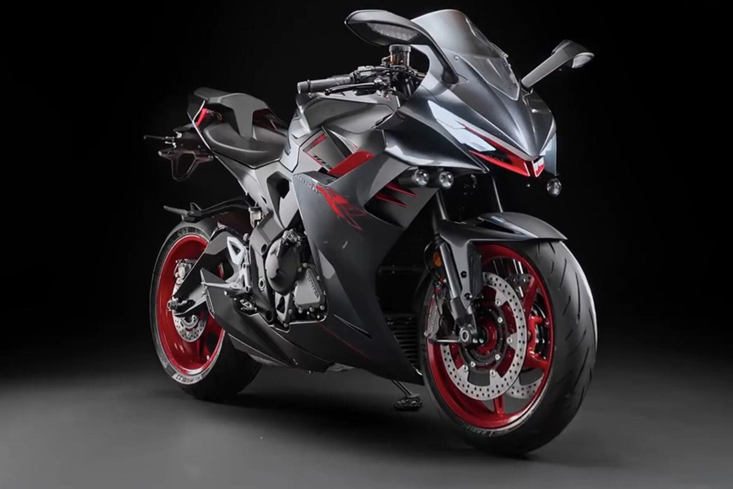

Visually, the bike has evolved slightly since the original show version made its debut at EICMA last November. The most obvious change is to the headlights, which are unusually positioned on either side of the fairing instead of in the nose. On the production model, the light units still sit under the upper plane of the side-mounted winglets, but where the concept bike had four separate, projector-style lamps that protruded noticeably in front of the leading edge of that winglet, the showroom version appears to have a more subtle design with purpose-made light units tucked further back.
The show bike had more pronounced headlights protruding from the fairing.
The show bike had more pronounced headlights protruding from the fairing. (Zontes/)
There are still lights in the nose, including a strip of LEDs running in a V-shaped line along the front edge and additional lamps tucked underneath that. The overall look is sharp, if a little cluttered, and the subtle paintwork of the bikes photographed for the type approval appears to match the EICMA show bikes, albeit lacking a few graphics and with the original bike’s red highlights and wheels swapped for blue ones.
