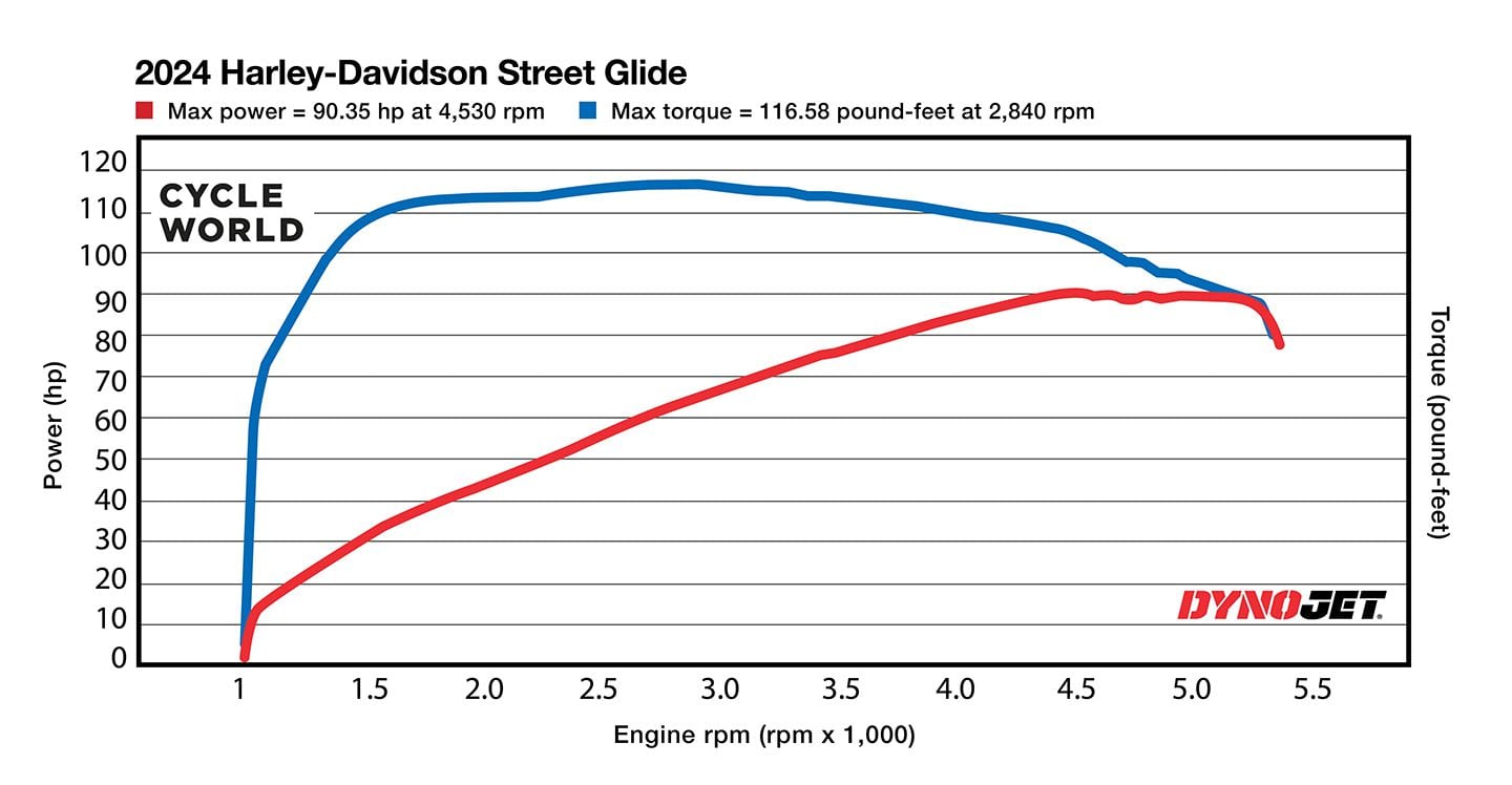

2024 Harley-Davidson Street Glide Dyno Chart
2024 Harley-Davidson Street Glide Dyno Chart (Robert Martin/)
On our in-house Dynojet 250i dynamometer, the 2024 Harley-Davidson Street Glide produced 90.35 hp at 4,530 rpm and 116.58 lb.-ft. of torque at 2,840 rpm. For reference, the 2023 Harley-Davidson CVO Road Glide Limited Anniversary Edition recorded 90.11 hp at 4,660 rpm and 111.22 lb.-ft. of torque at 3,290 rpm. The 2024 Street Glide edged out last year’s CVO with a slight increase in horsepower and torque.
