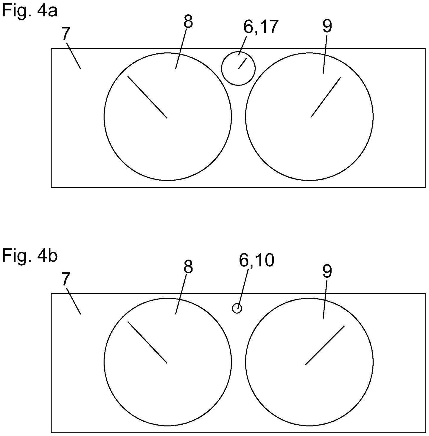

That’s where KTM’s new idea comes into play. In essence, the company reasons that if you have a speedometer to monitor your own speed and avoid breaking limits that change from one place to another, why not add a sound meter that lets you keep an eye on your noise levels? The patent’s simplistic illustrations show that the bike’s real-time noise level could be communicated to the rider either via a meter or through a warning light that flashes if you pass a preset threshold. KTM even suggests a haptic system could be used, alerting riders via vibration motors. Ironically the patent also says an audible alert could be adopted to tell you if you stray over the noise limit.
The patent shows that KTM is working on a speedometer-style gauge or an indicator light to inform the rider when sound levels have hit a predetermined limit.
The patent shows that KTM is working on a speedometer-style gauge or an indicator light to inform the rider when sound levels have hit a predetermined limit. (KTM/)

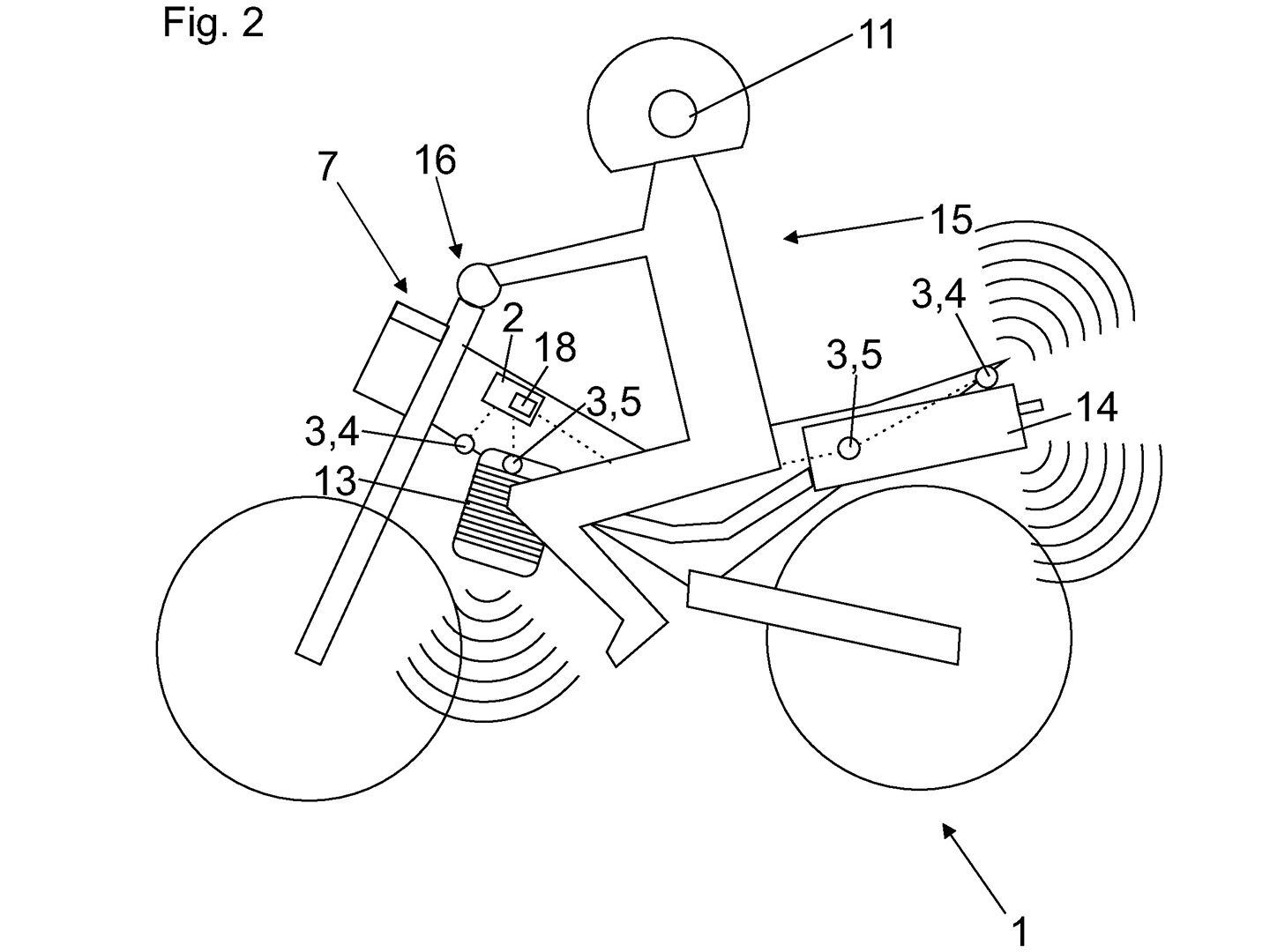

The system includes sensors on the motorcycle itself that monitor the noise level in real time, mounted around the engine and exhaust as well as the bodywork and chassis. KTM suggests these could be either listening for airborne sounds or monitoring vibration through the structure. They’re connected to a control unit that also links to the bike’s engine management.
