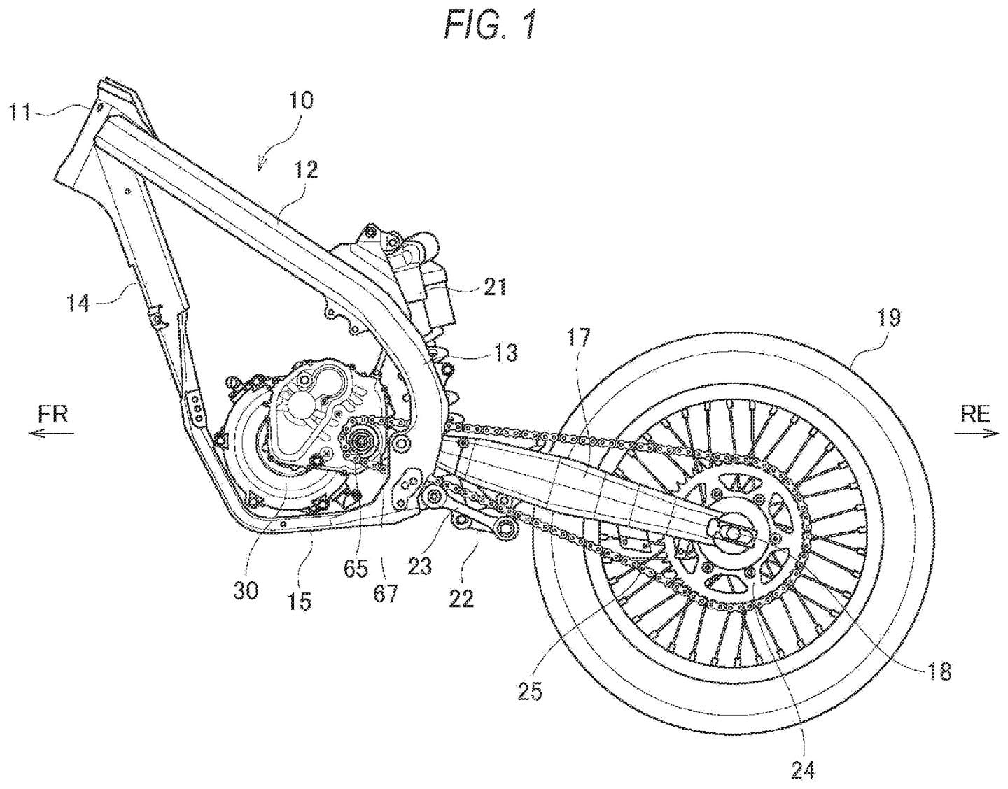

Suzuki patents show that the company is working on an electric motocross bike that utilizes the current RM-Z frame.
Suzuki patents show that the company is working on an electric motocross bike that utilizes the current RM-Z frame. (Suzuki/)

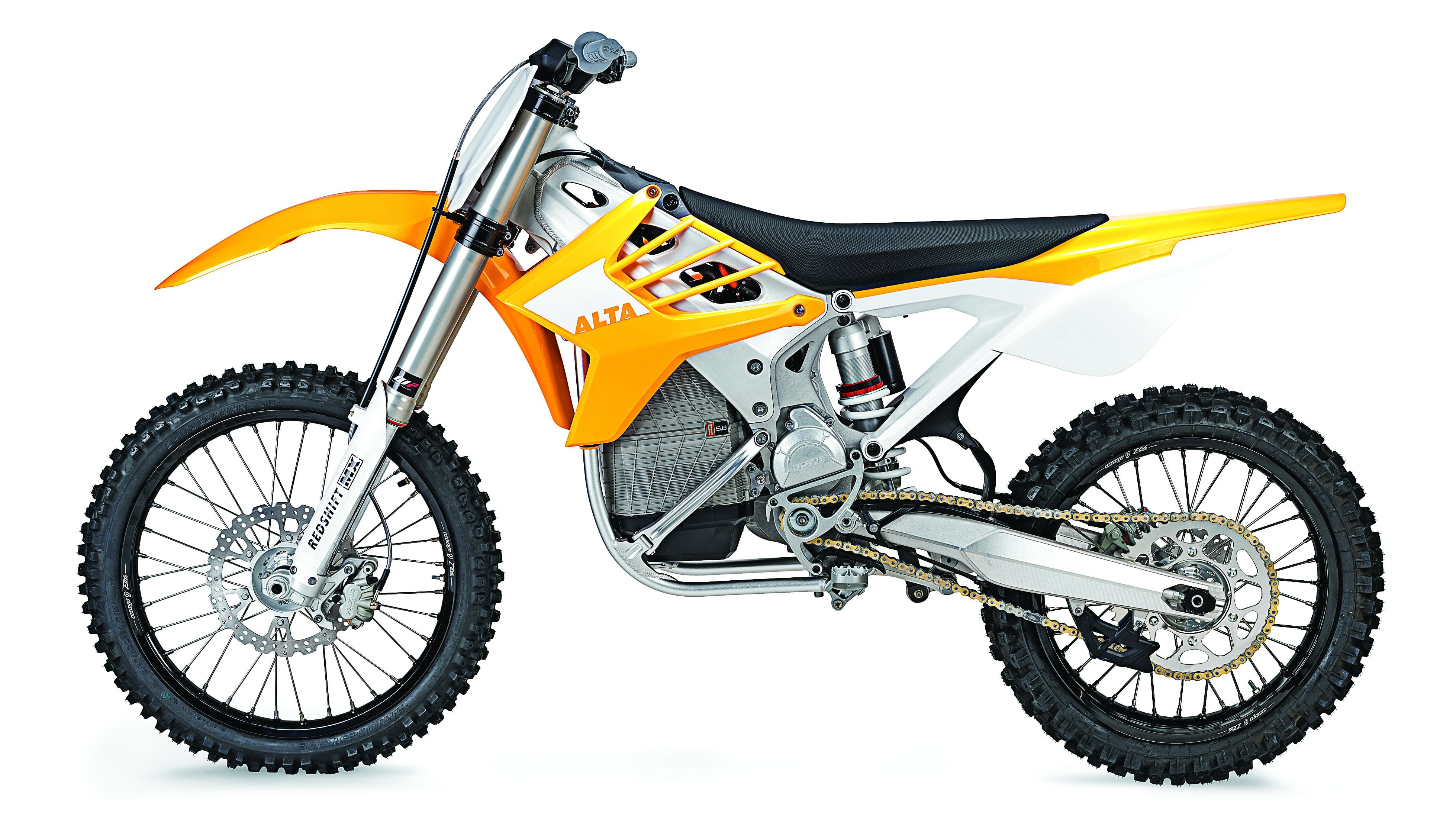

Alta’s Redshift was ahead of the curve and unfortunately the company went out of business prematurely.
Alta’s Redshift was ahead of the curve and unfortunately the company went out of business prematurely. (Courtesy of Alta Motors/)

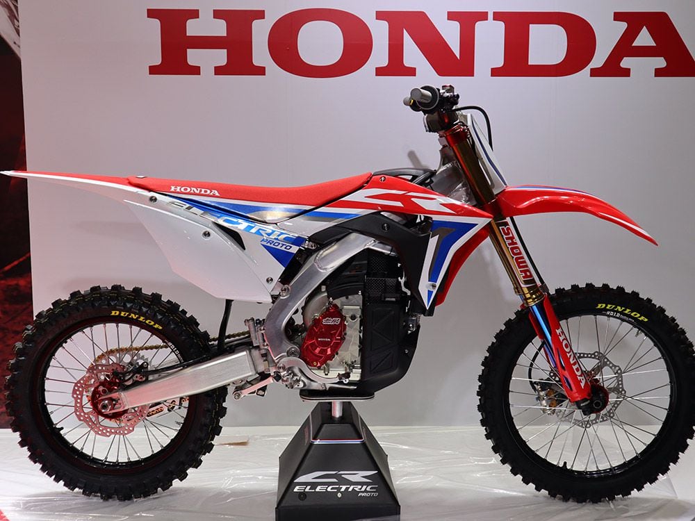

Honda has been competing in the All-Japan Motocross Championship with its CR Electric Proto. <i>Honda</i>

More recently we revealed that Yamaha is working on an electric crosser based on the motor developed for its TY-E electric trials bike, and now Suzuki appears to be going down the same route, filing patent applications for an electric powertrain bolted to an RM-Z frame.

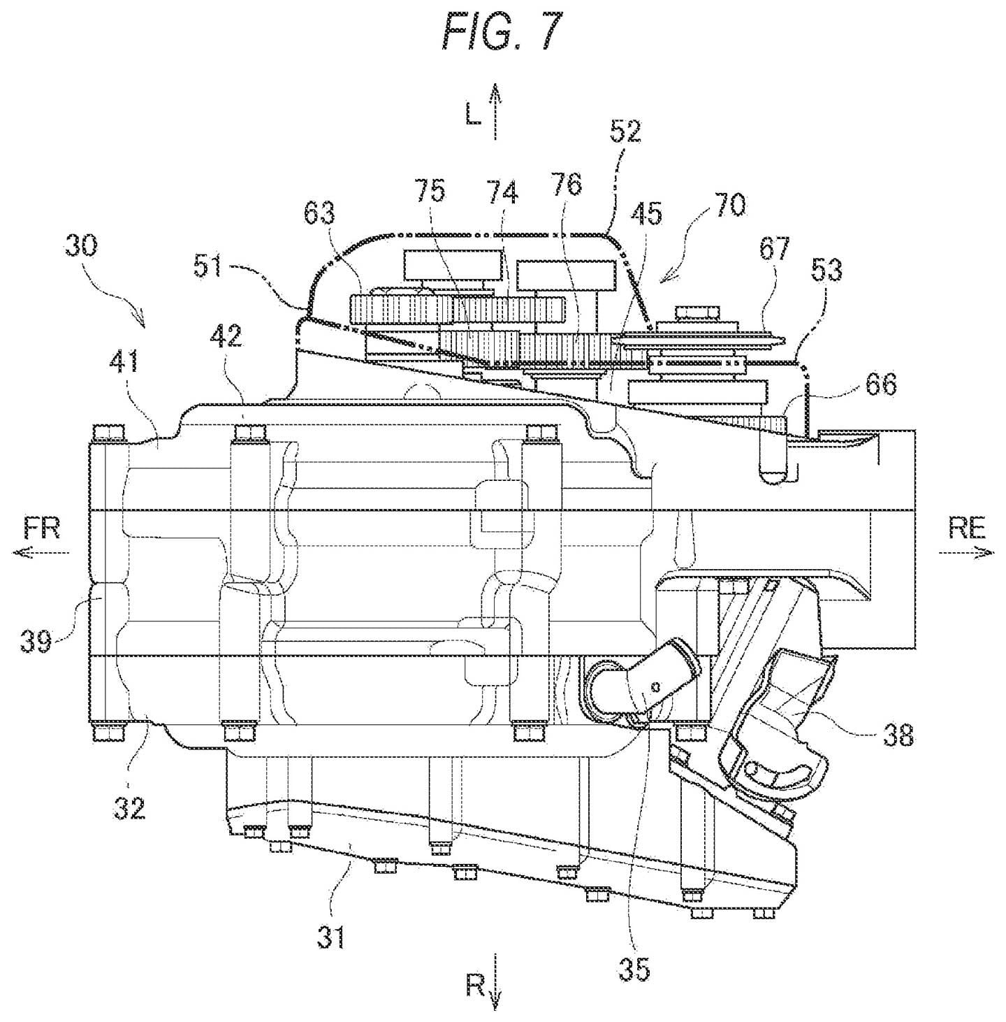

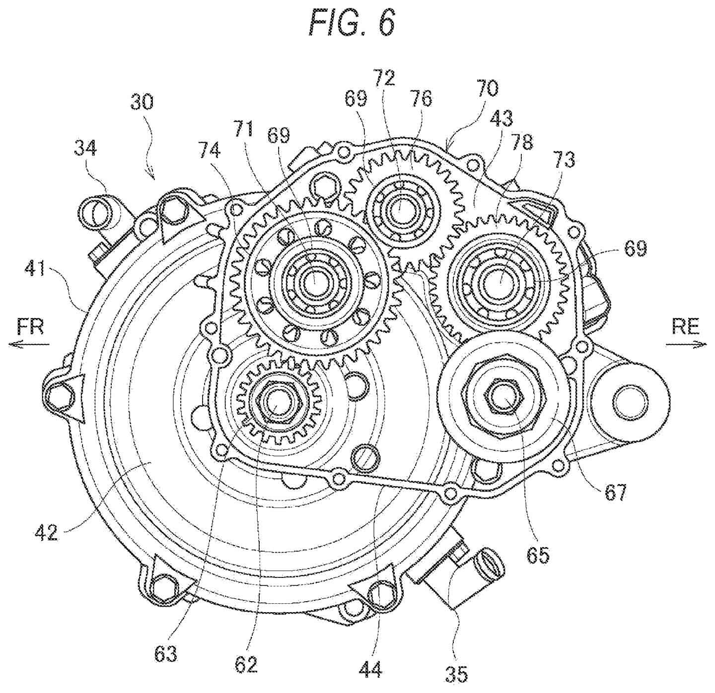

Patent illustrations show how Suzuki plans to package the transmission that will gear down the input from the motor to the countershaft sprocket.
Patent illustrations show how Suzuki plans to package the transmission that will gear down the input from the motor to the countershaft sprocket. (Suzuki/)
The Suzuki patent doesn’t reveal any details about the batteries or how they’ll be packaged into the chassis, but it shows detail of the transmission, which takes drive from the motor and gears it down through several stages before it reaches the front sprocket. The element that Suzuki hopes is patentable is the layout of those reduction gears, which minimizes the outright size of the powertrain, allowing it to be no wider than the motor itself. In fact, the front sprocket is closer to the centerline of the bike than the output gear of the motor, helping keep the chain in the same position as that of the normal Suzuki RM-Z, allowing the swingarm and rear wheel to be carried over from the ICE-powered model.
Key to the patent is lining up the chain line with the standard placement, so that Suzuki doesn’t have to develop a brand-new chassis.
Key to the patent is lining up the chain line with the standard placement, so that Suzuki doesn’t have to develop a brand-new chassis. (Suzuki/)
Sharing parts with the combustion engine motocross range is likely to be important, not only because it means cost savings in terms of R&D, manufacturing, and supply chains but because those bikes have been slowly evolved over many years, each update chasing a tiny improvement in on-track performance. Starting again from scratch on the chassis simply to fit it around an electric motor and battery would mean throwing away years of development. It’s better to develop the powertrain to fit inside an existing chassis than to create a chassis around that powertrain both in terms of cost and potential performance.
