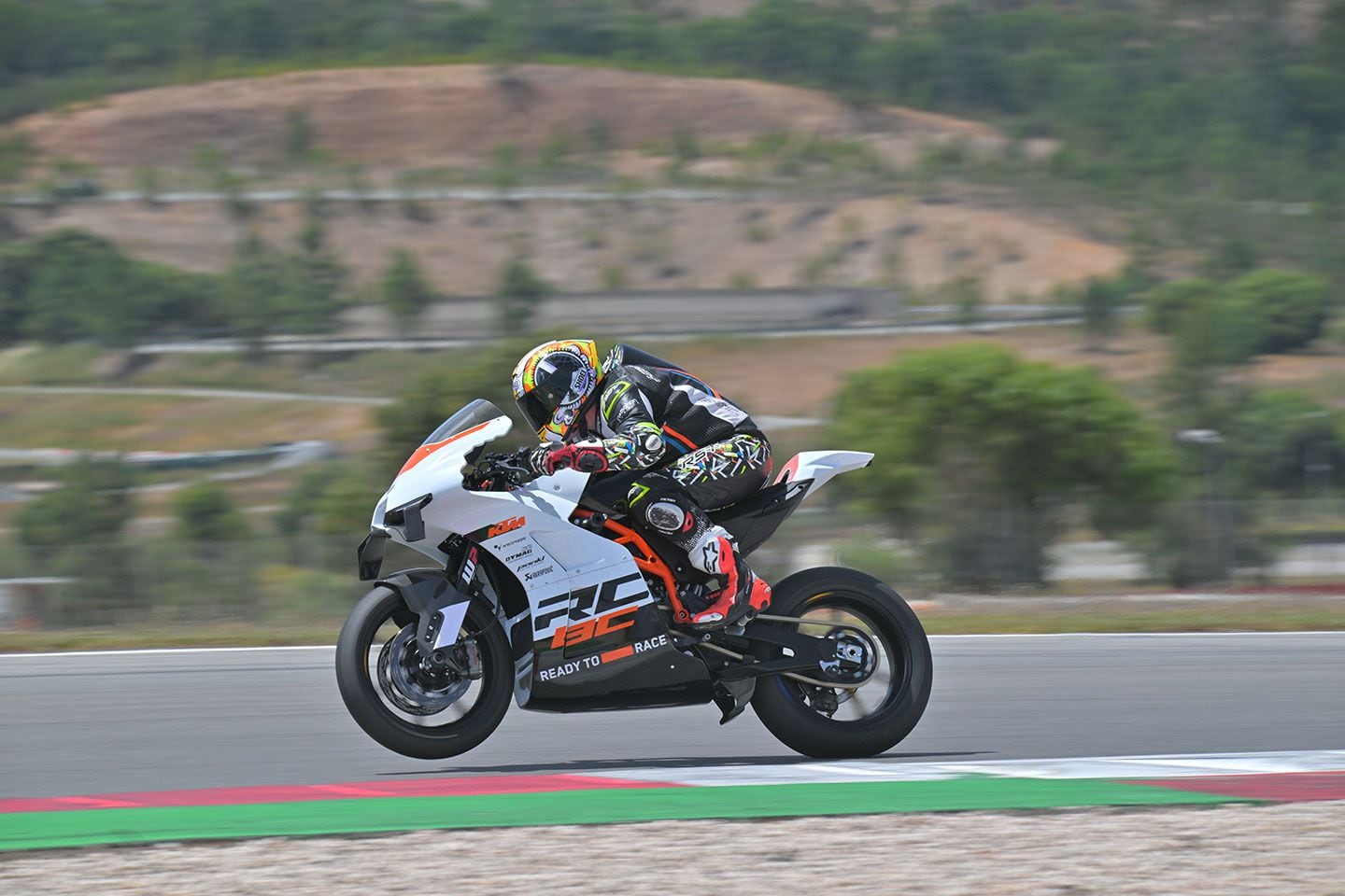

KTM’s 2024 RC 8C is a highly focused track weapon.
KTM’s 2024 RC 8C is a highly focused track weapon. (KTM/)
If you love your trackdays and have $1,000 lying around, you may want to get down to your local KTM dealership extra pronto. That’s because a thousand bucks is the minimum deposit for the revamped and seriously exquisite KTM RC 8C, the most focused and uncompromised production machine built for the racetrack.
Why so focused? As a track-only bike, it was never intended to be homologated for the road. Free of the compromises necessary to build a sportbike for the public highway, the Austrian manufacturer, working in partnership with race specialists Krämer Motorcycles, could focus on one design target only: cutting awesome lap times on track. Every detail, right down to its adjustable steering head angle and special aero wings, exists to make it quicker apex to apex. And, as we shall see, that makes for a ride unlike anything you can experience on a fully homologated, Euro 5+, road-legal sportbike.
Even if track-only scalpels aren’t your bag, this updated version of RC 8C takes on a wider significance since KTM recently revealed outline details of the 990 RC R that will go on sale in 2025. The 990 will be KTM’s first pure road-going sportbike since the withdrawal of the much-loved RC8 and, while the two machines’ engine capacities will differ and many of the RC 8C’s race details will be exchanged for required road equipment, both bikes will share similar power and torque outputs, chassis design, dimensions, and geometry.

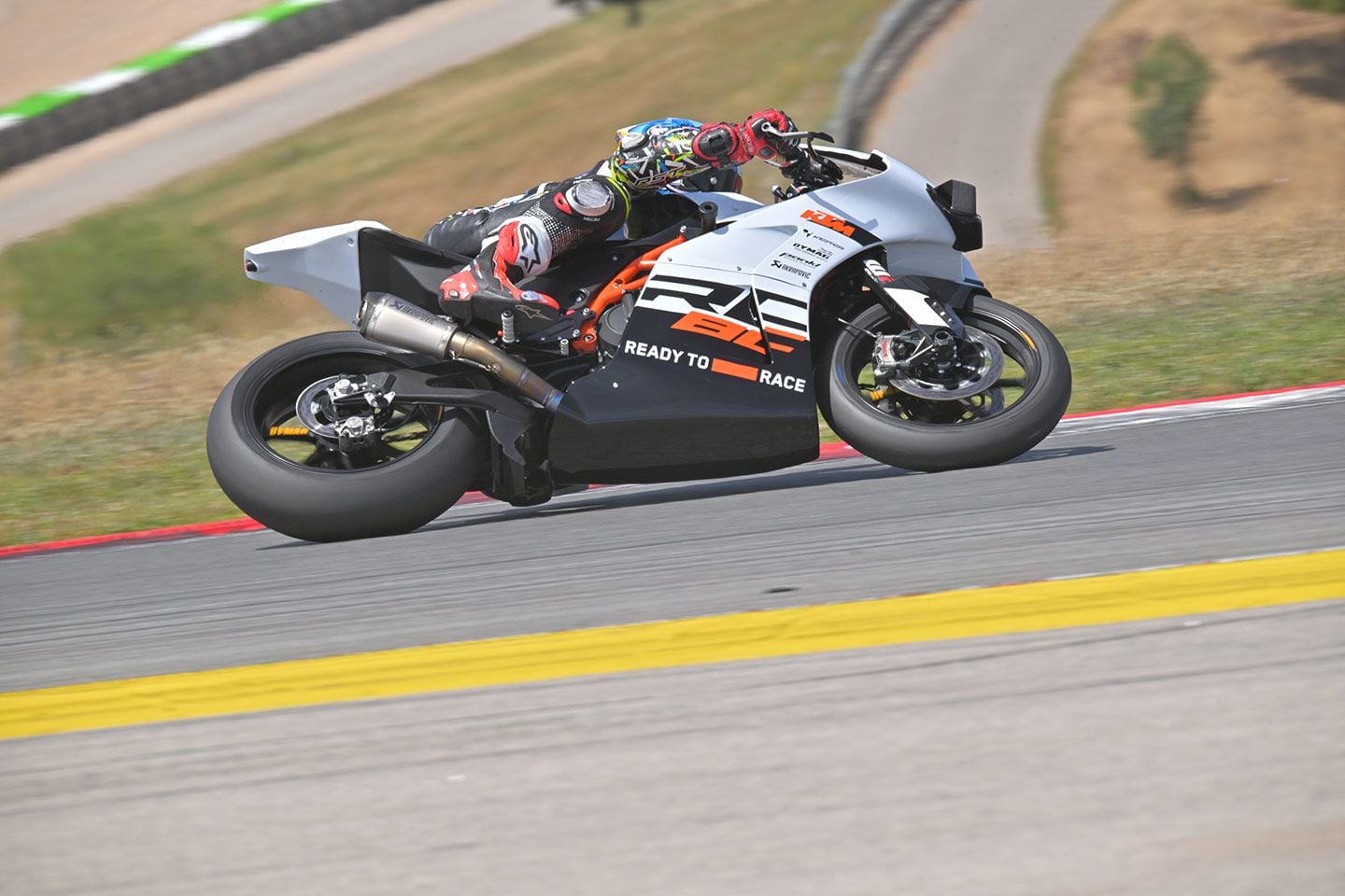

KTM’s RC 8C was developed in partnership with Krämer Motorcycles.
KTM’s RC 8C was developed in partnership with Krämer Motorcycles. (KTM/)

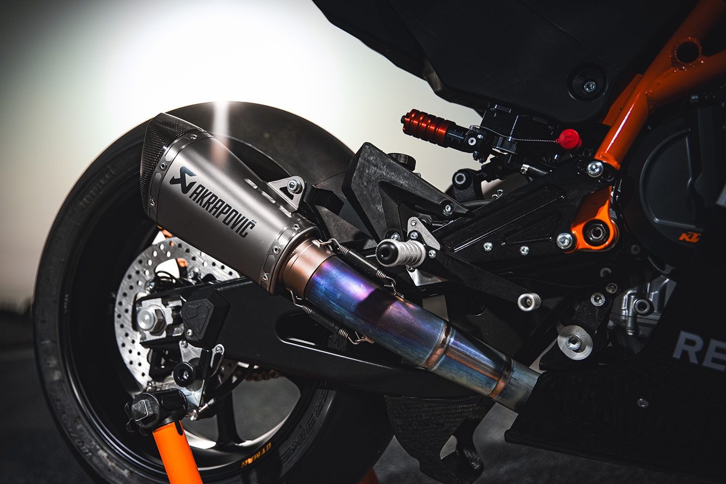

One press of the race starter button on the right bar, and the compact and sweetly balanced LC8c barks to life. The race switch gear isn’t labeled, so there’s a brief moment of familiarization, while the barely silenced full titanium Akrapovič exhaust drenches the pit lane in racy vibes. Note to trackday riders visiting circuits with noise testing: KTM offers a noise-canceling insert and even a quieter exhaust that drops the measured noise level to 98 decibels.

There is an insert available for the exhaust when decibel limits are imposed.
There is an insert available for the exhaust when decibel limits are imposed. (KTM/)
