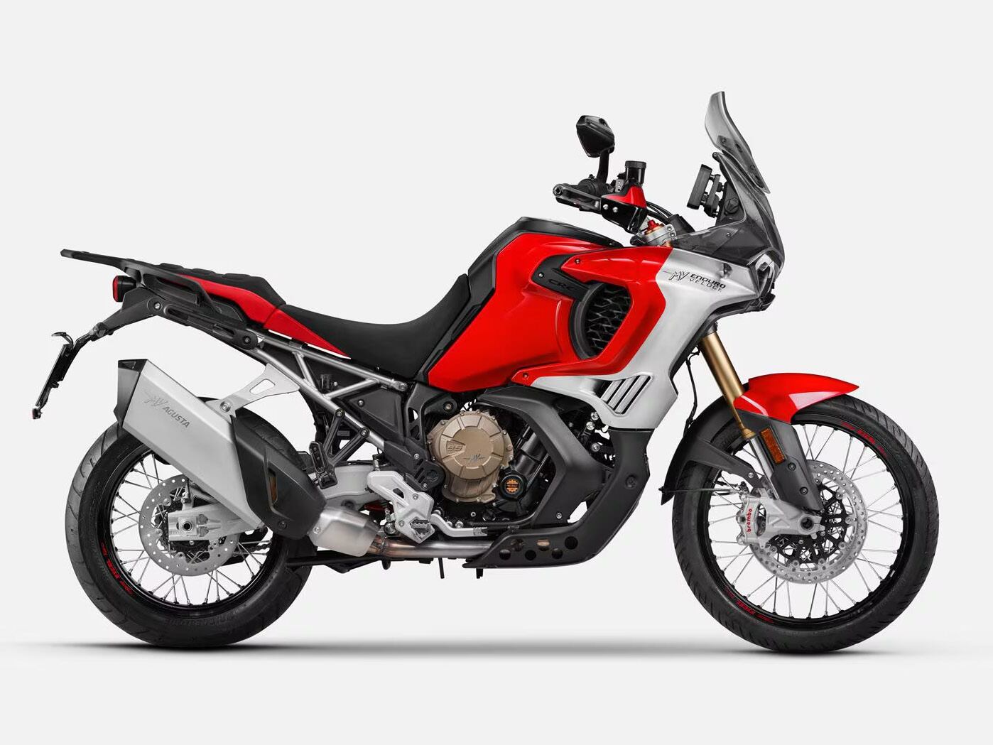

MV Agusta’s Enduro Veloce is the company’s first production adventure machine.
MV Agusta’s Enduro Veloce is the company’s first production adventure machine. (MV Agusta/)
  • Inline-triple engine is an excellent performer
  • Beautiful Italian styling
  • Feature packed
  • Weight is on par with open-class machines
  • Do you really want to get this dirty?
  • For this price we’d like electronic suspension
Those looking for a unique and stunning Italian adventure bike that is packed with features, an amazing engine, and a chassis that can do it all, the Enduro Veloce has to be a consideration.
MV Agusta’s Enduro Veloce is the normal production version of its first adventure bike model. It was preceded by the limited-edition 2024 LXP Orioli, of which just 500 units were produced. Mechanically the two bikes are very similar in specification, utilizing the same 931cc inline-triple engine, chassis, and most components.

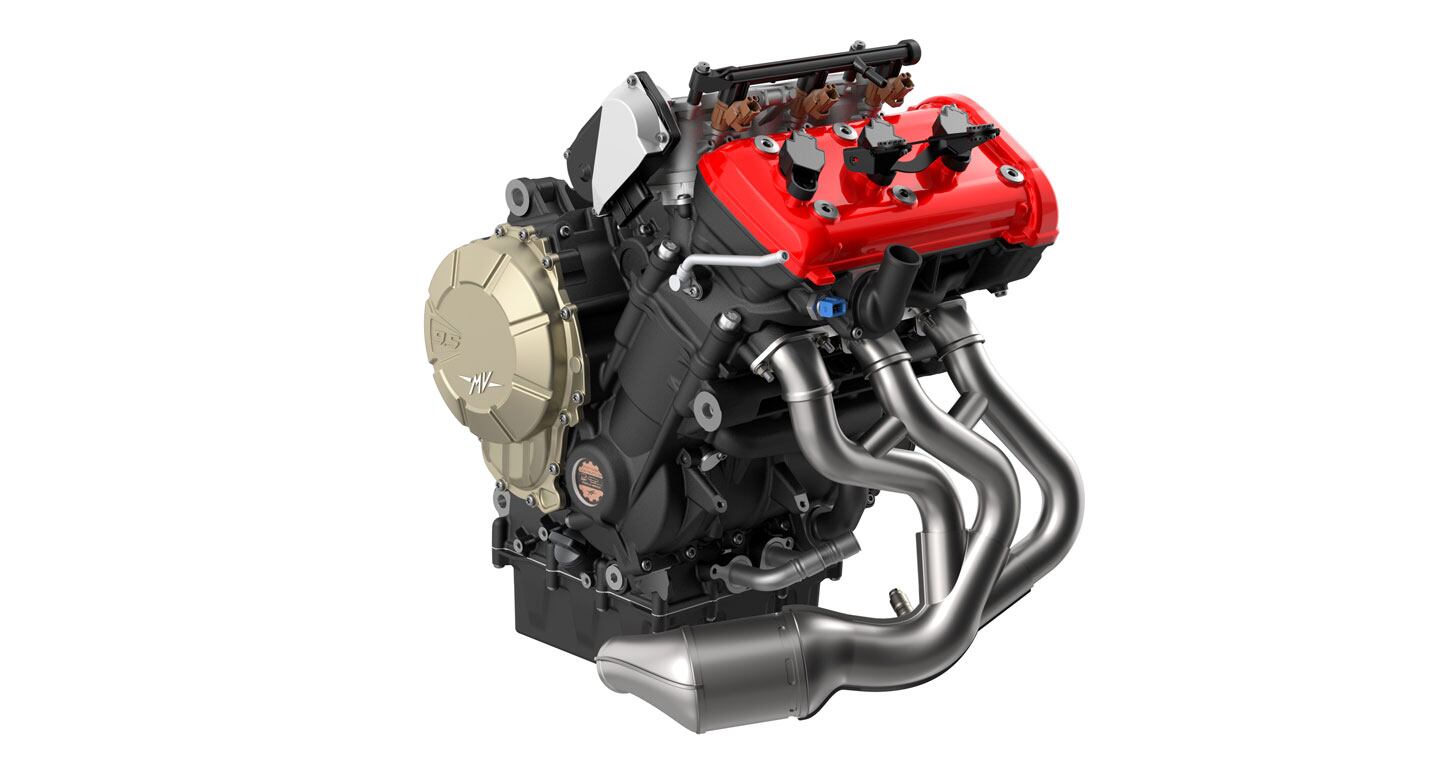

The engine in the Enduro Veloce is unique to the model. The inline-triple displaces 931cc.
The engine in the Enduro Veloce is unique to the model. The inline-triple displaces 931cc. (MV Agusta/)
The 931cc inline-three has four valves per cylinder and double overhead cams with DLC-coated followers; bore and stroke measure 81 by 60.2mm with a 13.4:1 compression ratio. MV’s latest-gen triples feature a counterrotating crankshaft to cancel out the gyroscopic effects of the rotation of the wheels for improved handling, while a single counterbalancer is used to smooth out engine vibration.
MV makes it clear that this engine was designed with high-performance output in mind with components like lightweight forged-aluminum, bridge-box-style pistons inside, and a quick-revving nature. They are also proud of the fact that the engine only weighs 126 pounds. Claimed power output is 124 hp at 10,000 rpm with 75 lb.-ft. of peak torque at 7,000 rpm. MV also points out that 85 percent of the peak torque is available from as low as 3,000 rpm.
“The triple in the Enduro Veloce is, in one word, awesome,” Editor-at-Large Blake Conner said after sampling the bike in Sardinia. “It allows so many options in terms of gear selection. If you don’t feel like rowing the gearbox, you can pick third gear and find a happy pace that you could ride all day. But if you want a bit more engagement and really want to test the traction-control system, clicking back and forth between second, third, and fourth makes for an entertaining day behind the bars.
”The MV’s fueling is excellent, while its electronics, which we’ll cover shortly, give you a ton of options to fine-tune the bike to your liking. Compared to the middleweight parallel twins on the market and the Triumph 900s, the Enduro Veloce is a real on-road ripper. When a long straightaway opens up or you need to pass a line of cars, this MV is more akin to an open-class bike. If raw performance was the goal, then put a big check mark in that column as a success.”

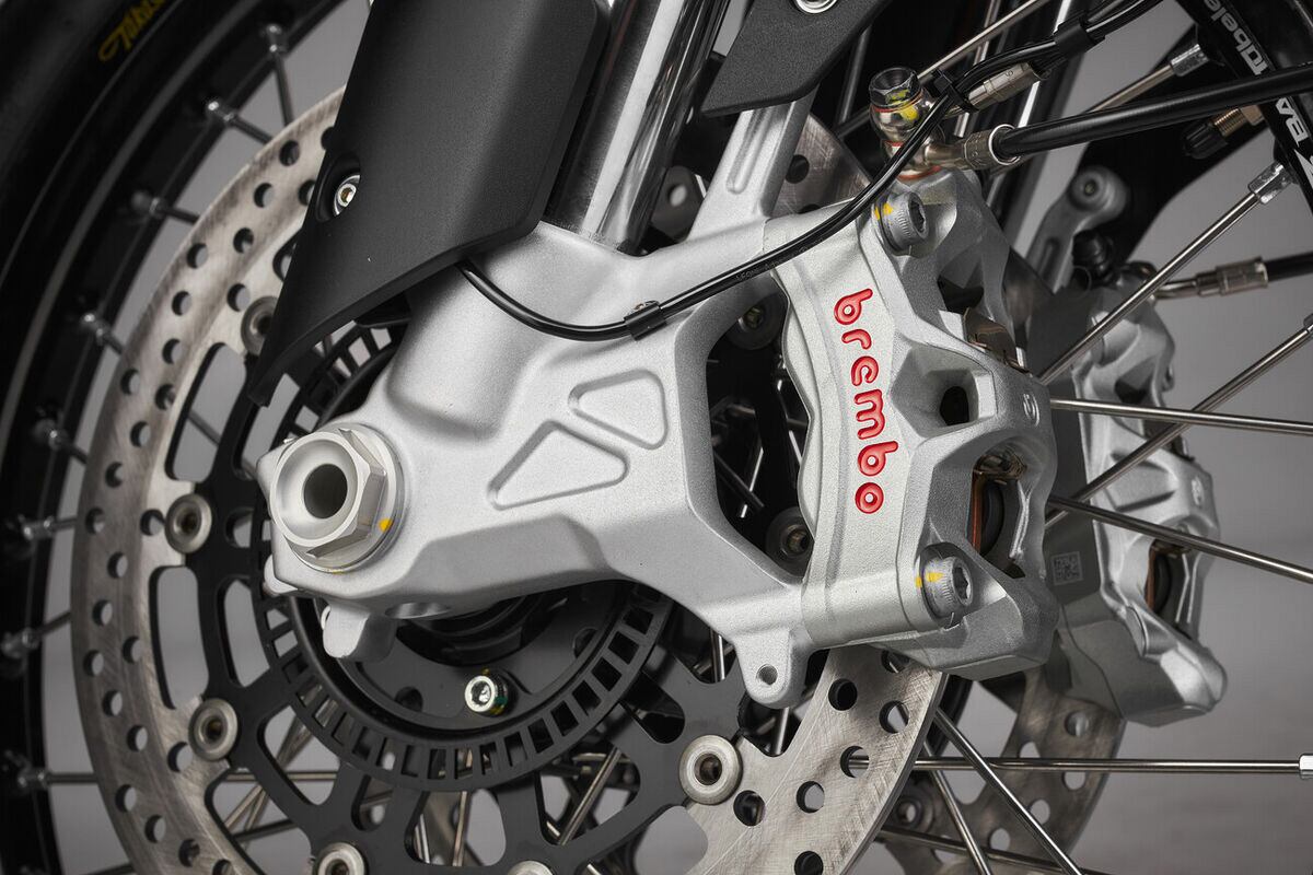

MV didn’t skimp in the braking department. A pair of Brembo Stylema radial-mount, four-piston calipers and 320mm discs reside on the front and a twin-piston Brembo caliper and 265mm disc at the rear. Cornering ABS is managed by a Continental MK 100 system and fed info by the six-axis IMU.
Brembo Stylema brakes are used up front.
Brembo Stylema brakes are used up front. (MV Agusta/)
“Another nice trait is how well the bike reacts to trail-braking,” Conner added. “Drag the ultrapowerful front Brembos to the apex and then release pressure on the lever and the bike stays planted and doesn’t allow the fork to suddenly extend while rebounding.”

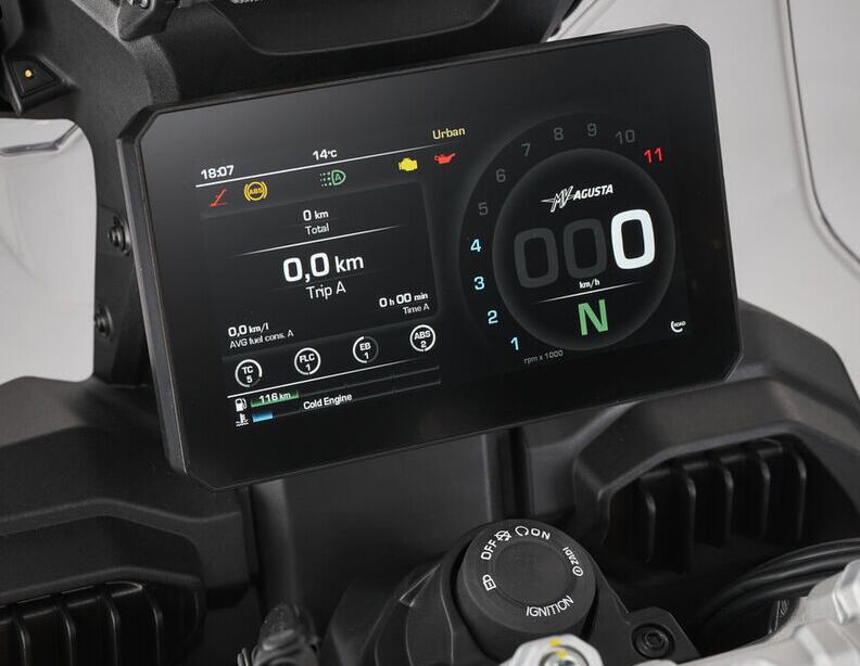

The Enduro Veloce has a complete suite of electronic rider aids. In the case of the MV, it has ride-by-wire throttle control and a six-axis IMU, giving the bike all of the advanced features that are becoming the norm in the ADV class. The Enduro Veloce has four riding modes including Urban, Touring, Off-Road, and a Custom All-Terrain (which can be set up with any parameters that you want).
There are eight levels of traction control, with five for road use, two for off-road, and one for rain, while the system can also be turned off completely. There are options for two levels of Engine Brake Control, there is a Launch Control that allows full-throttle (managed) starts, Front Lift Control, Rear Wheel Lift-Up Mitigation, Gas Sensitivity (throttle), Max Engine Torque, and Engine Response.
The MV Agusta Enduro Veloce has a full suite of rider aids and an easy-to-read 7-inch TFT display.
The MV Agusta Enduro Veloce has a full suite of rider aids and an easy-to-read 7-inch TFT display. (MV Agusta/)
“From a functionality standpoint, the organization of the MV’s menus and the navigation from the left bar-mounted control pod is quite good,” Conner said. “The menu logic is easy to understand, the settings are simple to change, and there are very few, if any, little annoyances.”
The dash itself is a large 7-inch HD TFT display that also offers both Bluetooth and Wi-Fi connectivity to utilize the MV Ride app or other devices like your phone for calls and music control. A pair of USB ports (standard and C) sit on the side of the tower to power devices. The screen is bright and easy to read and allows different layout options depending on what you want to see while riding. Both control pods have LED backlighting for good visibility in all lighting conditions.

2024 MV Agusta Enduro Veloce Specs
MSRP: $21,998
Engine: DOHC, liquid-cooled inline-triple; 4 valves/cyl.
Displacement: 931cc
Bore x Stroke: 81.0 x 60.2mm
Compression Ratio: 13.4:1
Claimed Horsepower: 124 hp @ 10,000 rpm
Claimed Torque: 75.2 lb.-ft. @ 7,000 rpm
Fuel System: Fuel injection w/ 47mm Mikuni throttle bodies, ride-by-wire
Clutch: Wet, multiplate; hydraulic actuation
Frame: High-tensile steel double cradle
Front Suspension: 48mm Sachs USD fork, fully adjustable; 8.3 in travel
Rear Suspension: Sachs monoshock, fully adjustable; 8.3 in. travel
Front Brake: Brembo 4-piston Stylema calipers, dual 320mm discs w/ ABS
Rear Brake: 2-piston caliper, 265mm disc w/ ABS
Wheels, Front/Rear: Spoked, tubeless; 21 x 2.15 in. / 18 x 4.0 in.
Tires, Front/Rear: Bridgestone Battlax A41 (optional AX41); 90/90-21 / 150/70-18
Rake/Trail: 27.0°/4.6 in.
Wheelbase: 63.4 in.
Ground Clearance: 9.1 in.
Seat Height: 33.5/34.3 in.
Fuel Capacity: 5.3 gal.
Claimed Dry Weight: 494 lb.
