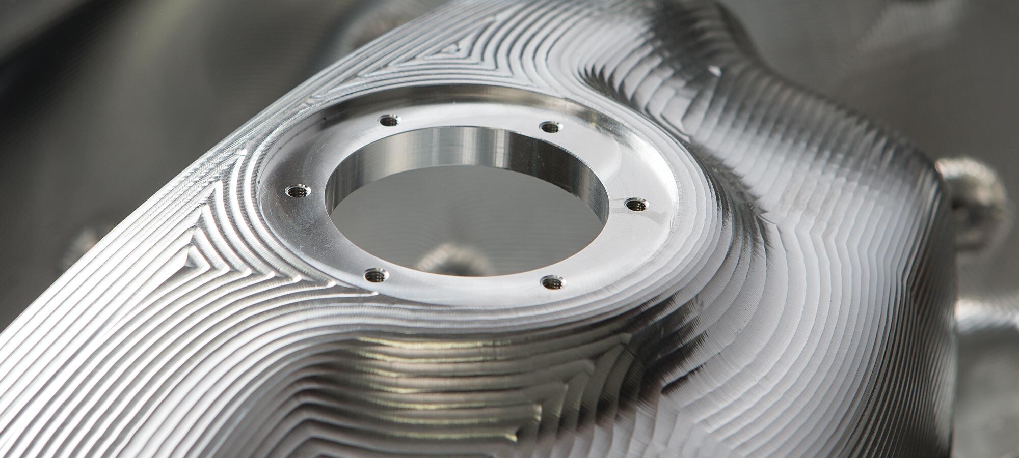

Why metal instead of other materials? The most obvious answer: ductility. <i>Jeff Allen</i>
