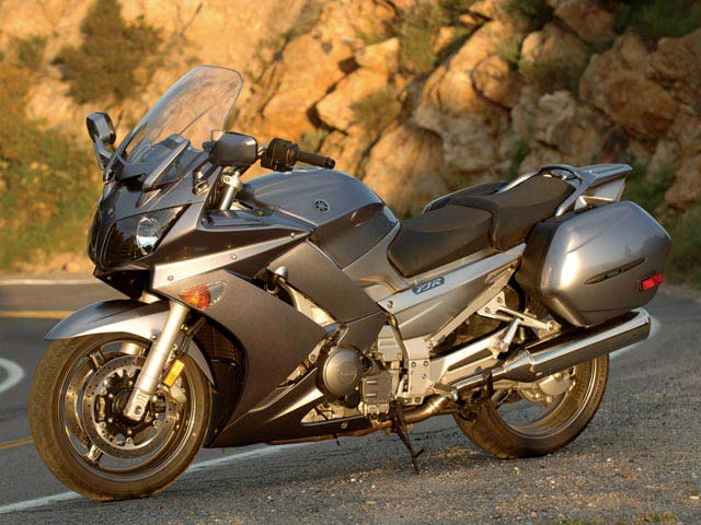

Yamaha’s 2006 FJR1300AE featured a semi-auto transmission that was controlled by hydraulic actuators. <i>Motorcyclist Archives</i>
It would be wrong to suggest Yamaha is late to the semi-auto game as it’s actually one of the pioneers of the field, having offered the YCC-S (Yamaha Chip Controlled Shift) on the FJR1300 tourer since 2006. The new Y-AMT setup follows a similar design route to YCC-S, in that it’s an automated version of a conventional manual transmission with bar-mounted buttons to control its shift operation and no clutch lever, but where YCC-S used hydraulics for its computer-controlled clutch, Y-AMT has an electromechanical actuator for the clutch and another for the shifter.

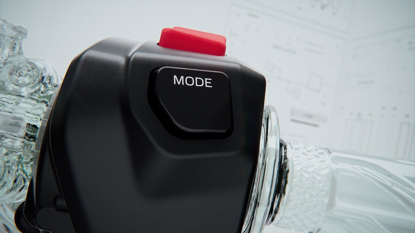

The huge improvement in motorcycle computing power since 2006, allied to the near-universal adoption of ride-by-wire throttles and vast arrays of sensors, means a modern take on the automated manual transmission should be very nearly as smooth as the truly seamless shift that Honda’s DCT achieves. Yamaha’s Y-AMT has three modes: two fully-auto settings and one semi-auto option. The standard auto mode, dubbed “D,” is a relaxed self-shifter, selecting gears automatically without any rider input. Just twist the throttle and go. A “mode” button on the right bar selects “D+” (essentially a sport setting) that holds on to gears longer and downshifts earlier to keep the revs on the boil while another right bar switch changes to the system’s manual setting.

The mode button allows the rider to choose between D mode, which is a straightforward auto mode, and D+ mode, which is a sportier mode.
The mode button allows the rider to choose between D mode, which is a straightforward auto mode, and D+ mode, which is a sportier mode. (Yamaha/)
