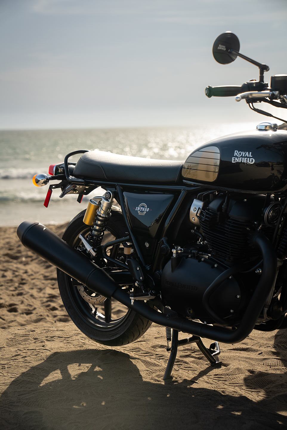

For 2024, the blacked-out models feature cast-aluminum wheels that accommodate tubeless tires.
For 2024, the blacked-out models feature cast-aluminum wheels that accommodate tubeless tires. (Royal Enfield/)
