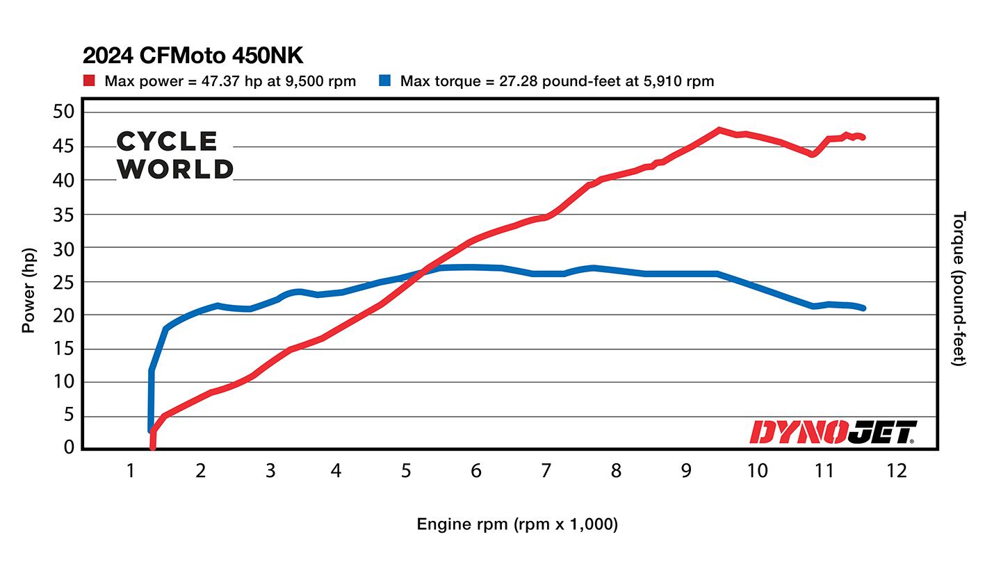

2024 CFMoto 450NK Dyno Chart
2024 CFMoto 450NK Dyno Chart (Robert Martin/)
Before hitting our in-house Dynojet 250i dynamometer, the 450NK weighed 386 pounds on our automotive scales. On the Cycle World dyno, the 2024 CFMoto 450NK produced 47.4 hp at 9,500 rpm and 27.3 lb.-ft. of torque at 5,900 rpm. For reference, the 2022 Honda CB500F produced 43.1 hp at 8,300 rpm and 29.4 lb.-ft. of torque at 6,600 rpm on the Cycle World dyno. CFMoto’s 450NK provides a linear power delivery and flat torque curve, despite a few peaks and valleys on the dyno chart.
