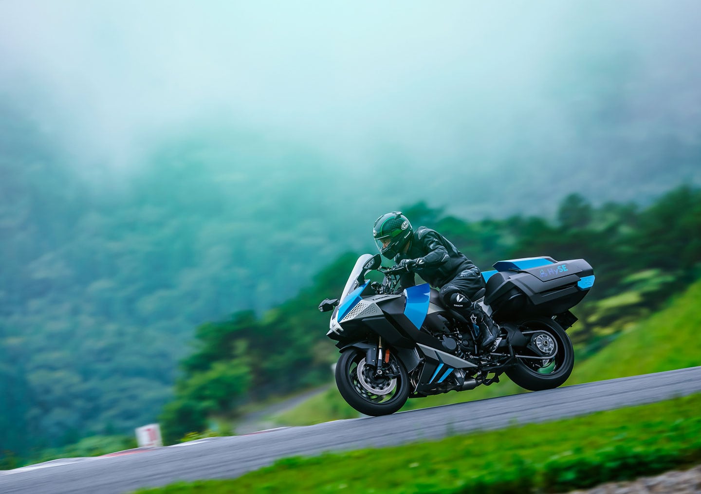

Kawasaki’s hydrogen test mule recently ran some demonstration laps at the Suzuka circuit in Japan.
Kawasaki’s hydrogen test mule recently ran some demonstration laps at the Suzuka circuit in Japan. (Kawasaki/)
Any lingering doubts over the seriousness of Kawasaki’s progress on a hydrogen-powered motorcycle for the future were decisively answered when the machine made its public debut at the Suzuka circuit on July 20 ahead of the Suzuka 8 Hours race.

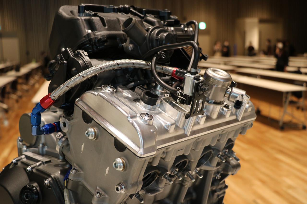

A view of the converted supercharged H2 engine.
A view of the converted supercharged H2 engine. (AutoBy/)
The bike itself uses a converted version of the Ninja H2 engine, as supercharging is all but essential on a hydrogen-fueled combustion engine. Hydrogen needs a much higher ratio of air to fuel compared to gasoline, and compressing air with a supercharger before it enters the cylinder helps achieve that goal. The conversion to hydrogen also required the engine to adopt direct fuel injection, adding hydrogen into the combustion chambers after the inlet valves have closed, because otherwise the hydrogen expands and forces air out of the cylinder.

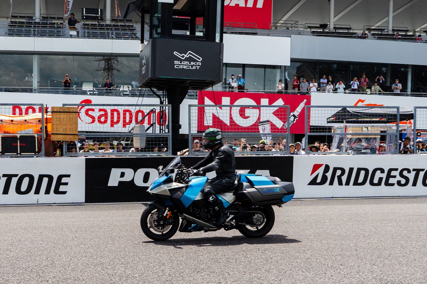

The test mule at Suzuka.
The test mule at Suzuka. (Kawasaki/)
Video of an earlier test run at the Autopolis circuit has also been released on Kawasaki’s own YouTube channel. It reveals that the bike has a hydrogen filling port on the back, feeding gas into the huge side-mounted tanks where it’s stored in an array of cylinders that can cope with vast pressure. Hydrogen fuel cell cars like the Honda Clarity store the gas at around 10,000 psi, and a clip of the fuel pump’s display shows it racing past 34 megapascals (340 bar, or around 4,900 psi) as the bike is filled, suggesting the Kawasaki’s tanks are similar to those in existing hydrogen vehicles. Even at such high pressure, hydrogen takes up much more space than gasoline carrying an equivalent amount of energy. On Kawasaki’s prototype there’s no provision for a passenger and those enormous rear panniers are used for fuel, not luggage.
It might be bulky, but hydrogen is much more energy-dense than gasoline in terms of weight, so those big rear tanks should be much lighter than they appear. Kawasaki says the bike’s whole chassis is designed to accommodate the hydrogen canisters and the fuel system.
