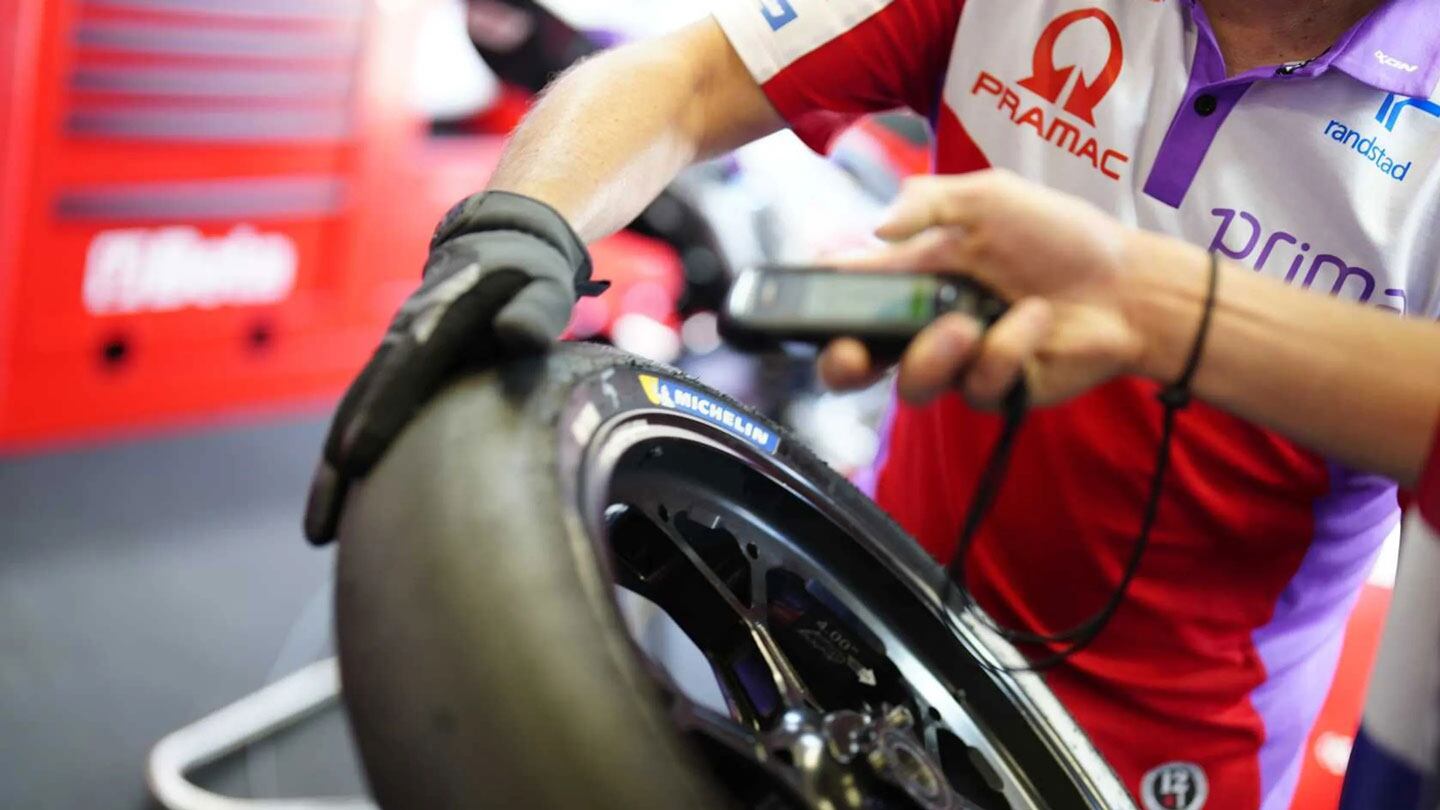

Minimum tire pressures in MotoGP are monitored during the race, and racers and teams are penalized for not adhering to the rules.
