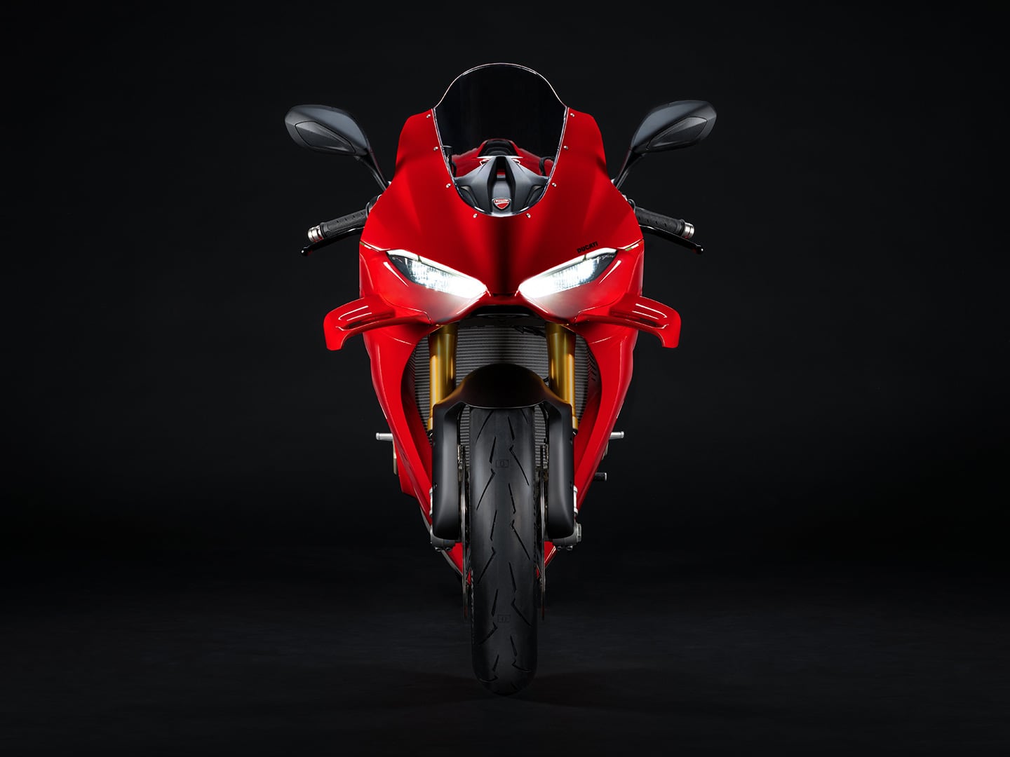

The styling of the new Panigale V4 gets some inspiration from the most iconic Ducati sportbike ever: Maestro Massimo Tamburini’s Ducati 916. The connection clearly appears in the front section with the profile of the main air intake that goes down almost vertically to leave more free space between the front wheel and the body, with a gain in visual lightness.

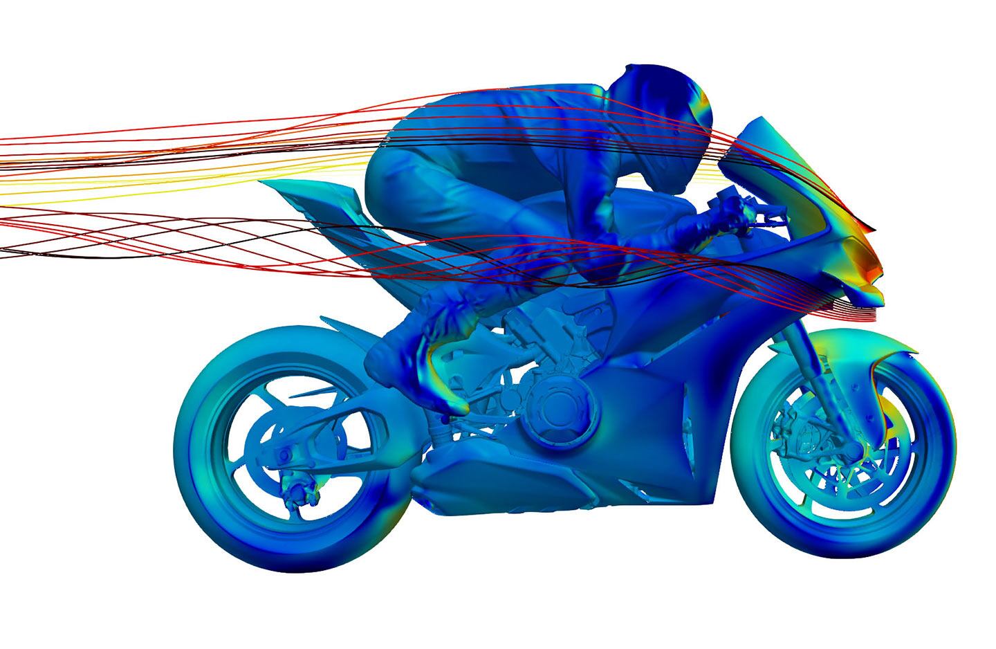

The whole body design has been refined in terms of aerodynamic efficiency, improving by 4 percent while providing more protection and comfort to the rider at high speed. The whole of the aerodynamic elements, including the double profile winglets up front, are fully integrated in the design and no longer appear as an added on aerodynamic package. The new headlight cluster was also inspired by the design of the 916, as well as the new seat and tail, that offer more room and comfort for taller riders.
Ergonomics have also been subjected to research to grant best comfort to the rider both when they are crouched tight inside the fairing at full speed, and when swinging from side to side aggressively riding on a track. Among other touches, the riding pegs have been moved inward by 10mm (0.4 inch) to induce a tighter riding position and to improve the ground clearance when cornering hard. The seat-tank assembly offers more longitudinal roominess and the 4.5-gallon tank has been shaped to offer better support to the rider’s knees. It also features a depression at the front to prevent any interference with the rider’s helmet in a tuck.
Aerodynamic efficiency has increased by 4 percent on the 2025 Panigale V4.
Aerodynamic efficiency has increased by 4 percent on the 2025 Panigale V4. (Ducati/)

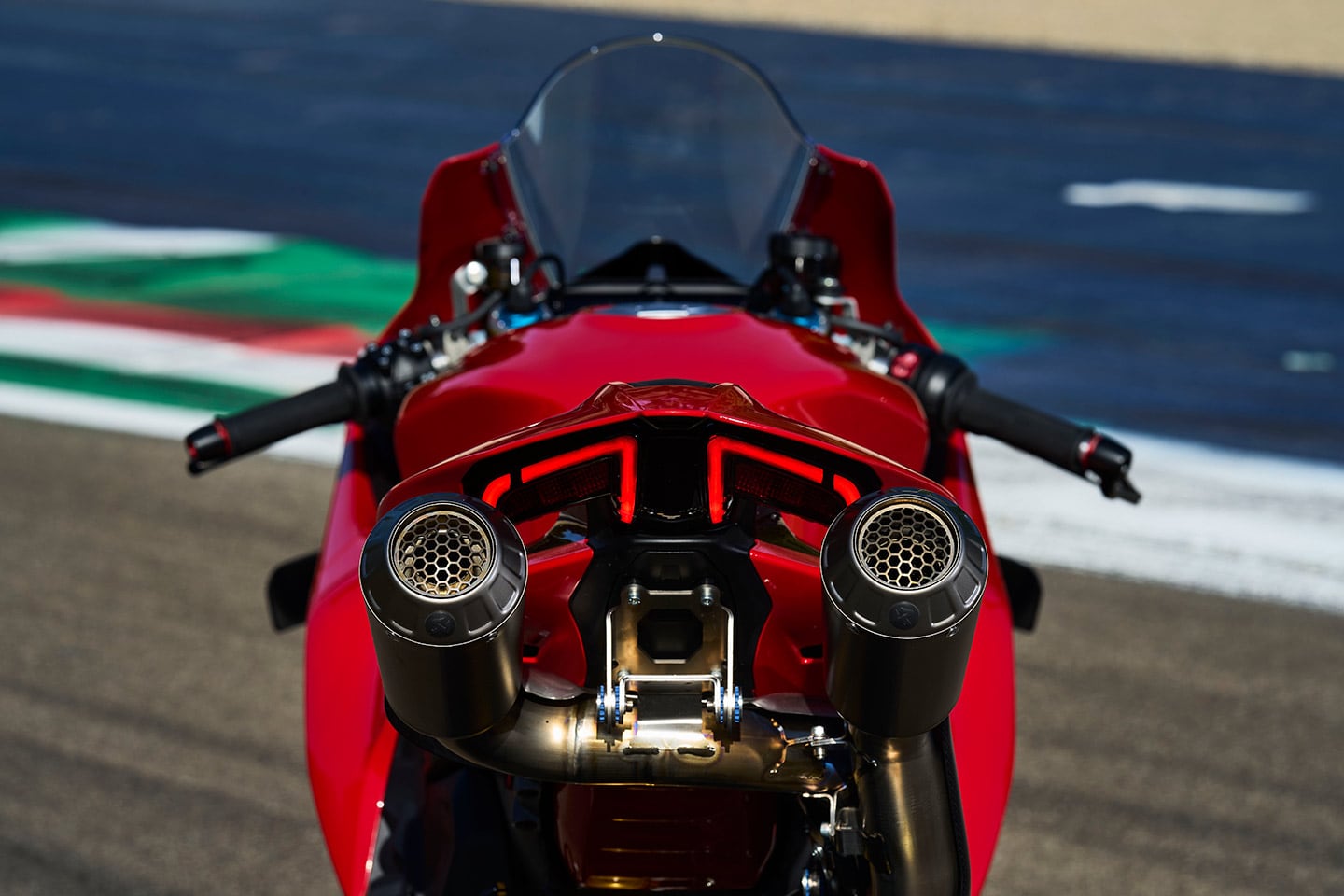

The Akrapovič accessory exhaust boosts the peak power for track use to 228 hp.
The Akrapovič accessory exhaust boosts the peak power for track use to 228 hp. (Ducati/)

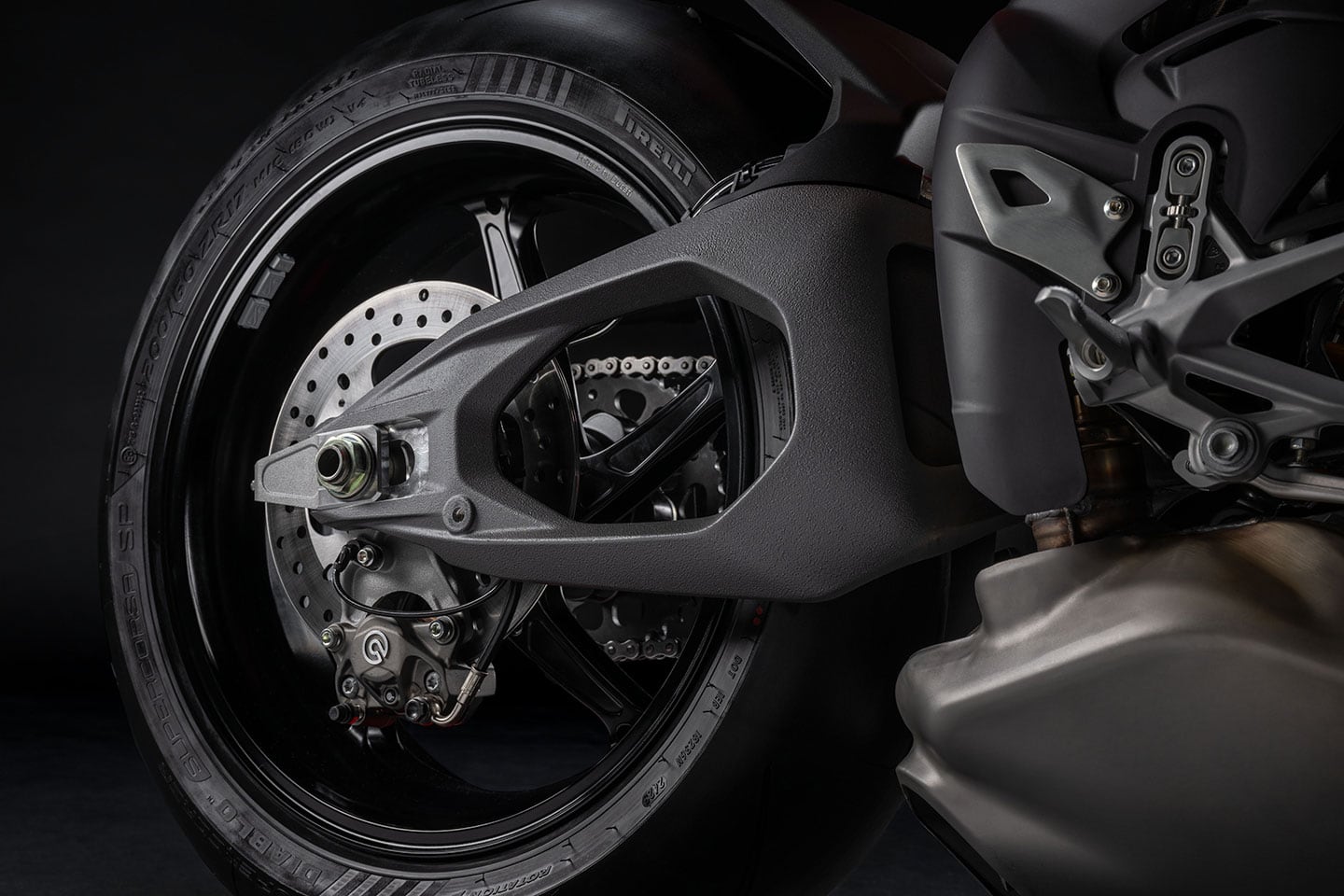

The new two-sided swingarm of the 2025 Panigale V4’s is 37 percent less rigid than the previous model.
The new two-sided swingarm of the 2025 Panigale V4’s is 37 percent less rigid than the previous model. (Ducati/)
This is contrary to all we thought in the past that would be required to make a better frame, but this new technical approach now pays big dividends. The new frame retains unchanged rigidity on the longitudinal axis to cope with the very high power and torque delivered by the engine.
To this purpose of longitudinal rigidity, the classic Ducati single side-arm rear swingarm has been replaced by a new twin-arm unit of rather unique design featuring arms formed by two arched structures called the Ducati Hollow Symmetrical Swingarm. It allows the whole exhaust system to be well tucked away under the engine. The new swingarm features a lateral rigidity 37 percent lower than that of the previous single side-arm unit.

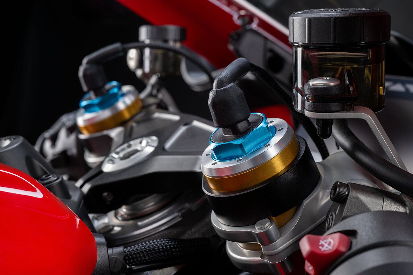

Ducati’s Panigale V4 comes in two levels of execution: the Panigale V4 and Panigale V4 S. The two are separated by some meaningful chassis components. Panigale V4 sticks to the tried-and-true 43mm Showa BPF fork and fully adjustable, gas-charged Sachs rear shock. The V4 S is equipped with a third-generation electronically controlled Öhlins NPX 30 gas-charged fork that offers a wide range of adjustmentment, both for road comfort and for track riding precision. The new Öhlins unit also features faster-responding hydraulic valves managed by Öhlins’ Smart EC 3.0. The same electronic control unit manages the rear Öhlins TTX 36 gas-charged shock absorber, also fully adjustable.
The V4 S gets electronically controlled Öhlins suspension.
The V4 S gets electronically controlled Öhlins suspension. (Ducati/)

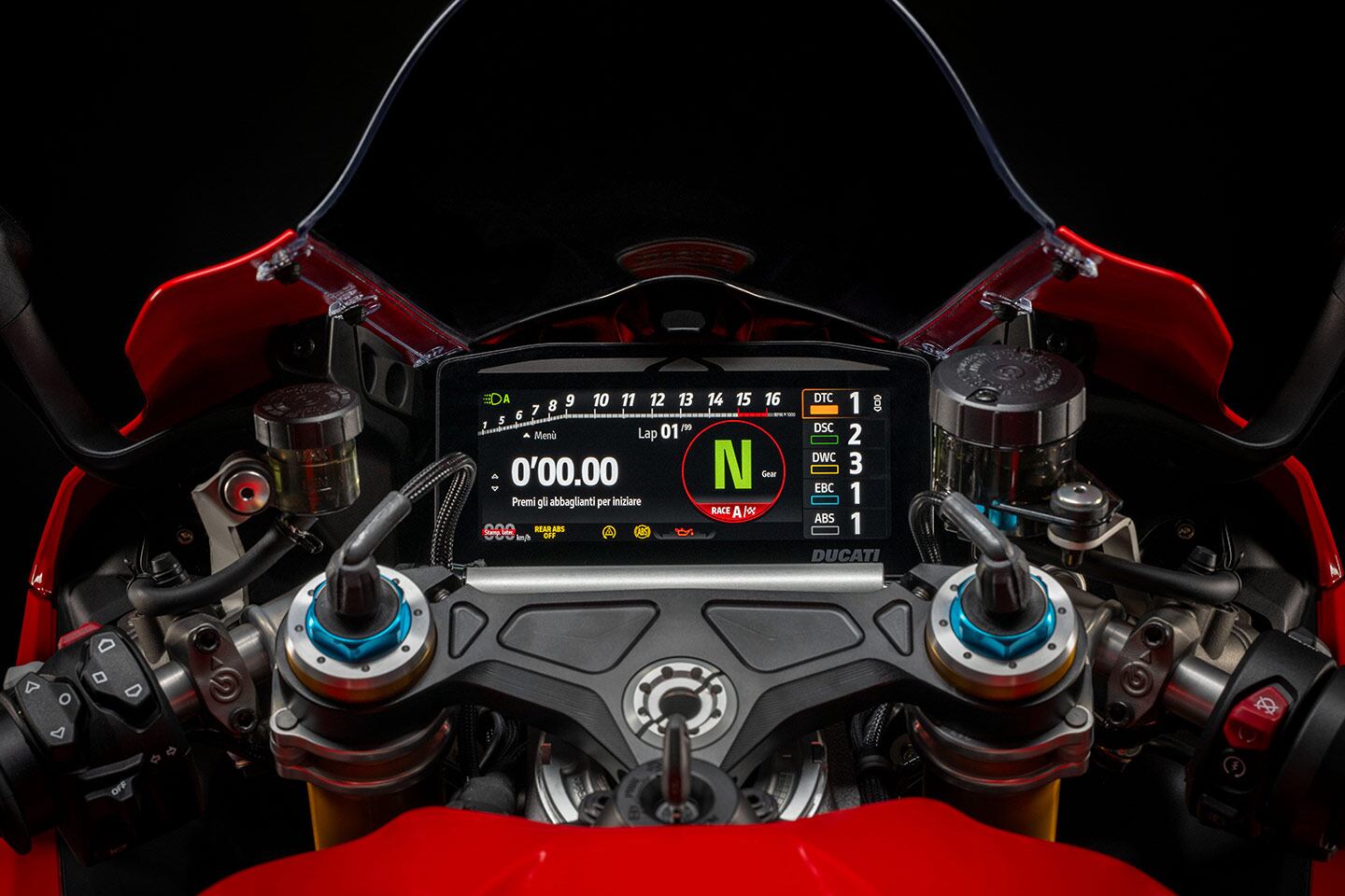

The 6.9-inch dashboard, in a 8:3 aspect ratio, offers maximum readability without interfering with the road view. There is a Road and a Track mode display. In Road mode it featured a very clear round tachometer with the indication of the selected gear at the center. On the left side of the screen settings and their different functions are displayed. On the right-hand side are the indications for speed, time, water temperature, and cruise control. When set for Track, the dashboard shows information about the personal performance of the rider, like lean angle, G-meter in acceleration and cornering, and power and torque percentage used in real time. Taking advantage of the GPS system, the dashboard displays lap times and the new DDL data acquisition completes the official rider experience.
The 2025 Ducati Panigale V4 gets a new 6.9-inch TFT dash.
The 2025 Ducati Panigale V4 gets a new 6.9-inch TFT dash. (Ducati/)
