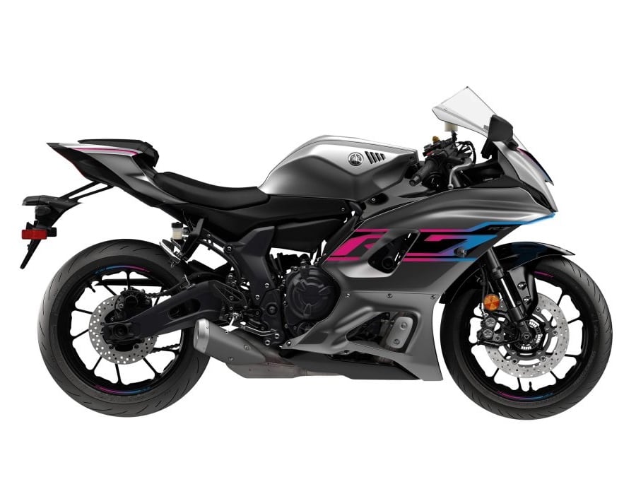

The YZF-R7 is also available in black or a Matte Gray color (shown).
The YZF-R7 is also available in black or a Matte Gray color (shown). (Yamaha/)

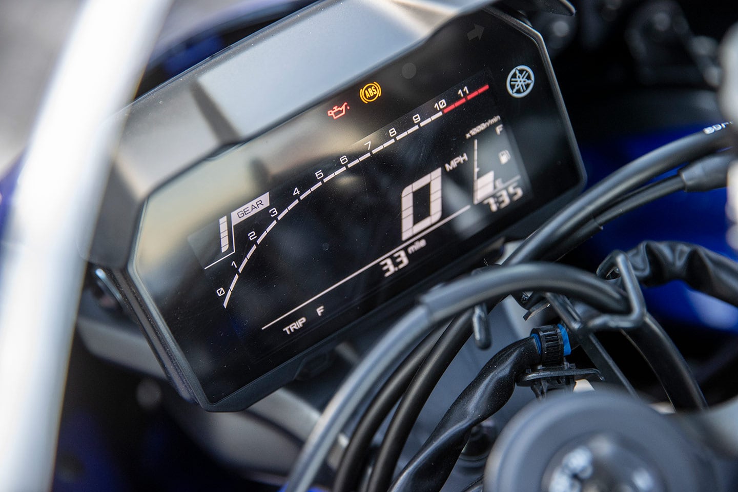

Electronics aren’t the R7’s thing. There are no ride modes or electronic rider aids, meaning there’s not much to adjust through this LCD display. The display is tucked into the front fairing and covered by a few wires, meaning it can be hard to see at times.
Electronics aren’t the R7’s thing. There are no ride modes or electronic rider aids, meaning there’s not much to adjust through this LCD display. The display is tucked into the front fairing and covered by a few wires, meaning it can be hard to see at times. (Yamaha/)
