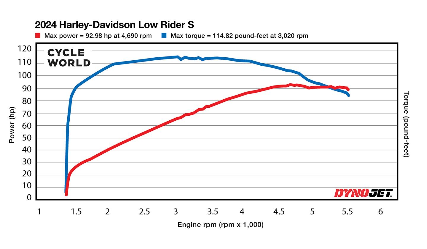

2024 Harley-Davidson Low Rider S Dyno Chart
2024 Harley-Davidson Low Rider S Dyno Chart (Robert Martin/)
Before hitting our in-house Dynojet 250i dynamometer, the Low Rider S weighed 678 pounds on our automotive scales. On the Cycle World dyno, the 2024 Harley-Davidson Low Rider S produced 93 hp at 4,690 rpm and 114.8 lb.-ft. of torque at 3,020 rpm. For reference, the 2023 Harley-Davidson Breakout 117 produced 94.3 hp and 118 lb-ft of torque. With nearly 100 lb.-ft. of torque available right off idle, the Low Rider S jumps off the line like a drag car. But the engine’s smooth character and wide range of operation make it flexible in everyday riding scenarios. The 2024 Harley-Davidson Low Rider S offers American muscle in a refined package with West Coast styling.
