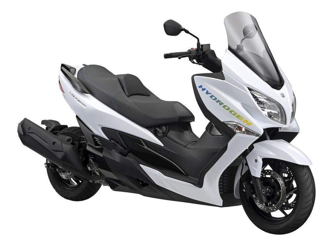

From the outside, the original prototype hydrogen-powered Burgman scooter is clearly much longer than the standard model.

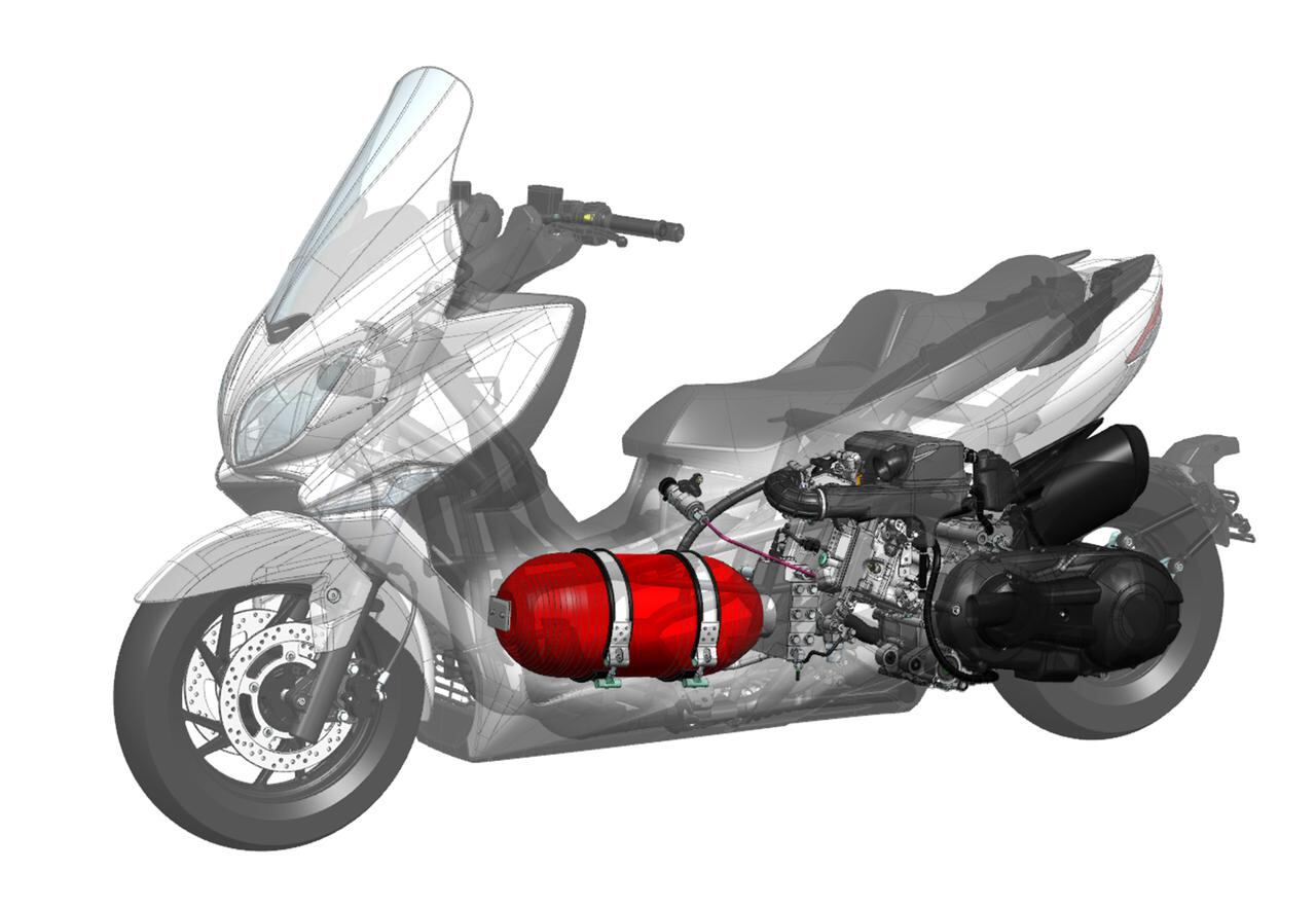

The first-gen prototype used just one large hydrogen tank, which severely limited packaging.
The first-gen prototype used just one large hydrogen tank, which severely limited packaging. (Suzuki/)
The original, running prototype for Suzuki’s hydrogen-fueled Burgman ICE scooter—which isn’t to be confused with several generations of hydrogen fuel cell electric scooters that Suzuki has made over the last decade or so—featured an extraordinarily long wheelbase as a result of its fuel system. To fit the large hydrogen cylinder low down in the bike’s chassis ahead of an engine and transmission based on the standard Burgman 400 parts, the first prototype’s wheelbase was extended by a full 8 inches by shifting the whole powertrain and swingarm backward. That’s what this new patent aims to prevent while still retaining the ability to carry a worthwhile amount of fuel.

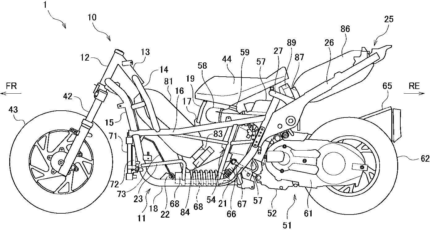

This illustration shows how Suzuki has positioned the hydrogen tanks (81 and 86) so that the scooter can use a normal Burgman wheelbase and still carry enough fuel to be practical.
This illustration shows how Suzuki has positioned the hydrogen tanks (81 and 86) so that the scooter can use a normal Burgman wheelbase and still carry enough fuel to be practical. (Suzuki/)
The solution isn’t a complicated one. Instead of a single, large hydrogen cylinder, the new design features two smaller ones. The first is, like the original prototype, in front of the engine, but to save more space it’s tilted upward at the front to entirely eliminate the wheelbase stretch of last year’s bike. That allows it to fit into a standard, unmodified Burgman 400 chassis, without requiring the engine, transmission, and swingarm to be shifted backward. A second hydrogen cylinder is then fitted in the back, under the rear section of the seat. Seen from the side it’s pitched upward at the same angle as the seat unit but looking down from above it’s skewed to one side, with the front of the cylinder toward the left of the bike, to maximize its size in the available space.

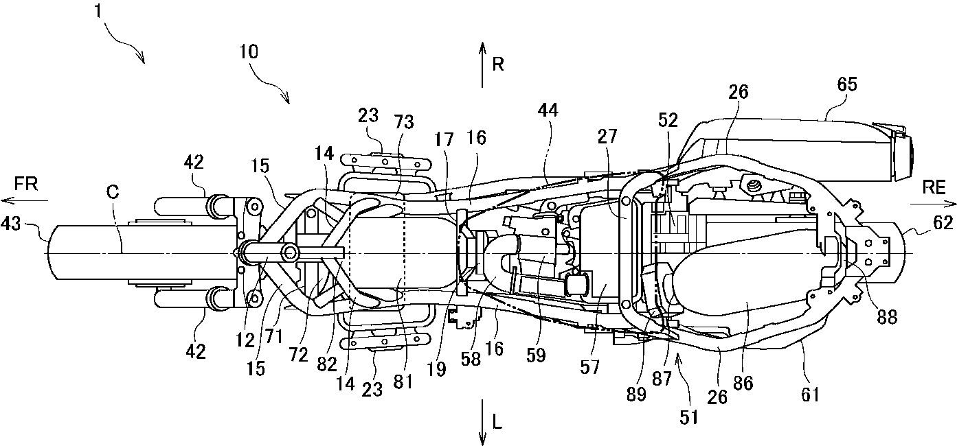

This bird’s-eye view shows how the tanks (81 and 86) are positioned.
This bird’s-eye view shows how the tanks (81 and 86) are positioned. (Suzuki/)

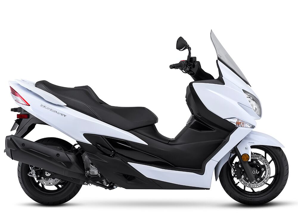

The new version of the prototype now utilizes the same wheelbase as this standard model.
The new version of the prototype now utilizes the same wheelbase as this standard model. (Courtesy of Suzuki/)
