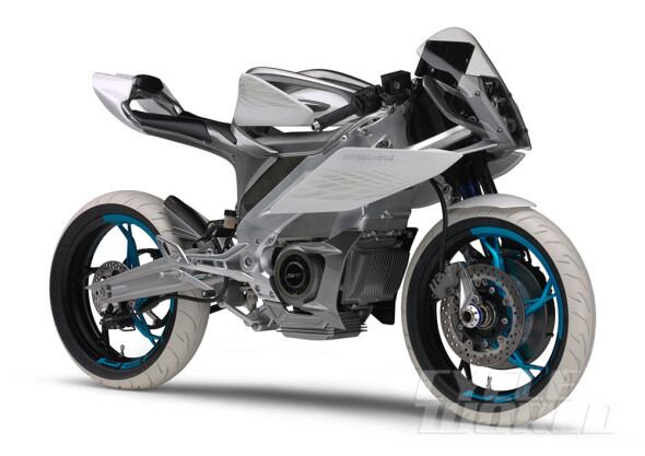

There have been plenty of false dawns when it comes to the idea of electric sportbikes from major ICE motorcycle manufacturers. There was a flurry of exciting electric concepts more than a decade ago, including Honda’s RC-E that was unveiled back in 2011, and Yamaha’s PES1 and PES2 from 2013 and 2015, respectively, but so far such machines have remained conspicuously absent from showrooms. That’s despite genuine intentions to accelerate electric-motorcycle plans. As far back as 2013, Yamaha’s official plan (published in its annual report at the end of that year) was to launch “EV sports motorcycles” inspired by the PES1 concept within two years. That document was later edited to change the two-year time frame to “in the near future” when it was clear the two-year schedule wasn’t viable, but it’s been more than a decade now and there’s still no electric sportbike in Yamaha’s range.

Yamaha showed its PES2 electric concept all the way back in 2013. <i>Yamaha</i>

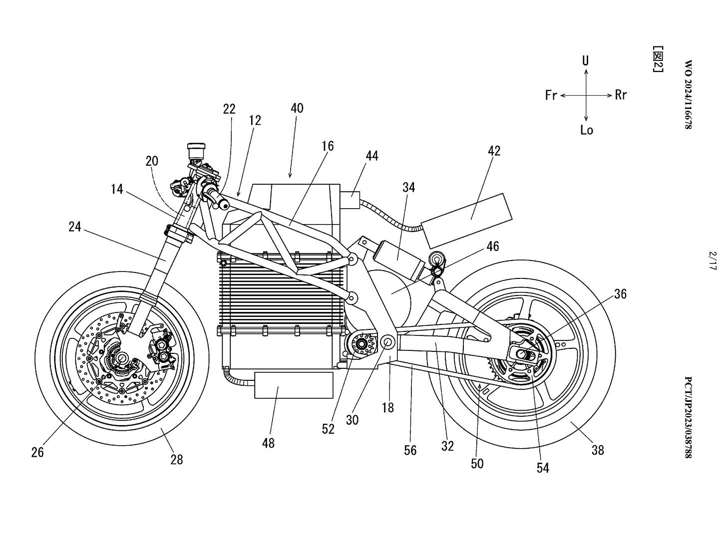

Does that mean the idea has been dropped altogether? It appears not, as a new Yamaha patent application reveals that work is underway on an electric bike that’s clearly much more focused on performance than any of the company’s existing battery-powered models.

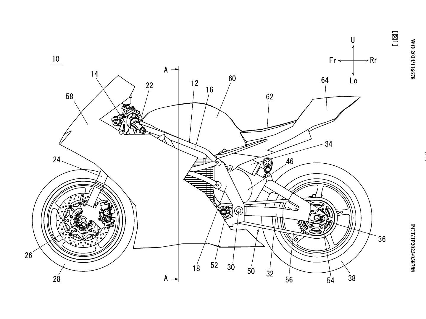

The patent shows a sportbike with a conventional-looking chassis combining a trellis-style front frame with a swingarm pivot that appears to be aluminum, but it wraps around a huge, finned case that contains batteries and electronics rather than a combustion engine. The design is clearly intended to maximize battery space, as the electric motor is mounted as far back as possible, driving the front sprocket via a reduction gearbox. The motor position means the rear suspension needs an unusually high shock unit to clear it.
This illustration shows a fully faired sportbike-style machine in the patent applications.
This illustration shows a fully faired sportbike-style machine in the patent applications. (Yamaha/)
