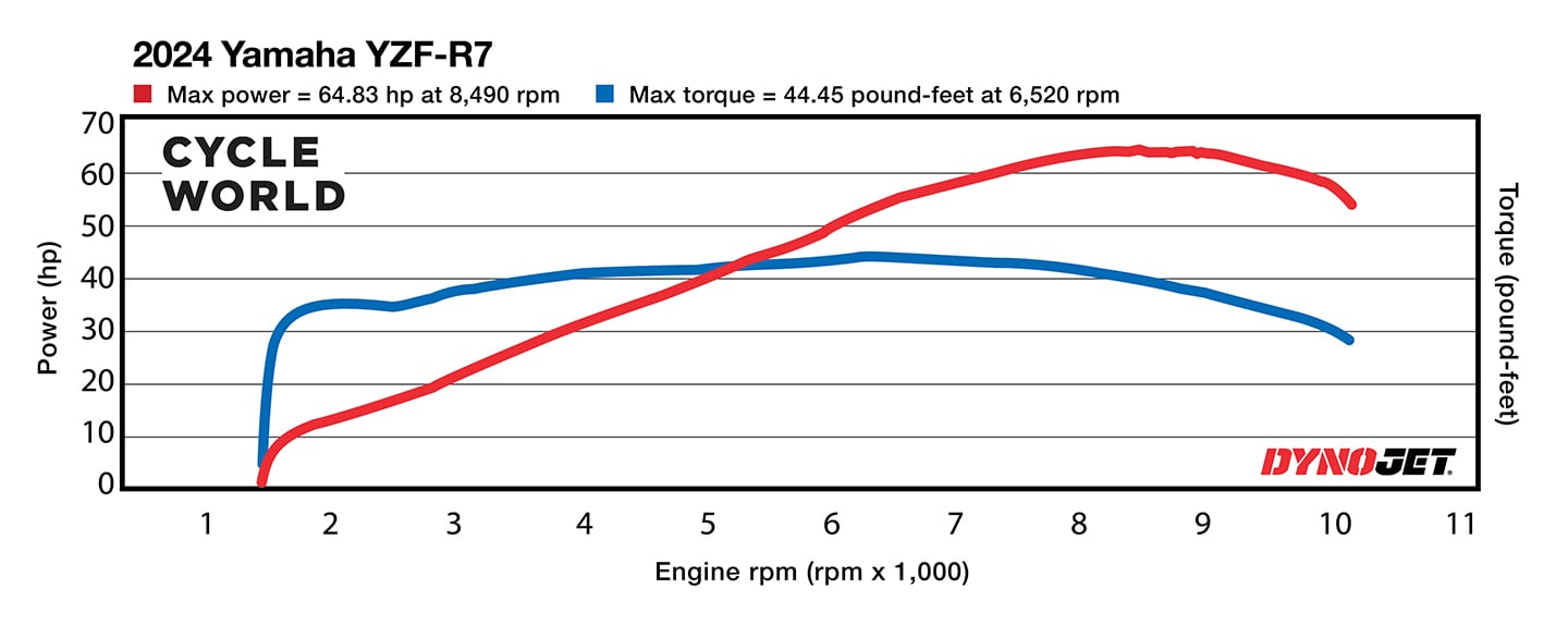

2024 Yamaha YZF-R7 Dyno Chart.
2024 Yamaha YZF-R7 Dyno Chart. (Robert Martin/)
Before hitting our Dynojet 250i dynamometer, the R7 tipped our automotive scales at 418 pounds. On the Cycle World dyno, the 2024 Yamaha YZF-R7 produced 64.8 hp at 8,490 rpm and 44.5 lb.-ft. of torque at 6,520 rpm. For reference, the 2023 Yamaha Ténéré 700 produced 61.7 hp at 9,040 rpm and 42.5 lb-ft of torque at 6,470 rpm. Although Yamaha’s CP2 engine has grown a little long in the tooth, it is still one of the most fun, playful, and charismatic engines in motorcycling. It’s a Cycle World favorite in R7, as well as the Ténéré 700, MT-07, and XSR700. The bottom-end’s torquey and tractable power delivery makes it great for popping wheelies, pulling off an apex, or squirting away from a stoplight. The Yamaha R7 may not be the fastest, most powerful bike in the class, but it’s one of the sharpest parallel-twin sportbikes.
