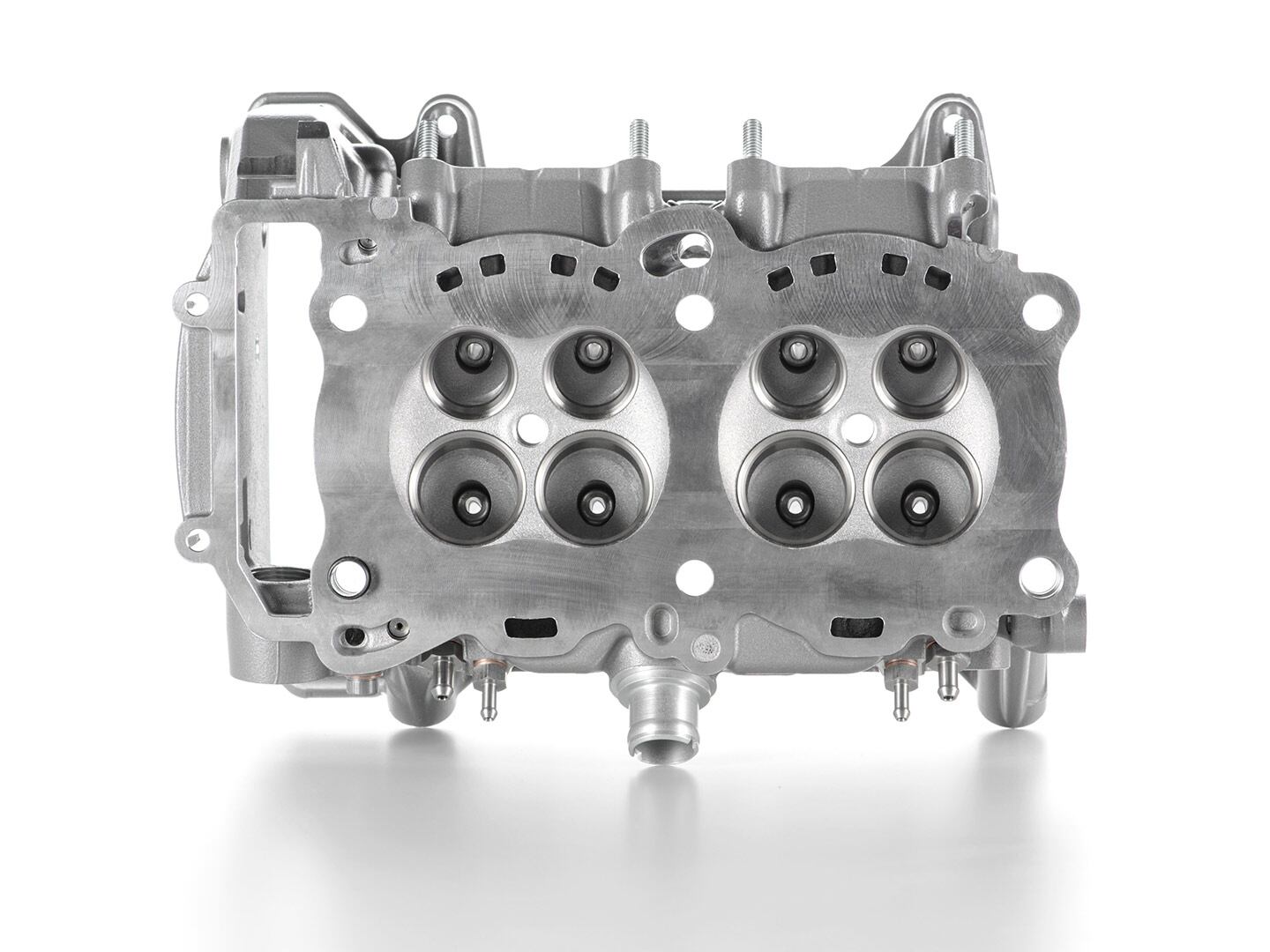

Exhaust Port Heat
But actual experiment shows that half of the cylinder head’s heat inflow is picked up through the walls of the exhaust port. How can this be? The temperature of combustion gas at peak pressure is much higher than that of gas expanded through the power stroke (giving its energy to the piston, which drives the load), then further expanded through the fast-lifting exhaust valve(s). What gives?
It turns out that conditions for heat transfer are very good at the exhaust port walls.

There’s a lot of heating happening in the short run after the exhaust valve to the pipe.
There’s a lot of heating happening in the short run after the exhaust valve to the pipe. (Ducati/)
