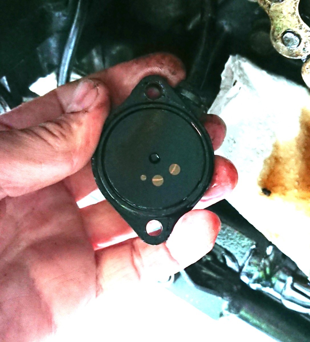

  2. Hi all, Another day another problem (but not a major one ). My neutral light doesn't work when the engine gets hot, finding a replacement seems to be tricky and expensive, so wondering if they can be refurbished, or if there is an alternative part from a newer bike that might work. I've already had it out and cleaned it, but no change. My bike is a GSX 750W from '99, the switch has 2 copper(?) contacts on it, I have seen similar with 6 contacts which I assume are for bikes with a gear indicator on the cluster and am wondering if this would work as they seem to be cheaper. Whilst I'm here, I've also got a tight spot on the chain, it's over 3 links and occurs in the same place each revolution, am I right in thinking it's the chain rather than one of the sprockets? Cheers, Peter

  8. Hi all, I noticed this recently and have also subsequently noticed that I can also start the bike without applying the clutch lever and the engine stops if I put the side stand down whilst in neutral. Initially I suspected the neutral indicator switch, which seems easy enough to replace (which I'll get round to soon), but just wondering if this switch could also be responsible for the other 2 issues as well, or whether I may have multiple problems? Whilst I didn't notice the clutch lever thing til today, I suspect all 3 issue started at the same time, so hoping there will be one fix for all. Now I've written this, I guess the answer is to replace the switch and see if the others are cured as well Cheers, Peter
